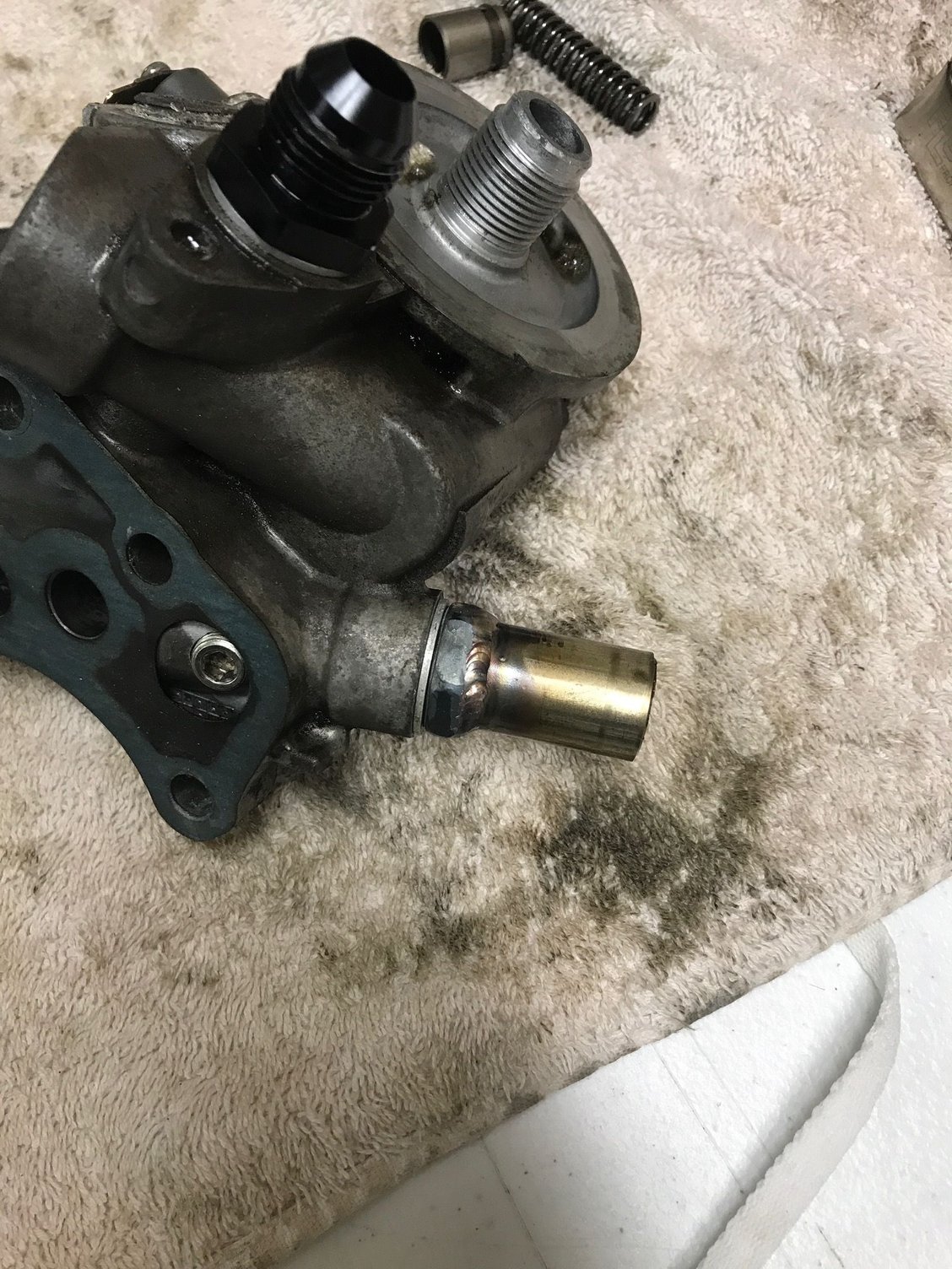

Going to do the external oil pressure regulator as done by RSMike so I have been prepping the oil filter housing. I blocked off the off the factory bypass by taping 1/8" NPT and then drilled out the oil relief spring cap and welded a short piece of stainless tubing to it. The -10AN weld on bung will arrive Wednesday and I will weld that to the other end of the tube. Ordered a new oil pan, OEM Oil pump, fresh stuby shaft & balance shaft plug, gaskets, OEM oil pressure switch, and OEM oil thermostat. I will start modifying my old pan by creating a jig so I can figure out how it needs to be modified before hacking up the new pan.
