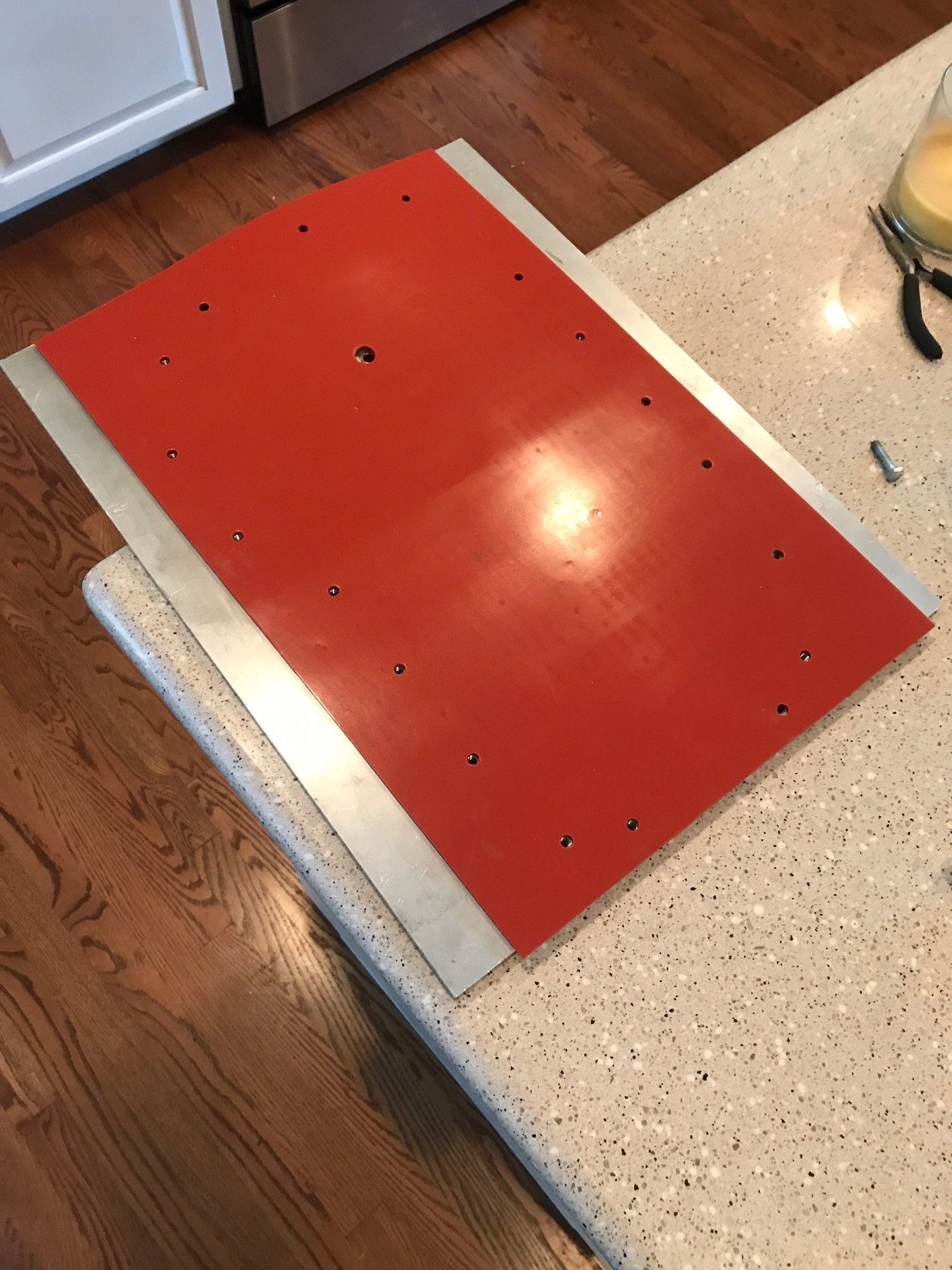

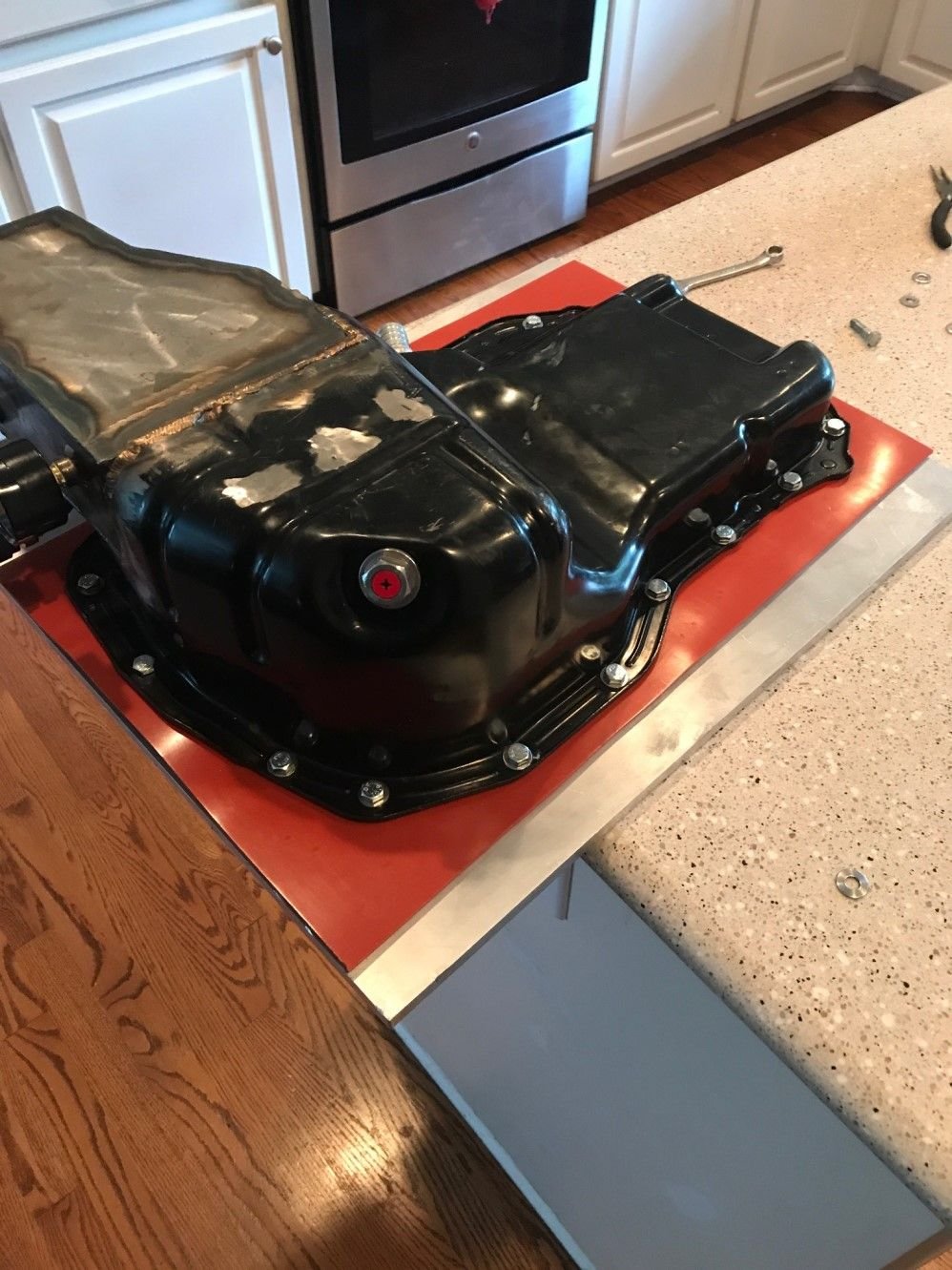

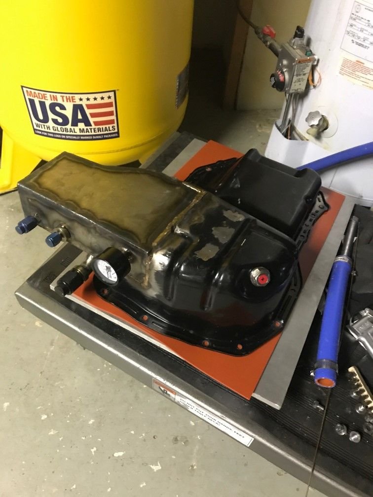

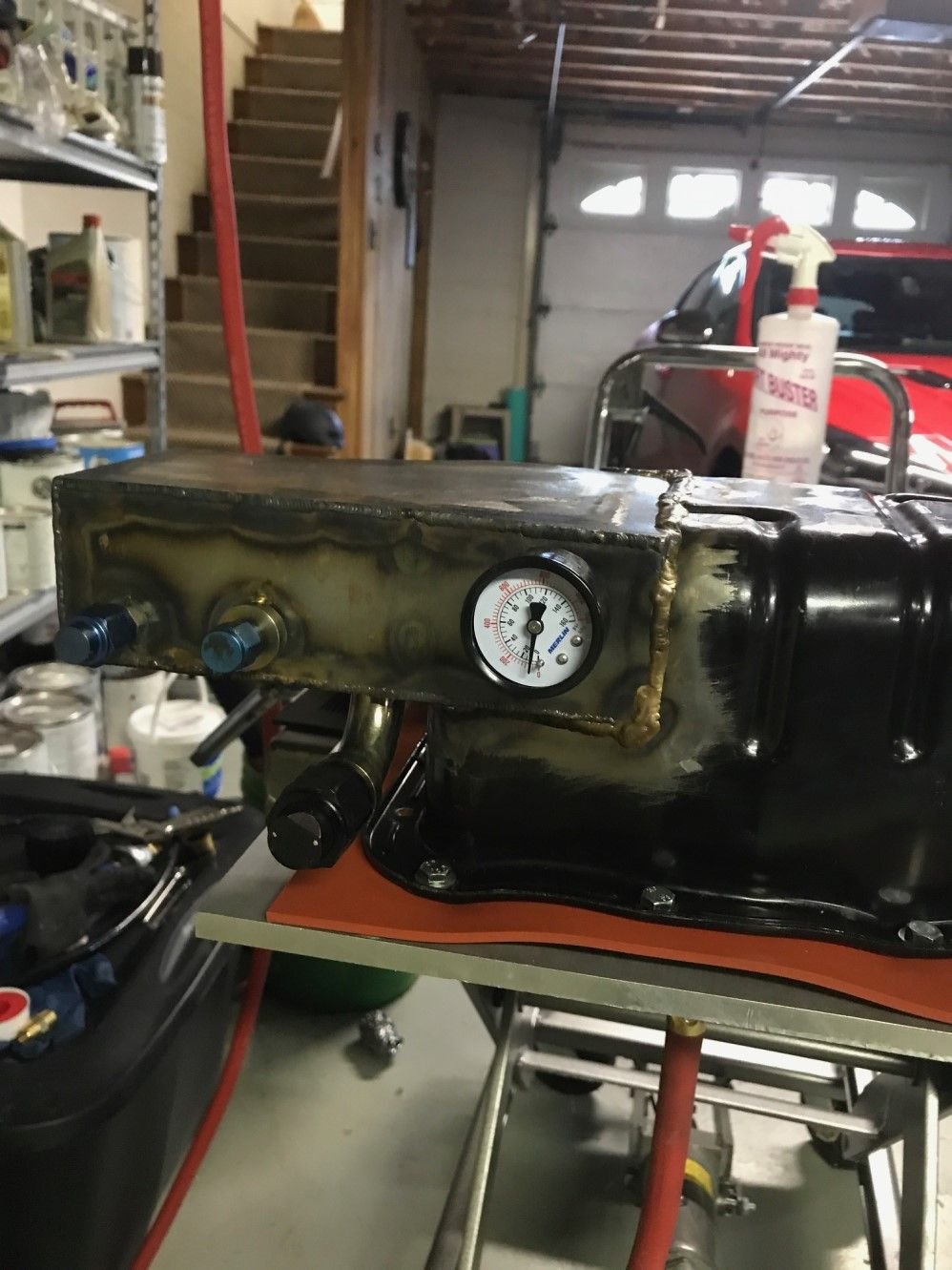

I tried to pressure test the pan using my fixture, which worked reasonably well. I secured the pan to the plate using every other screw and then I ran pressure through the pan with the regulator set to 25psi. While it was not enough to pressurize the pan, it did show me a single pinhole leak when I sprayed with soapy water, which I fixed. However, I can't take the chance of having the pan leak and then having to remove it again without damage and then weld on oil contaminated metal. Therefore, I decided to try and pressurize the pan to 5-10psi by ordering a piece of 1/8" silicon sheet to make a gasket and I will also drill/tap every single hole for the oil pan. I should have it done this weekend and start putting it back together.

From: Charlotte, NC
No leaks under pressure (8-10psi) so I can start putting it back together starting tomorrow after I paint it.

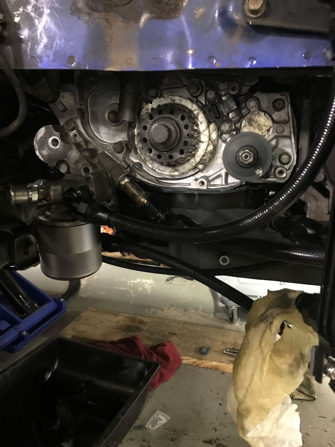

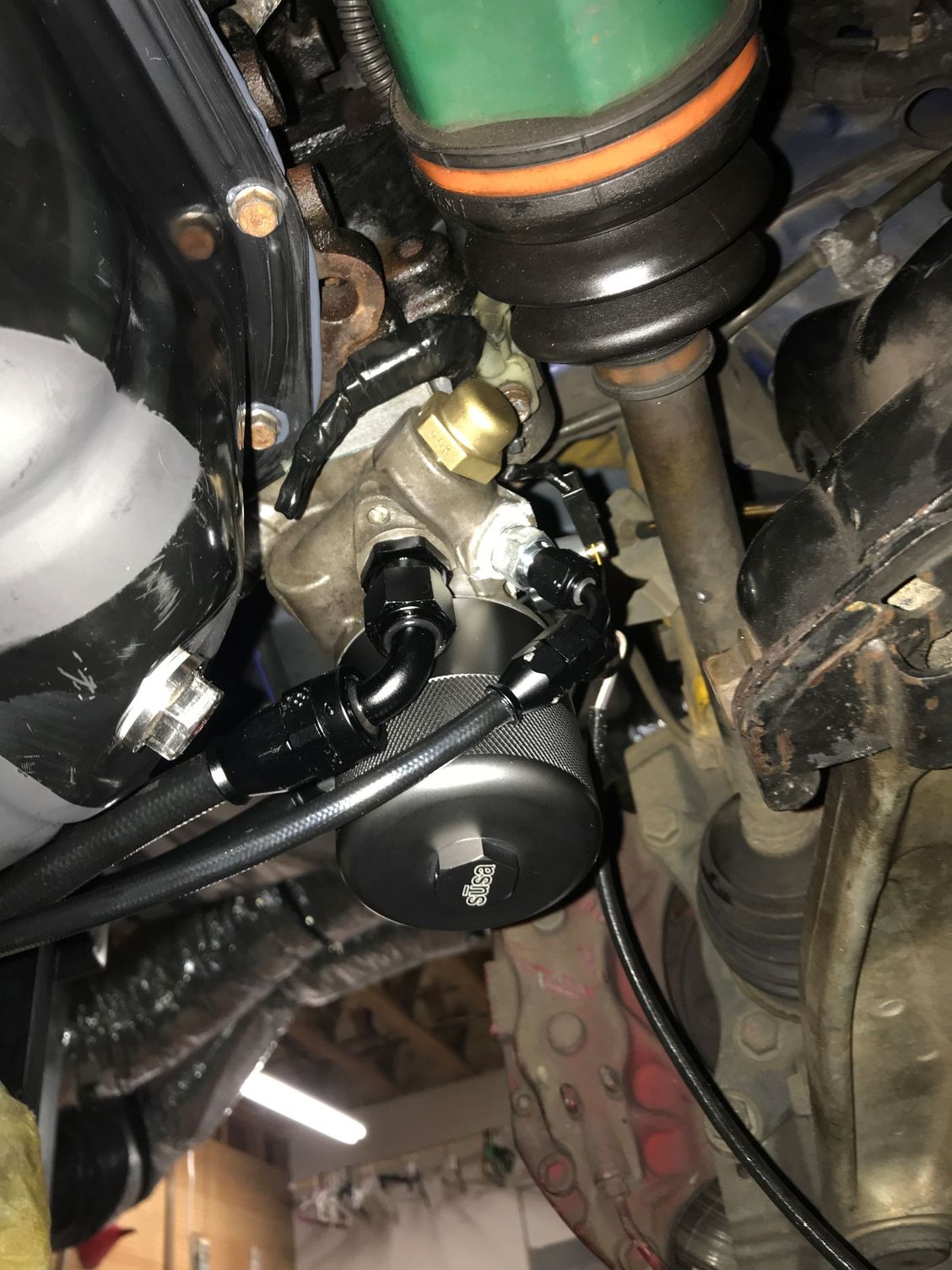

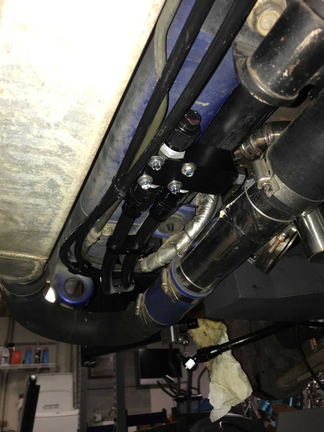

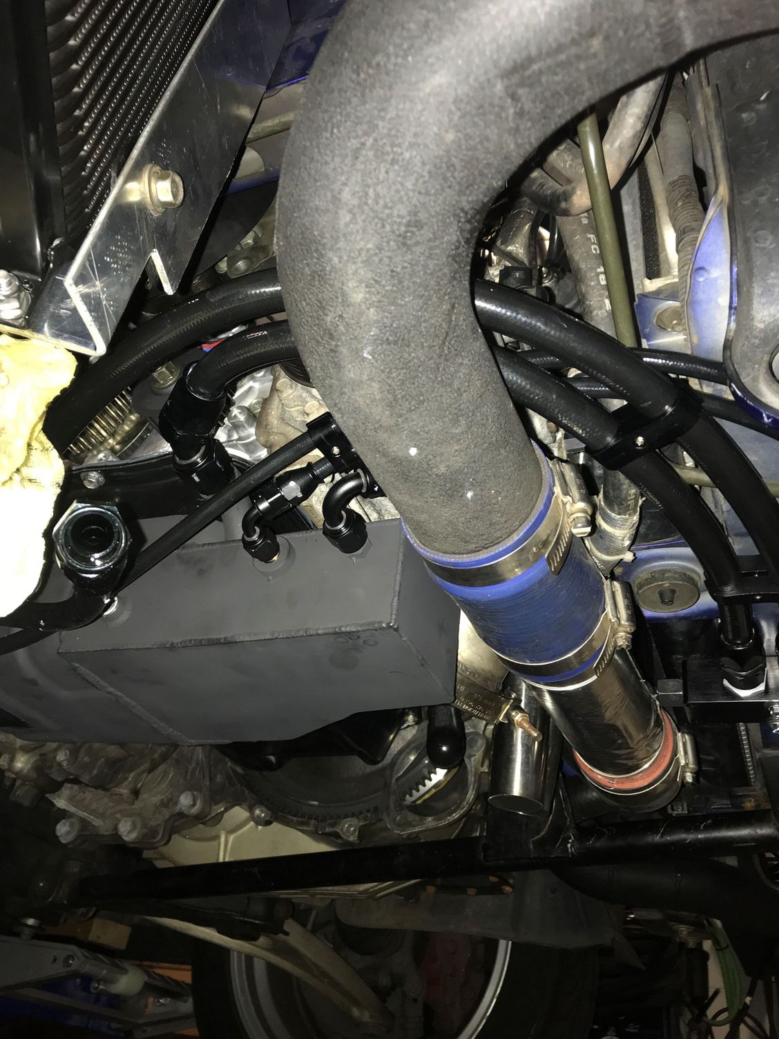

Got the pan on yesterday and I was able to finish the custom lines today. I forgot to order a new end (-8 straight) for the lower oil cooler hose where it attaches to the oil cooler so that won't arrive until later this week. I will hook it up for now and then attach my impact driver to the oil pump and got ahead and pressurize the system. I can then put the car back together while I wait for that one hose end to arrive.

I was able to add oil and then prime the pump about 5-6 times as I added more oil. As of now the system has ~7.5qts of oil and it is halfway between fuel and empty on the dipstick, which includes the oil bypass filter that holds 0.8qts. Once the oil cooler thermostat opens it will drop the oil level so I am thinking this will hold about 8.25qts when all is said and done.
I got the timing belt back on, but need to set the tension on that damn bearing before I pull the grenade pin from the tensioner. I've got to read up again on how to do that, but from memory it wasn't too bad.

That could be the case and seems logical. I'm going to run it around for a few days as is and just keep the RPM below 5K. The EA Bypass filter and the Seatrab non bypass filter can hopefully scrub the system before I go back to the conventional bypass filter. I have a new fitting I have to change on the lower oil cooler line anyway so I will swap the filter and the line at once.
