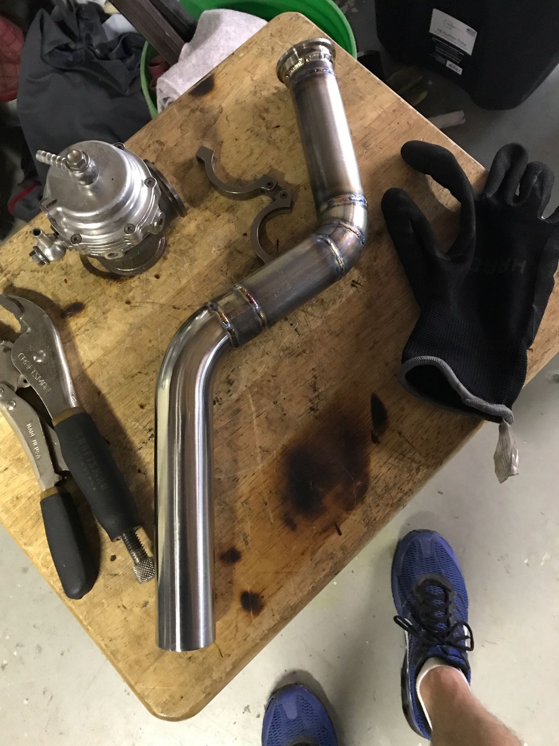

The vband flange I had machined did not arrive today so I’m kind of stuck because I need to fab the downpipe before doing the wastegate dumps.

The vband flange I had machined arrived today, but the ultra tight radius 90deg bend (0.84d) was not so "ultra" and was actually 1.06d. Damn ebay scammers! Had to reorder from original source at a higher price so it won't arrive until Friday. I will focus on mounting the Delco vacuum pump until the UTR 3" bend arrives.

The UTR 3" pipe arrived in one day! Downpipe complete (minus O2 bung) and sometimes you just get lucky when cutting the pipes!
