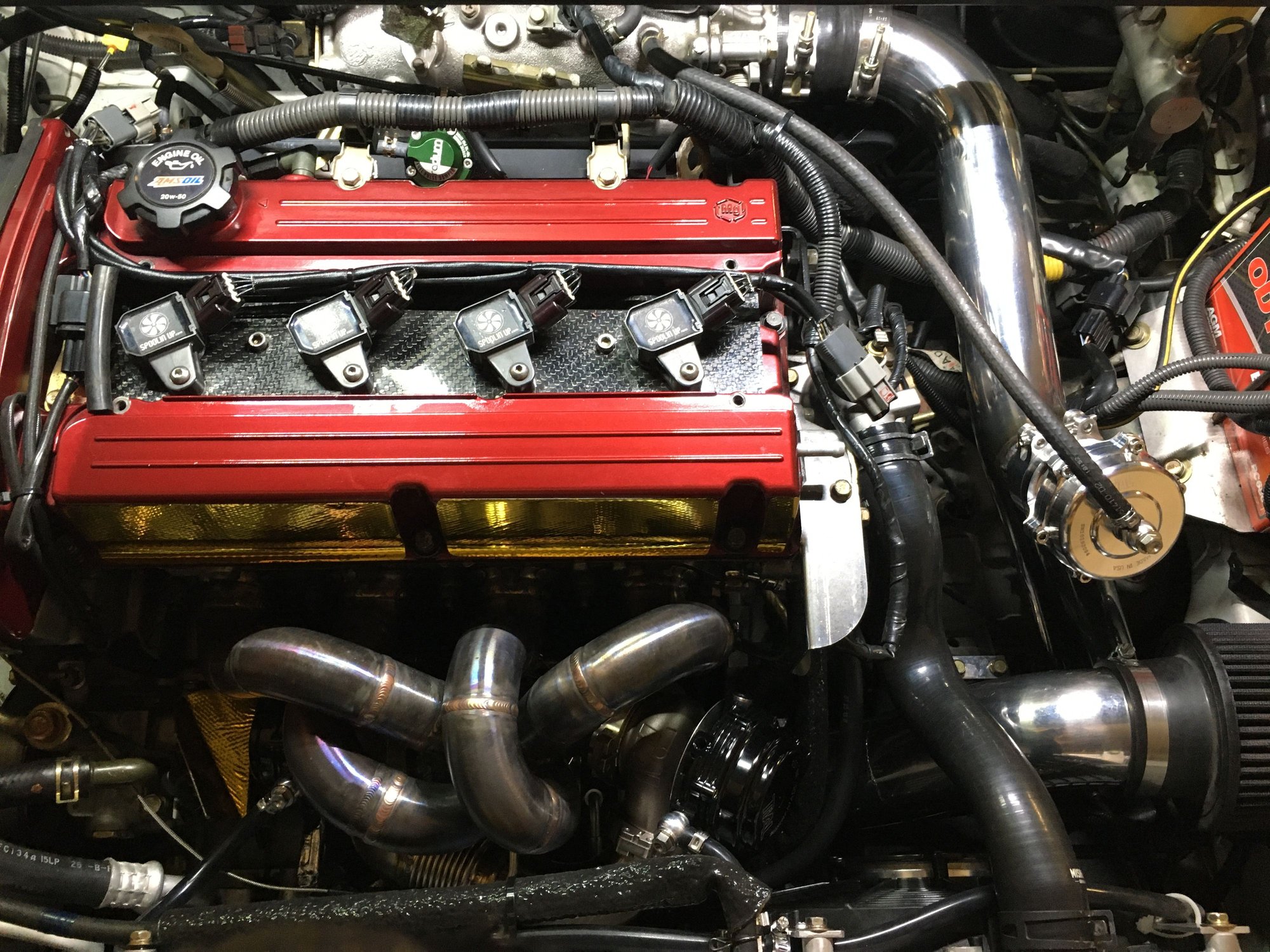

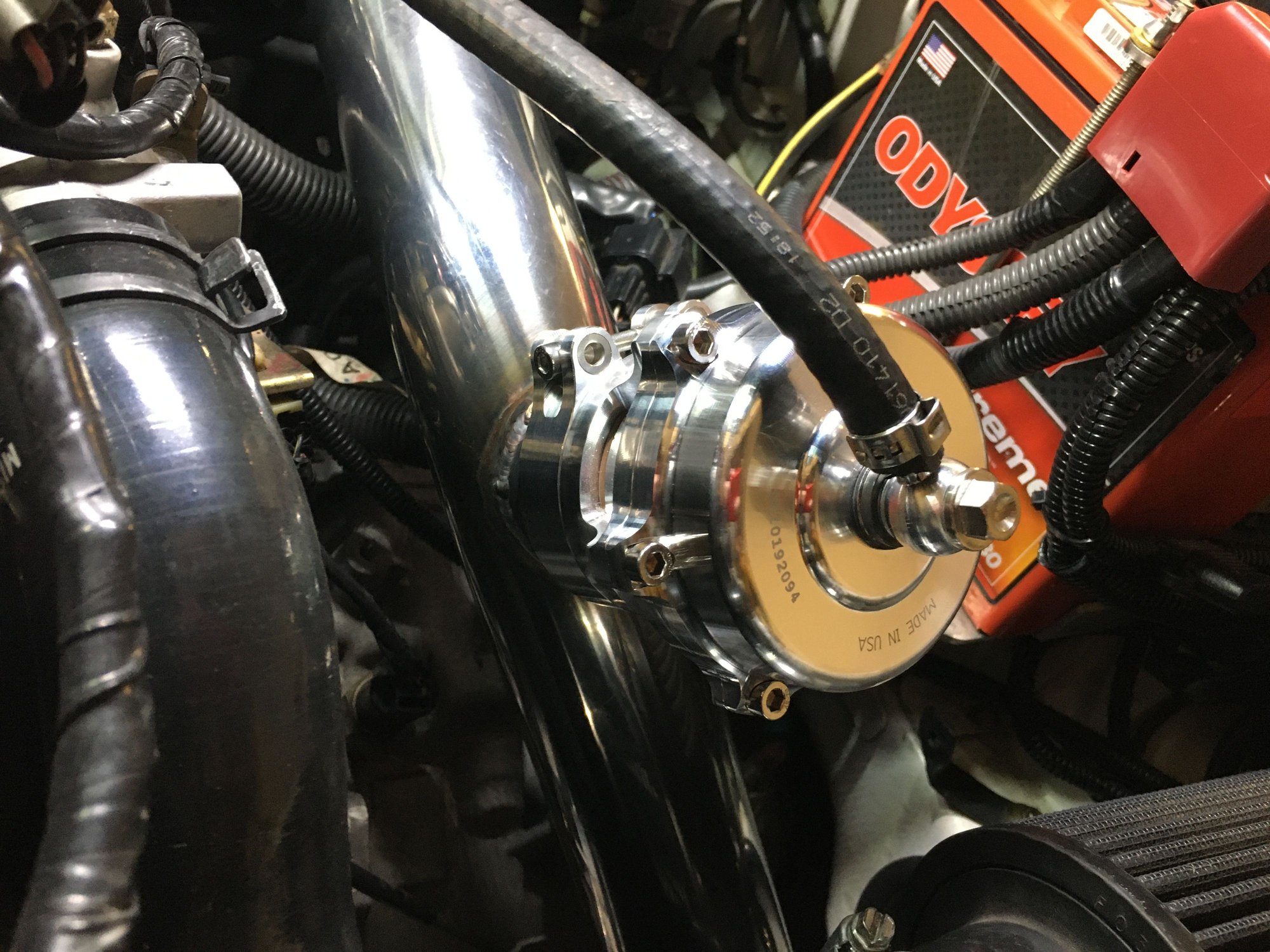

I got the flange changed in my upper pipe and installed the Tial Q. Works fantastic. Very happy with it. I used the 6 psi spring. It stays closed at idle even with the light spring.
