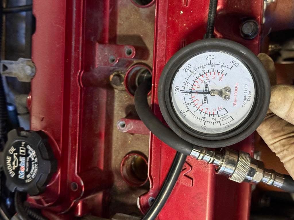

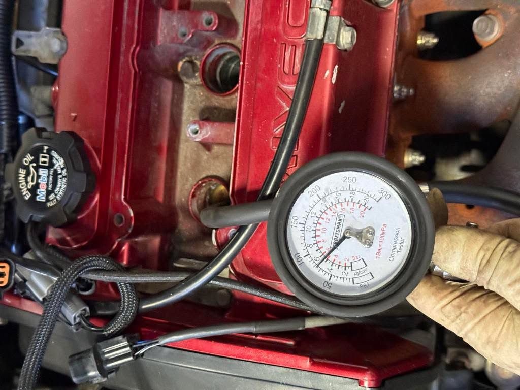

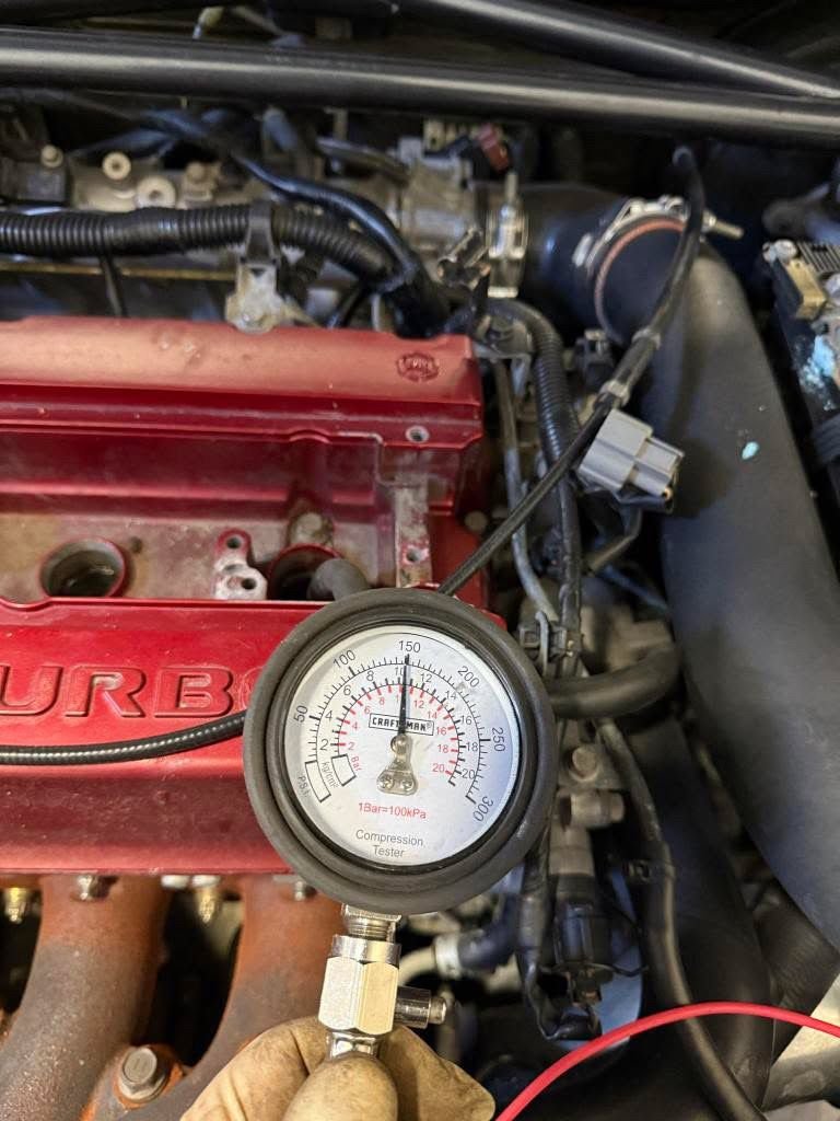

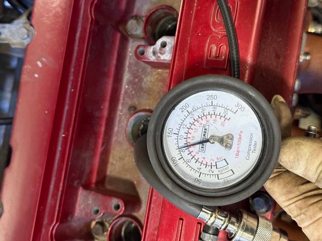

Apparently my compression is as follows:
Cylinder 1: 80PSI
Cylinder 2: 150PSI
Cylinder 3: 120PSI
Cylinder 4: 150PSI

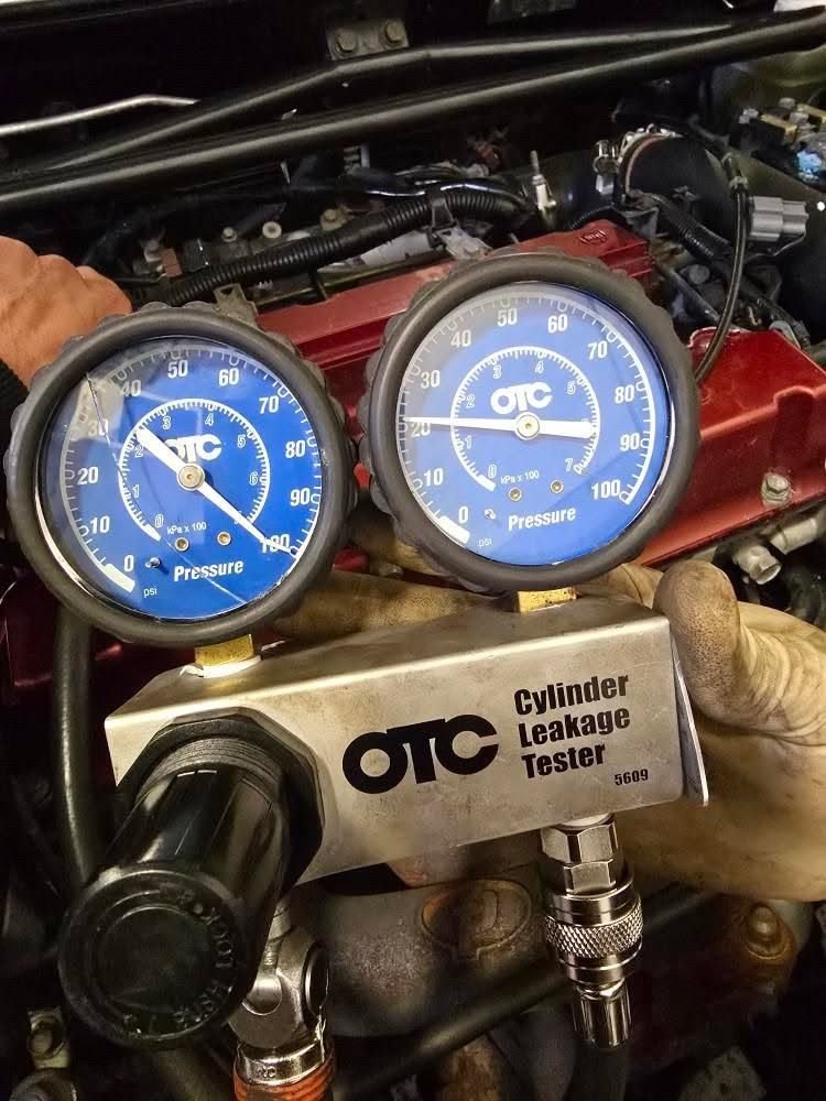

The leakdown test showed a flat 20% across the board, which is why I’m not certain how to move forward from here. To the best of my knowledge, these numbers seem off, where the leakdown of the lowest cylinder is a more significant percentage comparing to the rest. I do still need to have the compression test redone with oil added to the cylinders and double check, but when they spoke to me, they jumped straight to a full rebuild. I’m a little skeptical but not as knowledgeable.

here are the compression test results and the leakdown result from #1, being marginally the highest.

I am not going to roast you for doing what was right to begin my reply. That is bad news if you were to ask me. Leak down should be no more then 10% which with cylinders 1 and 3 being lower, I'd say there was a problem with the engine and suggest a rebuild.

a leakdown test: where the air is escaping?
If crankcase get the bottom end done.
If the leakdown is intake or exhaust, try to get a bore scope that can look backwards at the valves to see any damage or liner scratches.
