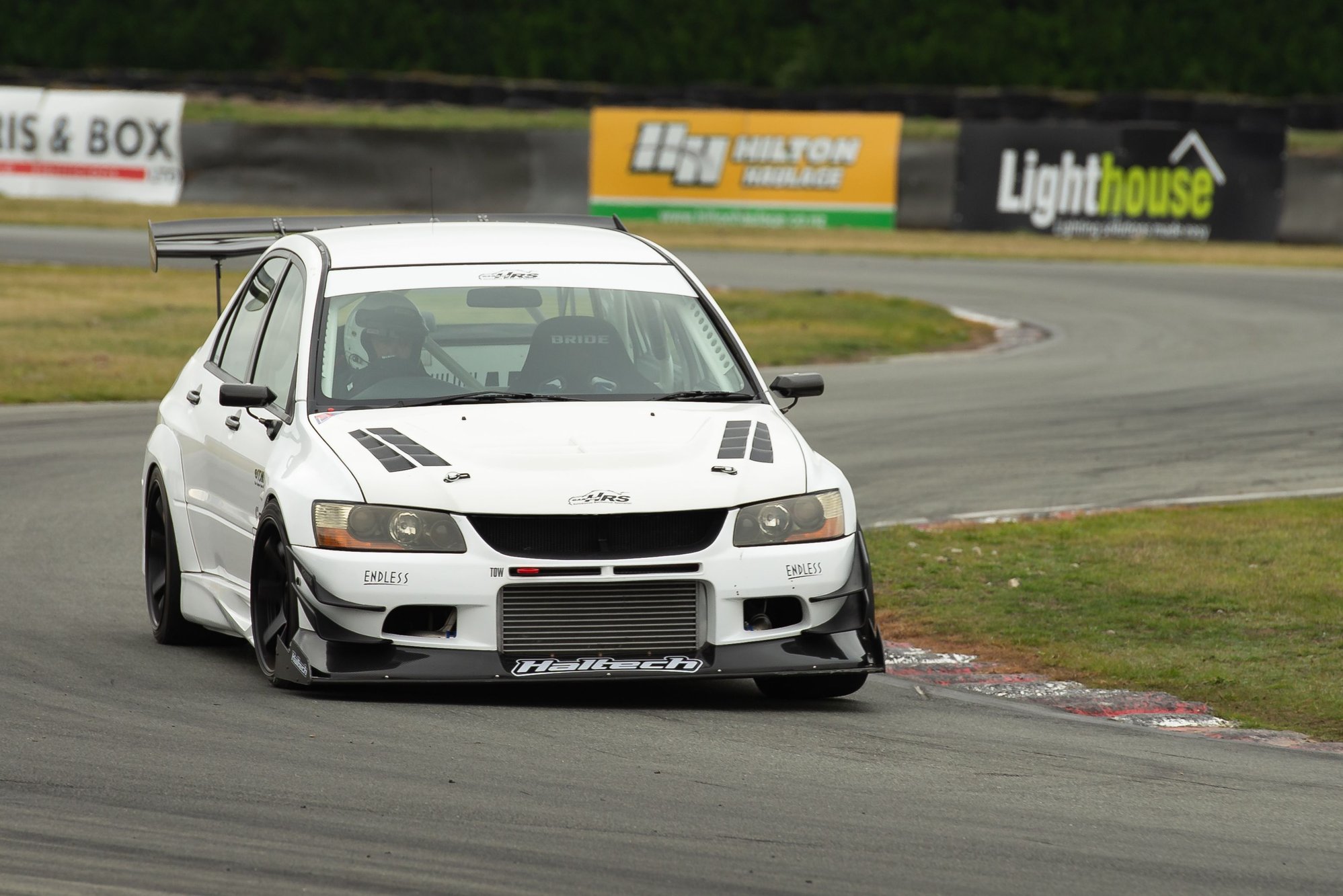

Hi there I've got a track Evo9 (Ex Garage HRS car) with a Evo8 Tomei crate engine running Tomei H11 studs,Tomei 1.2 stopper head gasket, and all the go fast bits for 450 WHP Arms 7693 turbo, 272 Poncame etc. After a couple of track sessions I noticed the water temp exceded 110 deg C. Nursing the car back to the pits water temp went back to 85 deg C and after it cooled sucked all the remaining water from the overflow tank back into the radiator that it didnt chuck out when out on the track, When cooled I added atound 1.5 Litres to top it up to where it should have been.
On idle when hot it pushes out and sucks back coolant when cooling as it should. This just seems when driven hard. Its got a big alloy race radiator which keeps it cool at around 85 Deg C when out on the track, and has always been purged of air. Oil cooler and track oil temps of no more than 120 deg C
Car has a new water pump, coolant lines and runs water wetter with de mineralised water, and radiator is shrouded and cooling fan works fine with a 1.3 bar radiator cap
Thermostat opens at 92 deg C.
No water in oil or oil in water, no steam and car idles and runs fine.
Compression 170 PSI +- 5 PSI across all cylinders when hot and throttle open.
Thoughts and reccommendations?
Thanks for reading :-)
