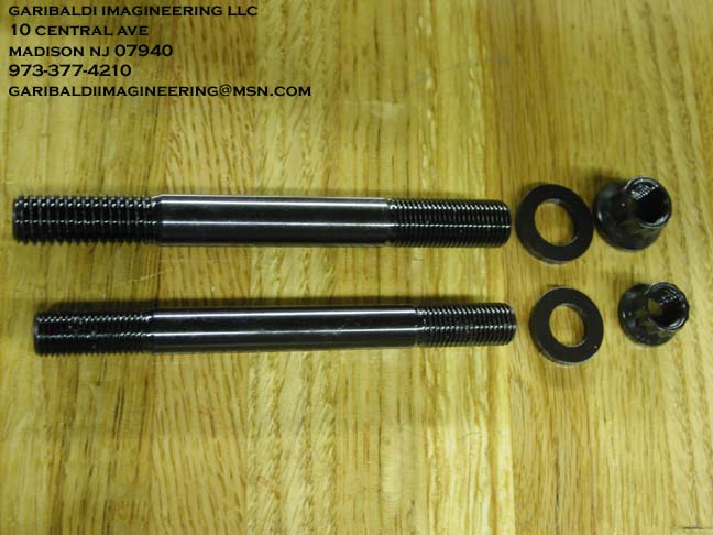

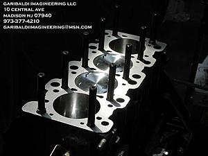

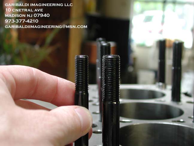

this may help clarify what you are looking at in the picture. This should hold the head and the gasket a teensey weensey bit better.
Attached Thumbnails Got Headstuds?-evodeckstud3.jpg   Got Headstuds?-evodeckstud2.jpg

Money wise, or time wise? Actually the studs are really not much more than the std ARP studs for the EVO head. The only catch is that the motor has to be apart to do the mod. The head has to be opened up to fit the studs, the head gasket has to be opened up to fit the studs, and the block has to be dialed in, drilled, counterbored and tapped to fit the studs and insure that they are straight and that everything will line up when it comes time to put it back together. Ohterwise it looks like a porcupine. I also spot faced and dropped the head nut washer seats to make sure that there was 100% surface contact. There is no way to safely do this type of work with the motor in the car, you cant risk having the iron chips getting down in the engine. and the head must be off. I just was sharing with you guys what I was doing. Not saying that this is necessary for everyone. But if you are running big loads, this will certainly help. Bottom line, if you spit the head off or the gasket out with those pulled up tight, then I dont know what to tell you.

Wow, those are thick

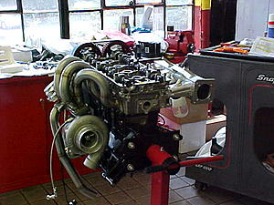

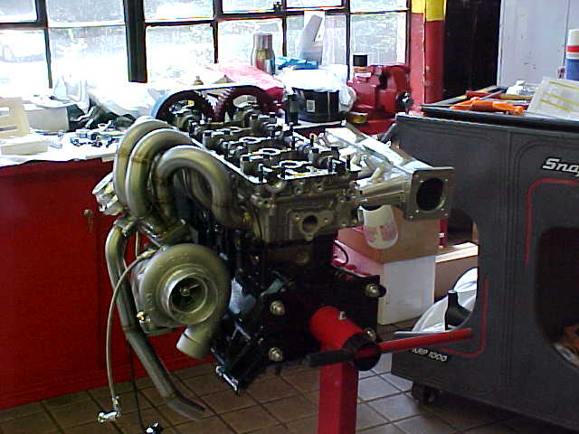

Could ya get any smaller of a turbo??

That turbo is a no joke it can swallow any small creature that come close including your arm .
