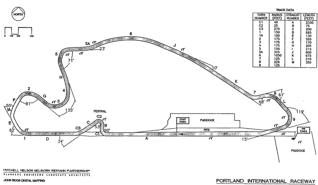

I live in Portland where it rains all the time, but I'm talking about track days. At the end of the front straight at PIR there is this chicane 90 degree right then about 120 degree left (like a U-turn) and coming out of that left, my left wheel is squeeling, i'm off/on the throttle trying to get the jump out of there, and it feels like i'm just stuck in quicksand. It's frustrating.
sounds like your getting on the boost too early past the apex. A front LSD will only make your problem worse.
Changing your driving habits is far cheaper than your dream of S-AYC
[edit]
From your description it also sounds like your not braking hard enough for the hairpin. Hell dude, you probably have better brakes than the guy your passing. If you enter the hairpin at a slower speed, then you will have a lesser tendency to understeer leaving the corner, you know, in slow out fast
I appreciate your advice, but I've tried every line through there I could possibly imagine. The best way to deal with it is to swing way wide and slow, flip a *****, then punch it after I'm pointing straight again. This is not really what I would like to do, because I feel like I'm doing parking lot maneuvers I fail to see how a front LSD wouldn't help my inside front tire from hanging in the air and spinning while my outside front tire just sits there and all the while I'm simply being pushed straight by the rear tires instead of accelerating out in the direction I'm pointing. I also fail to see how accelerating the outside rear tire (AYC) wouldn't help rotate my car as per the 3rd step in the diagram posted previously.
EDIT: I'm talking about the first and second turns after the straight (running clockwise, starting from the straight on the bottom)

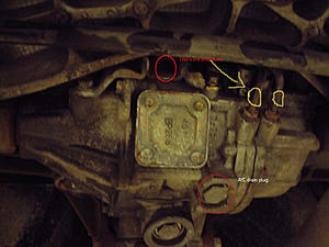

machron1 I am going to tell you everything I know about MY AYC. I dont know about the S-AYC but it could be better. The pic I posted is of an AYC equiped Evo. If anyone has ever changed their own TC oil this will look familiar with the exception of a few things.
The circles in yellow are for the AYC "Hydraulic Fluid" Someone correct me if I am wrong this fluid actually "works" the clutch plates. Somewhat like the hydraulic fluid on your brakes. The fluid needs to be changed with the MUT-II tool from Mitsu. It cycles the plates and flushes the air and fluid out. It it rumored that one could change this manually but lifting the car, draining the oil, turning the front wheels, and some other stuff. Some people have done it, but I dont know if they were successful. Mitsu doesnt even make the fluid anymore (I dont think). Some of the guys in the UK are using power-steering fluid (I think).
The circles in red are the TC mechanism. This the the part that uses ATF-SPIII. Without a pump this stuff is extremelly messy to change. It should be changed about every 3-10k miles. Or it will let you know when it is time to be changed. During quick transition driving the diff will give out a real loud moan or whine. It will sound similar to a Donkey or drunk elephant in you trunk. But once you flush the oil it will be fine.
The other drain plug is for the actual gears. It takes 75w90 oil.
Changing the TC and gearbox is a simple as changing the oil on your car. Simple drop and fill. In my Evo 6 I use Royal Purple ATF oil for the TC and 75w85 oil for tranny and gear boxes. I have about 1500 miles on my car with this set up. The car runs excellently with over 50k original miles. I havent got around to changing the AYC hydraulic fluid yet but everything is fine for now. My ayc light came on once and I took the car in for a wheel allignment and everything is ok for now.
This is all I know about the system and if anyone finds my info to be incorrect let me know so we can get this subject right. Also the UK Evo site is best place to learn from....its where I got all my info.
