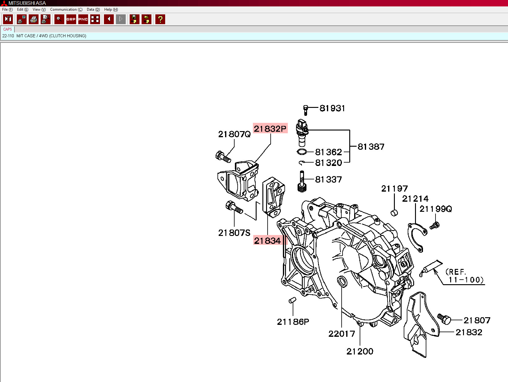

Ok i see now the parts needed...
but you are right the illustration is wrong.. if it says M/T CASE / 4WD but the illustration is wrong... am i still getting the right part? I can't seem to find the correct illustration.

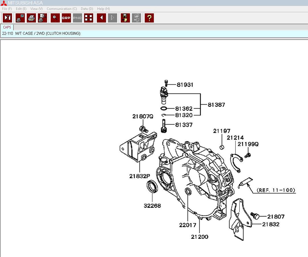

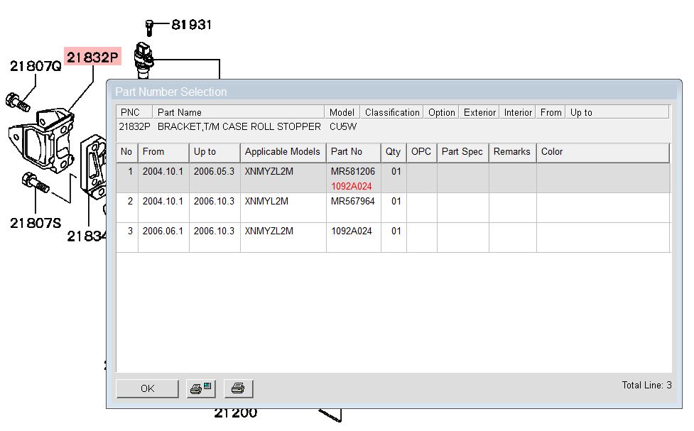

Not sure what exactly you're saying but the 2wd and 4wd mounts are different.. I'm assuming you want the 4wd stuff so you'd need the mount an adapter plate..
as you can see here the 2wd mount part # is MR567964
where as the 4wd part # is 1092A024

im getting MN168669 and 1092A024 as the parts i need - look correct?

yessir

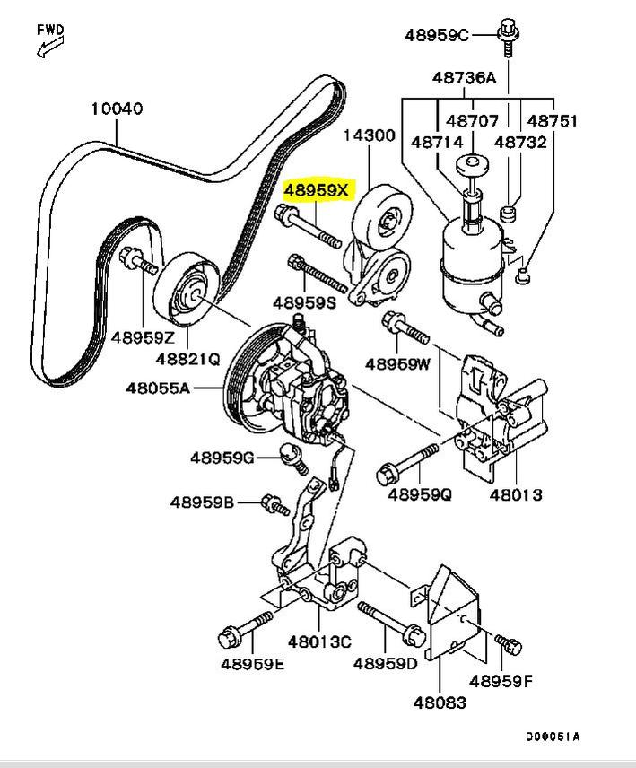

I meant to type Serp Belt Tensioner, fixed my post
The long bolt that goes through the middle 14mm head on it

md374022

Thank You Sir. Much appreciated
