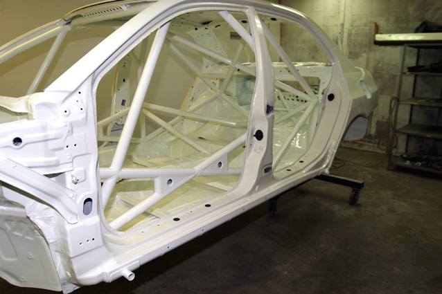

What would be really nice is to have jack points welded onto the side rails like they do on rally cars.
