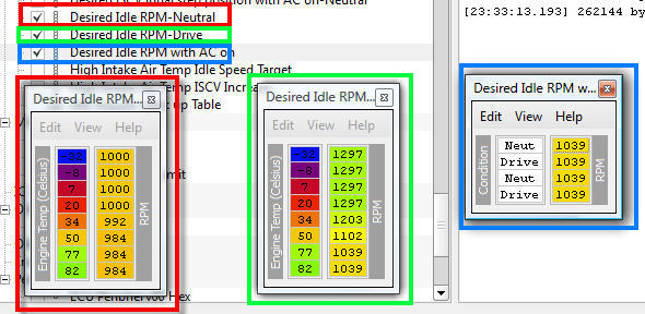

OK guys,
First off you have to fix your idle to do this you have to do the following:
First warm the car up to operating temperature. Once up to temp put the car into SAS mode (in EVOScan down at the bottom right), set idle to 800 + or - 50 RPM by adjusting the BISS screw on the throttle body (screw right on the top of the TB just use a regular screwdriver to adjust). Make sure you get your idle to settle right around 800. Once set take vehicle out of SAS mode (uncheck EVOScan button) and let the idle come down (takes about 5-10 minutes). Once the idle settles you should be good to go and your idle is "synced" with your computer.
Once you get your idle working you have to bump up your idle in EVOScan. I attached the three maps you need to edit. I adjusted my idle to right around 1000 RPM and 1100 RPM with A/C on. You guys do whatever you need for your car to idle smooth.
YOU DO NOT NEED TO TOUCH THE ISCV INITIAL STEPS MAPS AT ALL THAT WILL JUST MAKE THINGS WORSE!
Hope that helps, sorry for the long time to reply. I have been busy working on v7 with Tephra.
~Zach
Attached Thumbnails A/C makes car almost stall sometimes-ss01.jpg

excellent, thank you Zach.
did exactly as you said....will drive for a few days and report back.
thank you.
