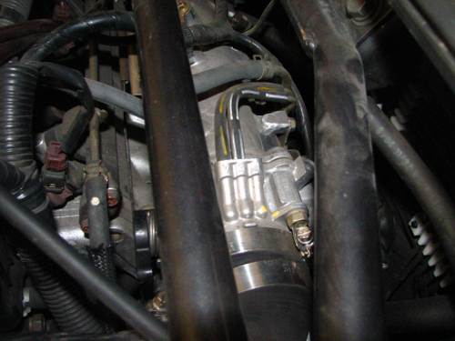

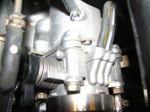

I am having a similar issue.
I would like to try to adjust the idle screw in SAS mode.
But I can't seem to find the screw.
Can someone help me find the screw?
Attached Thumbnails A/C makes car almost stall sometimes-img1.jpg   A/C makes car almost stall sometimes-img2.jpg   A/C makes car almost stall sometimes-img3.jpg   A/C makes car almost stall sometimes-img4.jpg   A/C makes car almost stall sometimes-img5.jpg

my04s2k's Avatar
Joined: Dec 2005
Posts: 93
From: Charleston SC
its in image 2 by the tb bolt. i had to use a philips bit out of a screw driver and reach behind the strut bar and make adjustments when the car was on.
