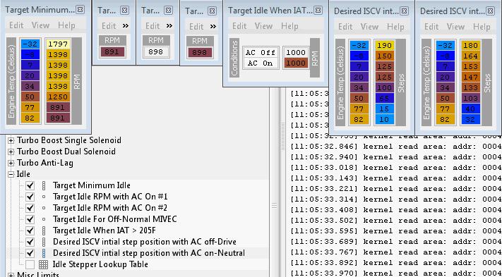

but my ECU FLASH version look a little different than yours
here is my
could u help me out , thanks you

For the love of god! read the above. All you have to do is raise the target idle RPM w/ AC on.

That doesn't always work. There's a combination of things that need to be corrected in order for the car to run properly with the A/C on.

Like stated above, phenem covered this procedure more than once. I've successfully completed this procedure on every car I've installed cams on w/o problems. I was just being lazy in my previous post.
I highly recommend removing the BISS and cleaning it before adjusting, too.They tend to become covered with deposits around the tip
What evojoeIX doesn't understand is that by raising the idle will effectively create more vacuum.

I had the same problem with mine this summer. I would stall at a stop whenever I turned the AC on and feel the car dying as soon as I turned it on. A friend recommended I let the car idle with the AC on for about 10 minutes to let the ECU re-learn the idle with the AC on. Now the car runs fine while I turn the AC on without any issues.

I adjusted my BISS and raised my Idle with ac on by 50rpm and it idles perfectly with the AC on. Not to mention its now blowing colder at a stop thanks to the raised stabalized Idle.
