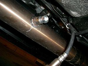

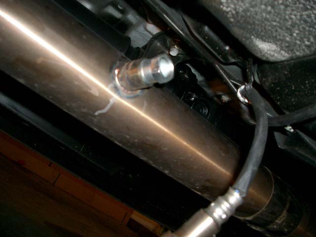

P0420. You need to move the rear O2 sensor out of the exhaust stream by installing a spacer. Get 1 or 2 anti foulers at pepboys and install them under the O2 sensor. $5 fix. You may have to drill out the outer one so the O2 sensor screws in all the way.

you have 2 options. Either go with an electrical 02 similator fix, or the less expensive mechanical 02 fix. I chose the latter, spent $10 and it worked fine. Do a search for "mechanical 02 fix" there is a how to.

Problems with the mech fix are normally not being able to get 2 antifoulers in (P0420) there as the o2 sensor would hit the undercarridge, or water collecting on the sensor causing cels, if the sensor is angled down (P0139, P0138)
If you get a elec fix which involves cutting wires, MAKE SURE YOU SOLDER THEM. You are far more likely to get a P0139 if use crimp connectors for the signal wire.
I have heard of people in the North east getting more CEL's of this nature in winter when a lot of snow gets flicked up under the car and onto the sensor (if it is angled down) as well.

It needs to "leak in" as you say, but you don't want it right in the exhaust stream. Anti foulers at your local Pep Boys are like $4 go for a shorty and your done, if that's the code and you have room. I've seen people use a right angle fitting so they can get the sensor further out and still have clearance.
