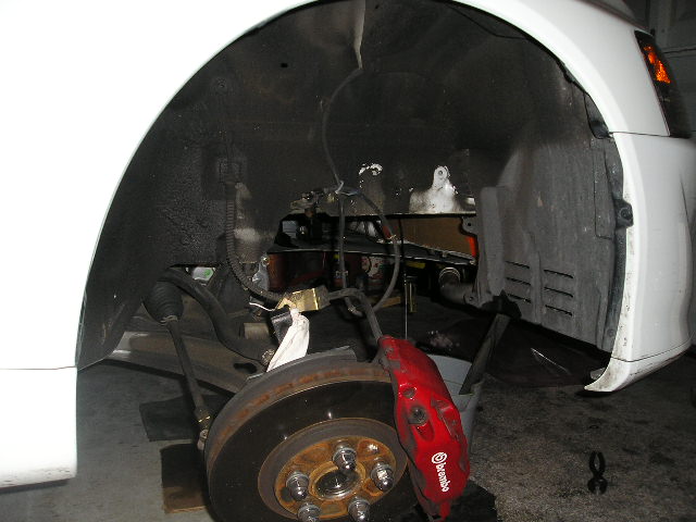

you dont have to remove the tie rods. You can simply undo the front strut and it will allow the brake rotor/hub ***'y to drop down and the axle should slide right out. Getting it out of the hub should be the easiest part.

there are different ways to approach the same problem. I removed the strut and the hub came off the axle w/o having to undo all the tie-rods. These were taken 5 minutes ago as I am in the middle of my rebuild.
Passenger side..note the two holes for the strut and the zip tiees holding the hub up so it does lay completly flat.
Note how the tie rods are still intact and the suspension removed.
Attached Thumbnails Need help removing front axle...-axle-removal-001.jpg   Need help removing front axle...-axle-removal-002.jpg   Need help removing front axle...-axle-removal-003.jpg

i think he's having issues removing the axle from the hub not the shaft............. simply back the king nut out a tad and wack it with a hammer!
