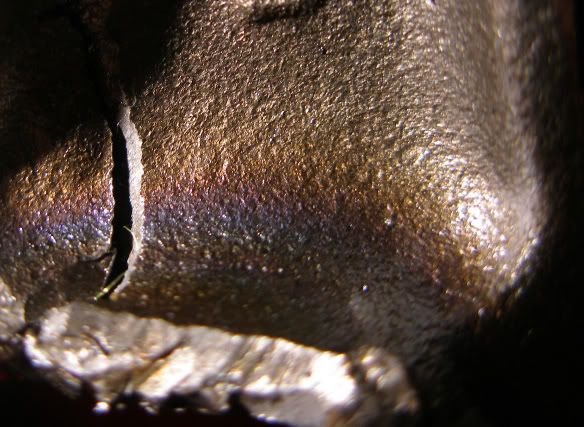

Is that what you determined where the failure was? I remember your car was knocking heavily as you were driving it and putting a lot of load on the motor. You continued to drive it until it stalled then started it again and then it blew up?
Seems like a oil pump not working during that time could definitely cause a problem.

As far as we can tell that is the most likely source of the failure. Before I had a chance to pull off of the GW bridge in NY, it was stalling whenever the clutch was depressed. The became present over a few minutes time, and was extreme just as it let loose. Boost would peak at 15-16 psi with only 5% throttle input on flat ground in 5th gear under 2500 RPM (while attempting to get off the bridge in traffic). The #4 rod lost oil pressure first (furthest from the pump) and the scuffing on the cylinder walls gets worse as they move away from the pump.
Old Mar 30, 2007 | 12:36 PM
  #105
Stew's Avatar
Posts: 834
From: CT
Fairly obvious lubrication issue:
#4 rod
