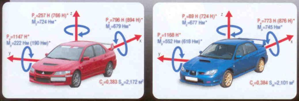

Here is the Cd and frontal area of a IX:
Old May 18, 2007 | 02:09 PM
idriveanevo's Avatar
iTrader: (30)
Posts: 1,286
From: in my Evo
where did yu find this? ive seen this but it was with lift and downforce of the wing and the entire car

https://www.evolutionm.net/forums/sh...d.php?t=205084
