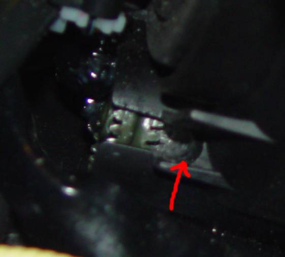

There's a little hole, with some gear looking things in them. The hole is big enough for a phillips screwdriver. There are a couple pictures on here, but I'm too lazy to search for them right now.
You put a screwdriver in there, and slowly crank. Takes a number of turns, but that's how you adjust the headlight levels.

Picture of what the gears look like:
