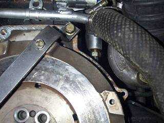

Don't use stripped/rounded bolts. Take them out and get new ones.
Use the strip of metal trick as mentioned before (the pic is from a 1g but same idea), or a flywheel wrench to hold it steady;
