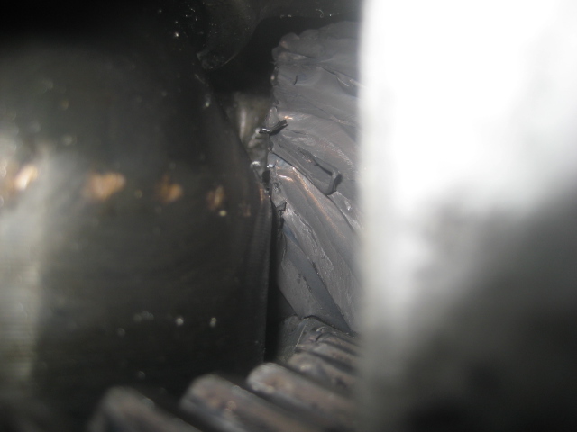

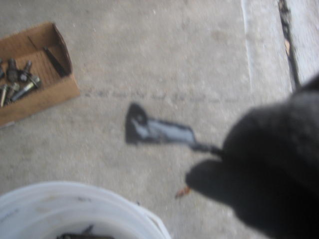

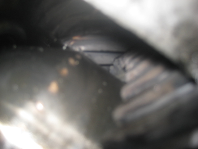

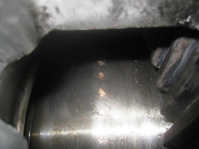

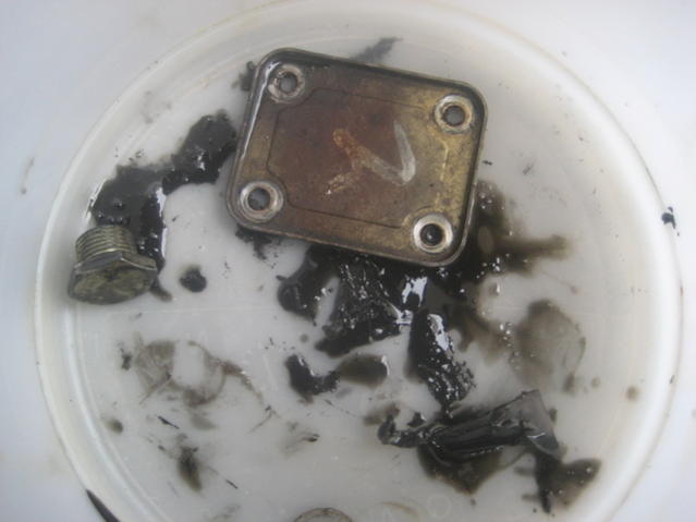

UPDATE** okay so i took off the oil drain plug for my transfer case and what do i find? not a drop of oil on the plug i found very thick grease with a bunch of metal shards in it so im assuming my transfer case is toast . would anyone know how i should proceed with the repair process? and is there anything else that i could have damaged when driving without the transfer case oil? il post pics as soon as i can...
Old Nov 9, 2011 | 10:06 AM
barneyb's Avatar
Posts: 6,902
Likes: 151
From: Grand Island, NE
Well, I suppose you could fill it up and pray for a miracle but if it was dry enough to stop the car the thing is burnt toast. So, ship it off to one of the rebuilders in the states, buy a new one or shop for used.

yea i might have to send it for rebuild, finding used would be hard where i live. il try filling it with oil and hope for a miracle but i doubt it will work im uploading pics now...this is so sad sad to see right after my engine rebuild

pics...
Attached Thumbnails test drive went wrong..-img_0235.jpg   test drive went wrong..-img_0236.jpg   test drive went wrong..-img_0243.jpg   test drive went wrong..-img_0248.jpg   test drive went wrong..-img_0250.jpg
