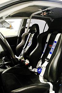

You don't really need a harness bar if you want to install sparco harness. You can attach them from the floor board behind ur front seats or you can take out the back seats and attach them were the seat belt screws are. Here's pic of my setup.

Where in the floor do they attach to? Could you post a pic?
