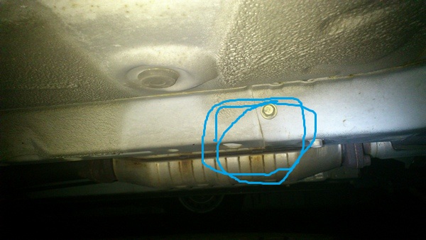

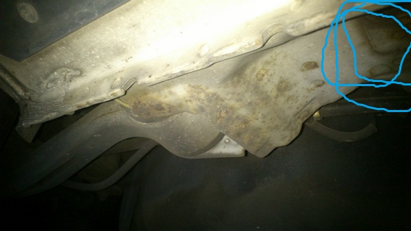

okay so just so i'm 100% clear, I should be using the following for jack stands:
front:
rear:

the front one is perpindicular to the rail that runs along the bottom. where the bolt is the rail is double over and strongest
this stand goes at the same angle that the control arm runs, you can kind of tell what i mean from the pic. if you have shallow cup jack stands they will cup the mount perfectly. make sure they aren't resting on the square piece of frame that surrounds the bushing/control arm as that will be extremely unstable

You'd have to look at your jack to see if it would fit in place of the pad. Frankly, the front crossmember and rear diff are the best jacking points
