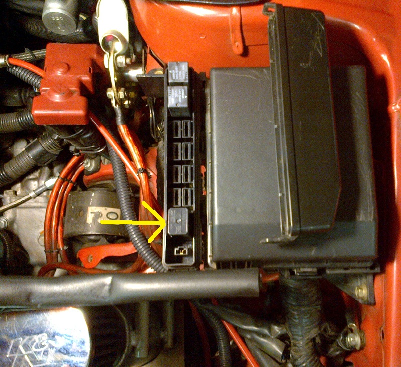

Remove the upper and lower steering shaft covers and leave them off. When it acts up and won't start at all, stop what you're doing, remove the switch from its mount, and activate it while in your hand. If it still doesn't start with you palming the switch, then I'd replace the starter relay.

Where is the starter relay located?
