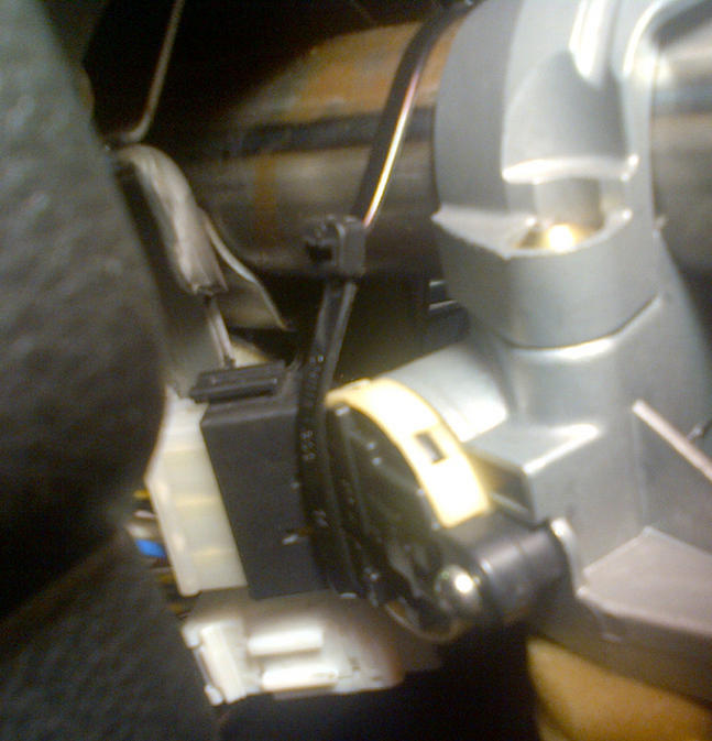

The problems for many often begin with the slightest rotation of the ignition switch in the direction of the turning key. This prevents the car from starting reliably, and repeated start attempts take a toll on the ignition switch and solenoid.
The first thing to do when this happens is fix the starter switch from rotating again, which is easily done by looping a plastic wire tie around its electrical socket and the steering column (see attached image). This keeps positive pressure against the switch counter to the direction of the turning key.
If the switch, wiring, and starter relay all check out, and the solenoid gives a single loud 'click', but with no starter action, this indicates the solenoid is getting the trigger, but it is not being activated fully enough to engage the starter contact. A quick way to confirm this is to pop the starter relay and jump the solenoid trigger terminal straight to battery. Chances are it will crank right over with that extra current. This is my situation presently, and onefastevo9's account suggests this indicates the solenoid is dirty or bad. The internal button inside mine is definitely hard to depress, which seems to be a telltale sign that explains why only direct battery current can engage it fully.

With the incorrect solenoid on my car, it would click every time. If your solenoid clicks every time without turning the starter, that indicates either a bad solenoid, starter, or battery/ground connection to the starter. If the solenoid does not click, then it could still be the solenoid, but may be the starter relay, or a starter switch slippage issue as described in this discussion.

Omg iv literally tried to trace this problem for the past two years!! Tightened that screw and solved my problem!!! Thank you soooooo much!!!
