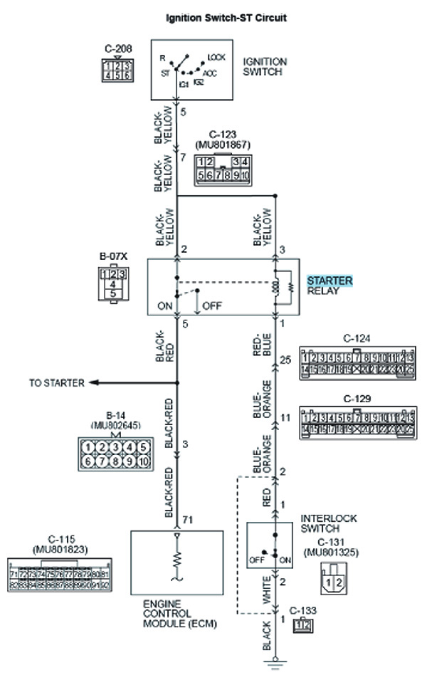

Bypass the starter relay, and I'll bet it cranks every time. See post #50 for location. Jump the positive battery terminal to pin 5 socket, and it should crank. If it doesn't crank, your solenoid wire is shot or has a bad connection at the solenoid. If it cranks, either the starter relay is shot, or you don't have enough juice to activate the solenoid. If that turns out to be the case, I believe I have a fix.

I bypassed the relay and the car started right up.
So looks like starter relay is shot, or I don't have enough juice to activate the solenoid.
Ordering a new relay today or going to buy one if I can find one in stock.
Thanks Ted B for the fast response. Would like the info on your thought fix for not having enough juice to activate the solenoid being this still might be the problem.

This is the lingering issue that plagues me on occasion. I have previously fixed the slipping starter switch issue, replaced a bad starter relay, and replaced an incorrect starter solenoid. I have also cleaned and tightened the solenoid trigger wire socket assembly. And while these have reduced the starting issue by 90%, it has become clear that whenever this issue does reappear, triggering the solenoid directly from the battery as I described just above always gets things cranking. I've even resorted to keeping a jumper wire in the glovebox just in case I get in a fix.
The starter solenoid receives its signal from the starter switch via the relay. This is not a dedicated power source, and can pass only a tiny amount of current. I've thought about powering the solenoid side of the relay directly from battery, but that will create a real mess if the relay shorts, and I've shorted two already from repeated cranking efforts. If I do this and the relay shorts, the engine will keep cranking, even with the key removed. I don't like that idea.
I've decided to get a universal 30A 5-pin relay and pigtail, that I will add to the existing starter circuit. I will cut the pin #5 wire between starter relay and solenoid. I will use the solenoid signal from the factory starter relay to activate the low current side of this relay, and wire the high current side from solenoid to battery. That will fix it.
