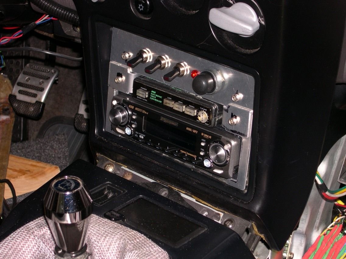

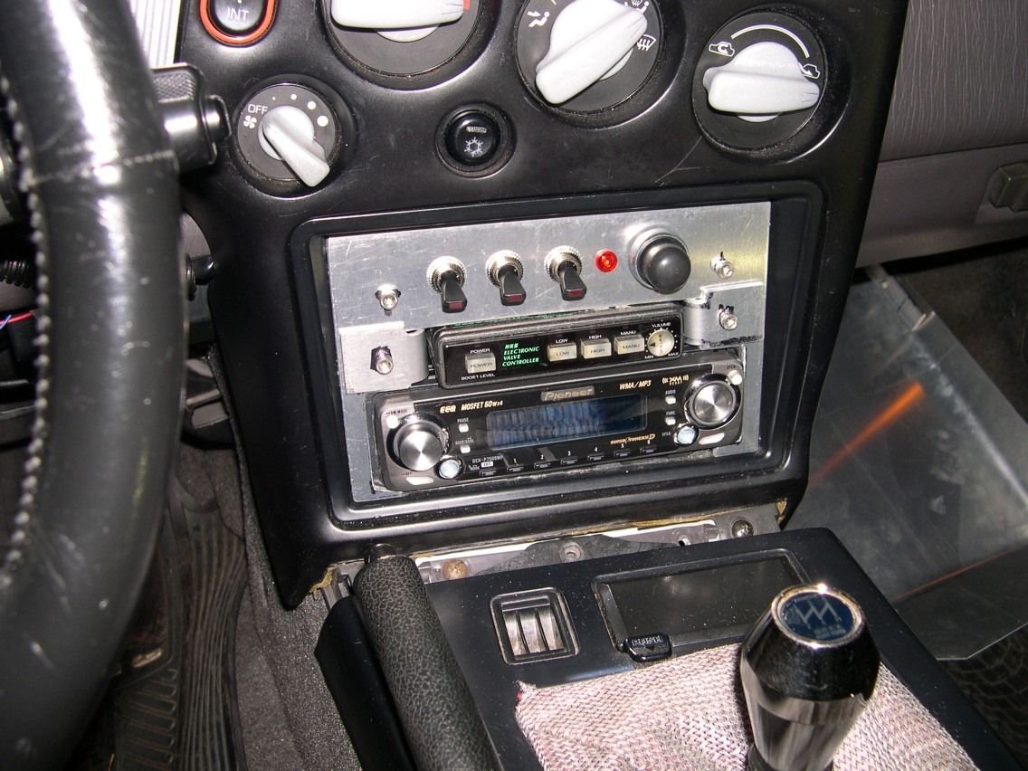

Here’s my solution on a 1990 Talon: A dedicated starter circuit fired by a heavy duty 50 amp momentary pushbutton switch. The circuit bypasses the ignition switch and every other gizmo that would otherwise be in the circuit. One wire goes straight to the battery with an inline 40 amp fuse, the other wire plugs into the starter relay socket, where the outbound relay pin would normally go. This takes the 30 amps or so to the starter solenoid. So now the ignition switch is used only to turn on the ignition. The 3 flip switches and red LED are just other things I needed to mount someplace. I made the aluminum plate and its mounting brackets to accommodate the radio, boost controller, starter button, the 3 flip switches and the red LED. The starter switch is the one I showed back in post #69.
