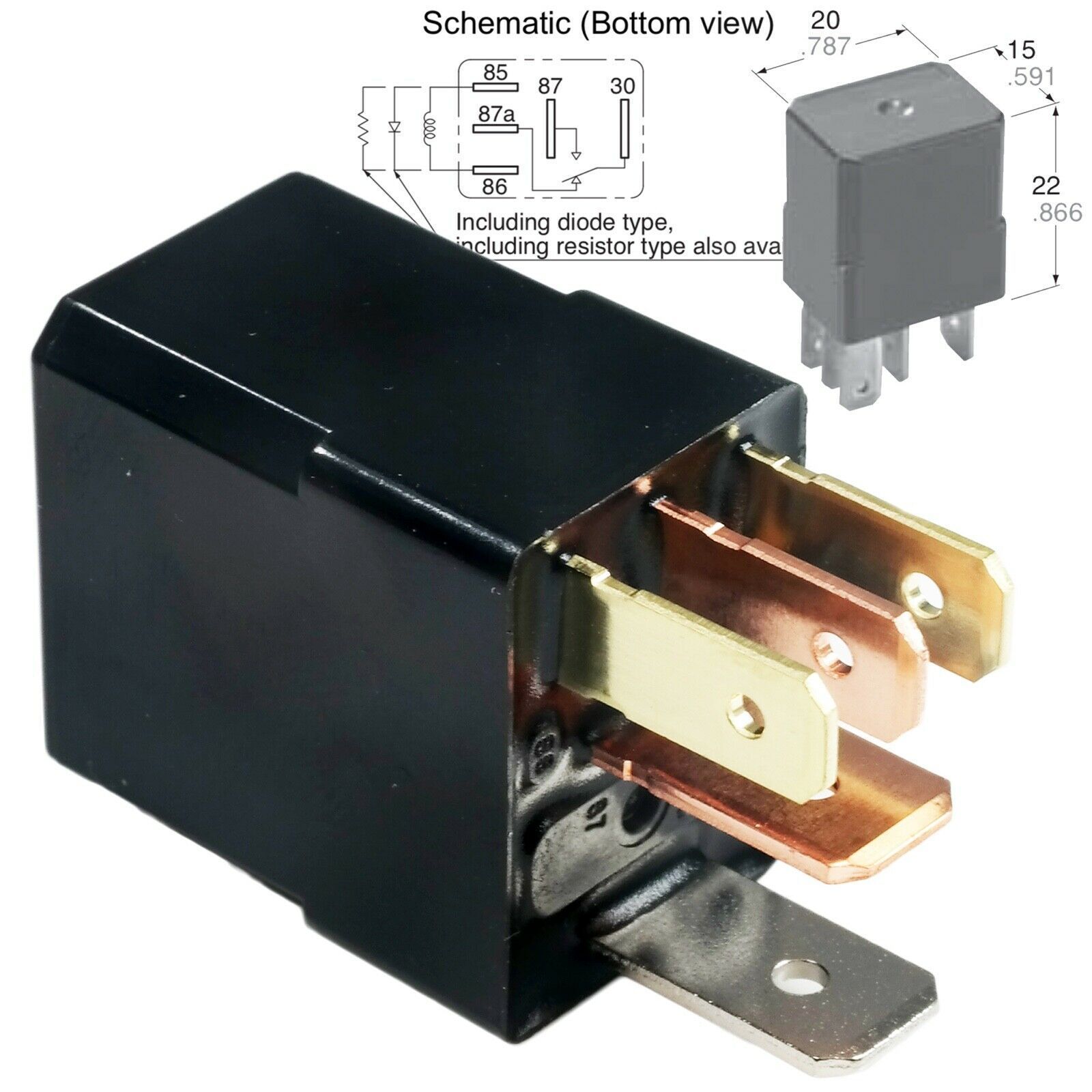

anyone tried this yet?

From: Birmingham, AL
I tried several different relays when I was having problems just to see if quality control was a problem. I am skeptical of why this OE replacement would be anything special aside from printing "HD" on the box. Since adding a much beefier relay as I described in post #148 (which was cheap and easy to do), the issue has been completely resolved and has not returned (FYI).

did the OE replacements work for a time or no improvement?
This seems physically bigger in size. I'll post a pic when i get a hold of it.
I do want to try a few other options first before I go the standard relay. I dont want to add dongle/wires just yet... I just sorted all my engine bay wirings. The contacts inside the relay matters, just like spark plugs, any type of spark can degrade the conductors, copper/brass would be in the lower quality side. Some use cadmium free silver alloys. This (also seems bigger) may be an upgraded version of what i have in my car
https://www.ebay.com/itm/352661779464
