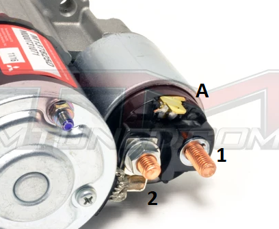

Update: My starting issue is still there, but the ignition switch tightening did help. I decided to investigate.
I jumped the white wire and black/yellow stripe wire together at the ignition switch (without the starter relay plugged in otherwise the car would constantly crank) so that I could measure the voltage at the starter relay in the small rectangular fuse box under the hood. I was getting the full 12.6 volts with the car off. That confirmed that if the contacts in the ignition switch are good, the issue lies in front of the firewall. I decided to take apart my starter motor to investigate.

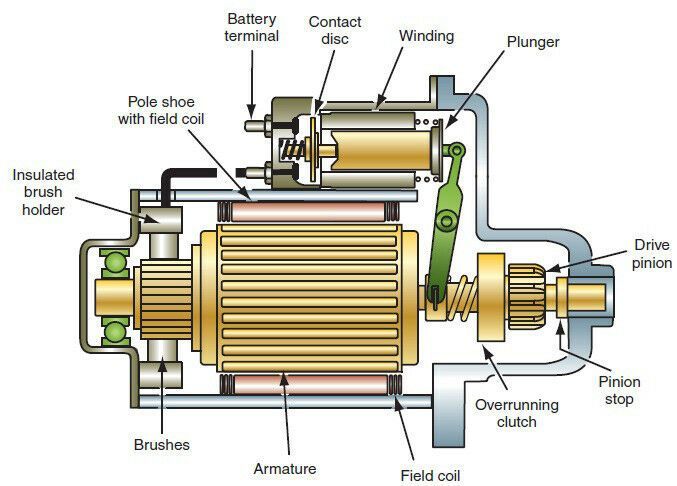

The starter solenoid has two jobs: 1. to push the drive pinion into the flywheel and 2. to RELIABLY and ROBUSTLY connect the starter motor stud to the +BATT stud. If you take apart your starter solenoid and push down firmly on the metal button at the bottom, it will create continuity between the +Batt stud and the starter motor stud. If it can't make this connection, the starter motor will still start the car, but using only the starter signal power which is supposed to be used only for energizing the solenoid. Why?, well, the start signal power terminal (that little metal tab) is continuous with the starter motor stud This wire has no business starting the car because it's gauge is way too high. The wire is just too thin.
Below, blade terminal (A) is permanently connected to motor stud (2). Blade terminal (A) gets energized with 12.6v from your battery when you turn the key to start the car. It's a good way to hide an issue that can exist between Battery stud (1) and Motor stud (2).
My contacts were so warn out, i needed to press VERY hard to create continuity across the studs. The two solutions are to replace the starter solenoid or wire in a start assist relay to send more current to the motor just like a few other members have done. I did it last night, we'll see how she does now.

Originally Posted by barneyb
The power coming down from the key is only enough to pull in the solenoid. If the contact disc in the solenoid is shot you need a new solenoid.
Correct, but that same wire in which the key power comes down from is continuous with the motor stud, which could hide a problem with the contact disk. Even though it's a thin wire, it's just the right gauge to turn the motor over on most occasions (as long as the engine didn't stop right at the start of a compression stroke). I probably do need a new solenoid though. I'm gonna look for one and if I can't find one, i'll go with a new starter.
