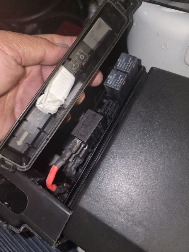

Here's the no-wirecut "HD relay" solution (using OE relay). I implemented this today since I miss that fast-cranking sound
This still needs the wire extensions (pigtails) pictured above. "A" was the clutch switch, now its just a security switch. I've always had it but now "OFF" is "starting disabled"
pin/terminal 2 is not connected. "B" is 12v power supply to relay terminal 4, coming from the fuse box. I'll probably add a fuse at "B"

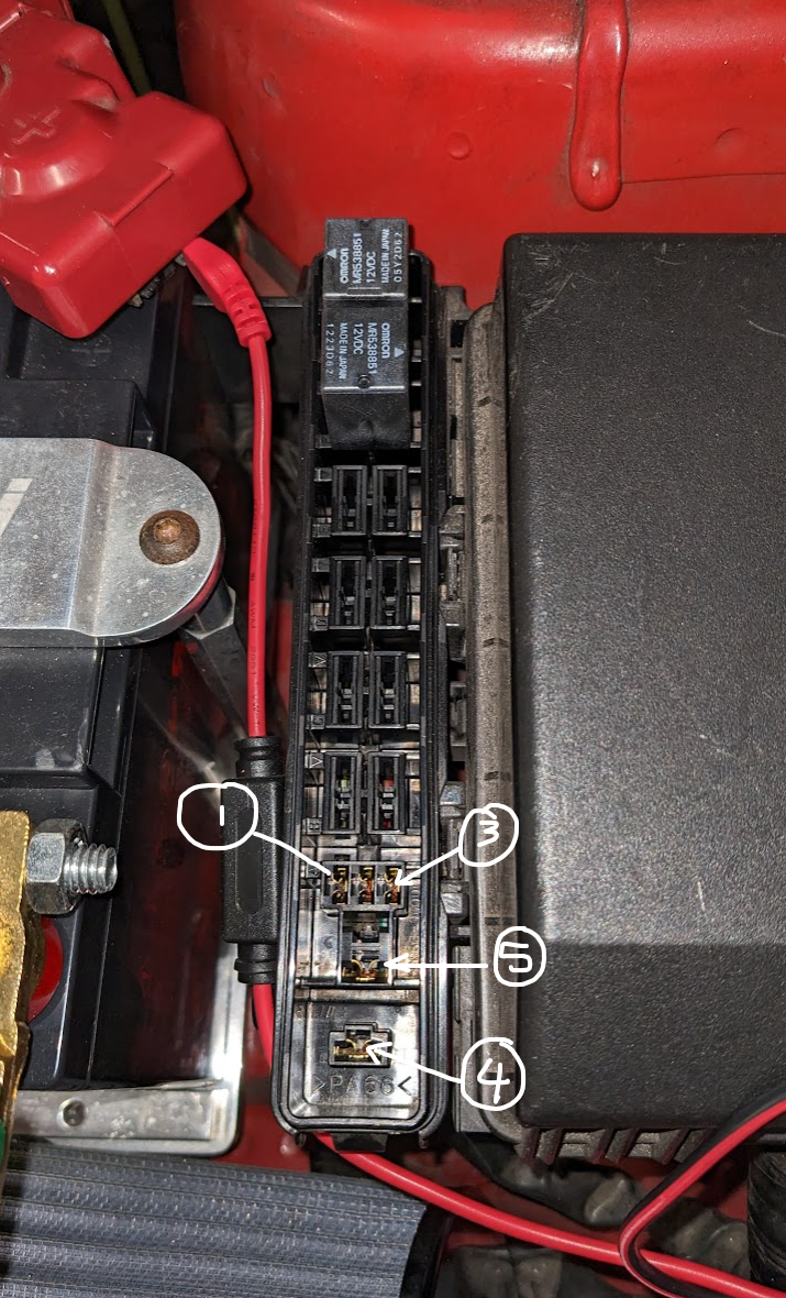

**DISCONNECT THE BATTERY WHEN WORKING ON ELECTRICAL STUFF** (but not really necessary here)
So basically your starter relay is plugged in this box. pictured here is just extending the connections to terminal#s 1, 2, 3, 5 (it did not use #4)
sample wire extensions (what i refer to as 'pigtails') with appropriate terminals (standard spades connectors need to be trimmed to fit). this wont change anything. you can make the wires long since you're just doing 'proof of concept' to see if it addresses your particular issue.
your relay
for the actual fix, the only difference here is
  • #2 'pigtail' is removed, and
  • #4 is connected to a battery source which is that bolt#4. You can just connect 4 & 4 and not go under the boxes (that's just for a clean look)
(connect battery), dont depress the clutch (or remove clutch switch connector and jump the terminals in the plug) and turn the key to start the car, see if you have no-hesitation full cranking force. If its good then you just need to clean up the connections, make them short enough to be tucked inside the box

So if I understand correctly, we're connecting #1,3,5 to the same locations, we're no longer connecting #2, and then moving #4 to connect to the lowest connector in the relay box? Is that a fuse on the #4 line that I see in your pic?
Old Jan 8, 2023 | 08:07 PM
  #298
ViciousLSD's Avatar
Joined: Oct 2011
Posts: 3,858
Likes: 600
From: Houston
@Thoe99 yes, but thats not #4. its this bolt
its not a fuse, just a spade terminal. not necessary, i only put it there so i can swap out relays. I switched to the relay from amazon to test its quality.
I also used wires that are way too thick, it doesn't have to be that thick. i was previously experimenting on ensuring some pressure is applied to the terminals when the cover is installed
