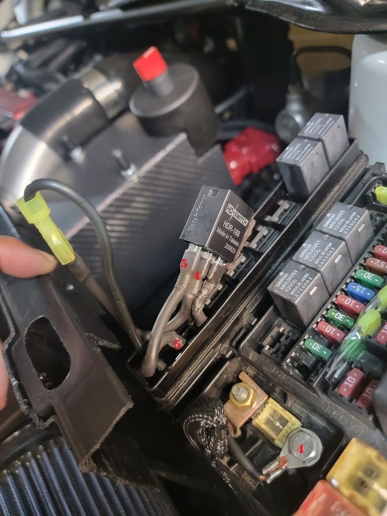

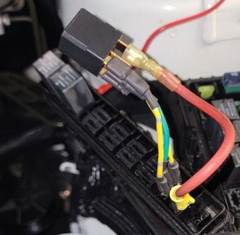

@Thoe99
**DISCONNECT THE BATTERY WHEN WORKING ON ELECTRICAL STUFF** (but not really necessary here)

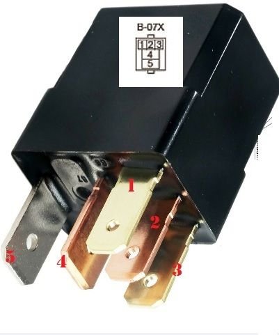

So basically your starter relay is plugged in this box. pictured here is just extending the connections to terminal#s 1, 2, 3, 5 (it did not use #4)
sample wire extensions (what i refer to as 'pigtails') with appropriate terminals (standard spades connectors need to be trimmed to fit). this wont change anything. you can make the wires long since you're just doing 'proof of concept' to see if it addresses your particular issue.
your relay
for the actual fix, the only difference here is
  • #2 'pigtail' is removed, and
  • #4 is connected to a battery source which is that bolt#4. You can just connect 4 & 4 and not go under the boxes (that's just for a clean look)
(connect battery), depress the clutch and turn the key to start the car, see if you have no-hesitation full cranking force. If its good then you just need to clean up the connections, make them short enough to be tucked inside the box
So far, so good with your solution, ViciousLSD. I added a 30amp fuse on the red power line (what do you guys recommend?). I've also been enjoying the no-clutch-in-to-start feature of this. Thanks for it!

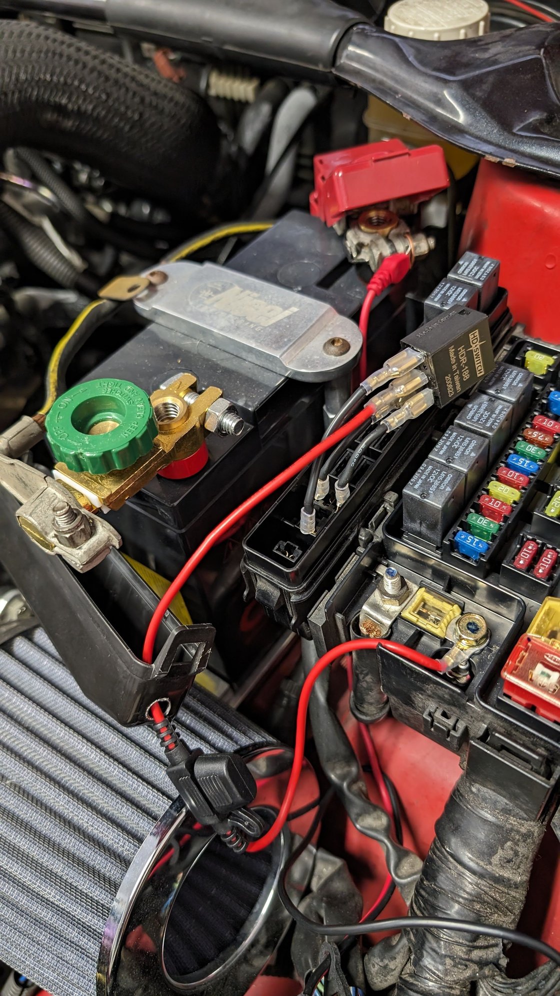

Originally Posted by Thoe99
So far, so good with your solution, ViciousLSD. I added a 30amp fuse on the red power line (what do you guys recommend?). I've also been enjoying the no-clutch-in feature of this. Thanks for it!

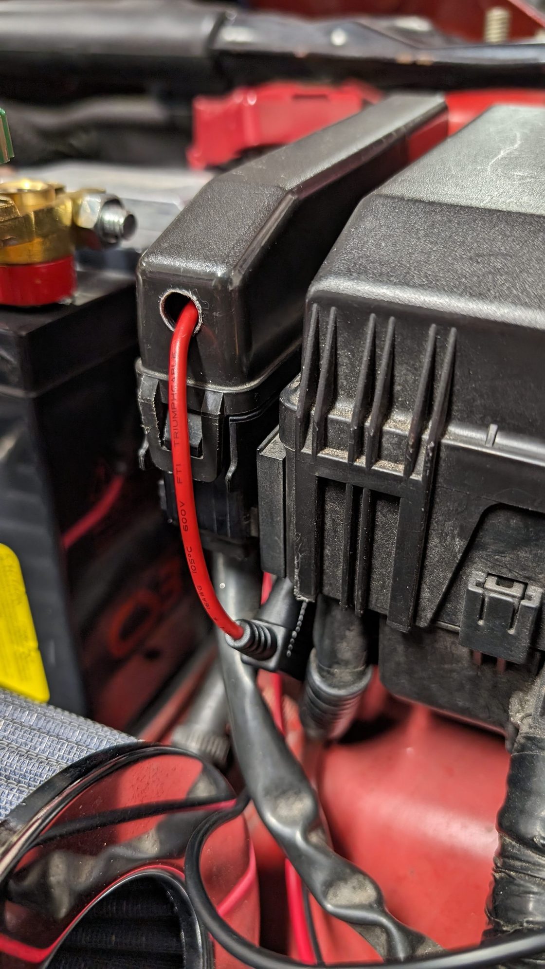

cool. No more slow cranking I hope.
Presentation-wise, you could have drilled the bottom of the case to hide all the wires. BTW you need to seal that hole in case you wash your engine
I cant confirm right now but isnt that bolt for #4 fused already? I was planning to add a fuse thats why my line#4 has a crimp terminal. If I get around to it i'd keep the fuse in the box to keep it looking clean

I never had slow cranking, but it does seem like my cranking is a split second faster every time. It feels very robust. Don't worry, I never wash the engine bay, although I did think about what would happen in a thunderstorm. The hood rubber seal seems like it can block most of the water going towards this box. You guys let me know if this is not the case though. I ordered another relay box cover just to have as a backup for any purpose in the future. It was really cheap and surprisingly still available.
Let me know if you can confirm that we do not need the extra fuse on that #4 line. (that #4 bolt sits on a 60 amp fusible link btw).
Also, if you drill the bottom of the relay box, where would you drill it? I haven't even figured out how to detach that box from the main fuse box yet, despite toying with some of the plastic attachment clips there.
Overall, this mod has been so nice. I had stopped driving my Evo because I didn't wanna be stranded anymore, and in the rare event I did drive it, I was pre-planning my parking spots so I can roll start it if it came to it. Not anymore! Ted B, that's really encouraging to hear!

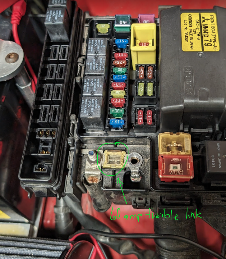

Since your battery is close by then you can just take the the power to #4 there the #4 bolt powersource is just IF you want a completely clean solution
If you look at my #4 wire, thats exactly where I drilled the hole out of the case. I think TedB had some pictures earlier showing the tabs to separate the 2 cases.
If youre going to add a fuse then its better to take the power from the bolt pre-60amp fuse. I would use flag terminals to hold the mini fuse (like the terminals on your relay) and just lay it on top of the other fuses. I keep several backup fuses in that case btw. you could also test your old relay, that way you know its really nothing to do with "HD relays".
yes its good to know how this area works. If your relay or starter switch dies on you, you know you can just tap terminals #4 and #5 to spin the starter

bonus feature : you can add a security switch to replace the clutch switch.
When youre done with the relay stuff, look into parts store powersports batteries, so you have a solution when your battery dies on you. I use a ~$55 battery and loving the idea i dont need special batteries. for that you need to get rid of the standard battery terminal and maybe add a battery cutoff switch for bonus convenience

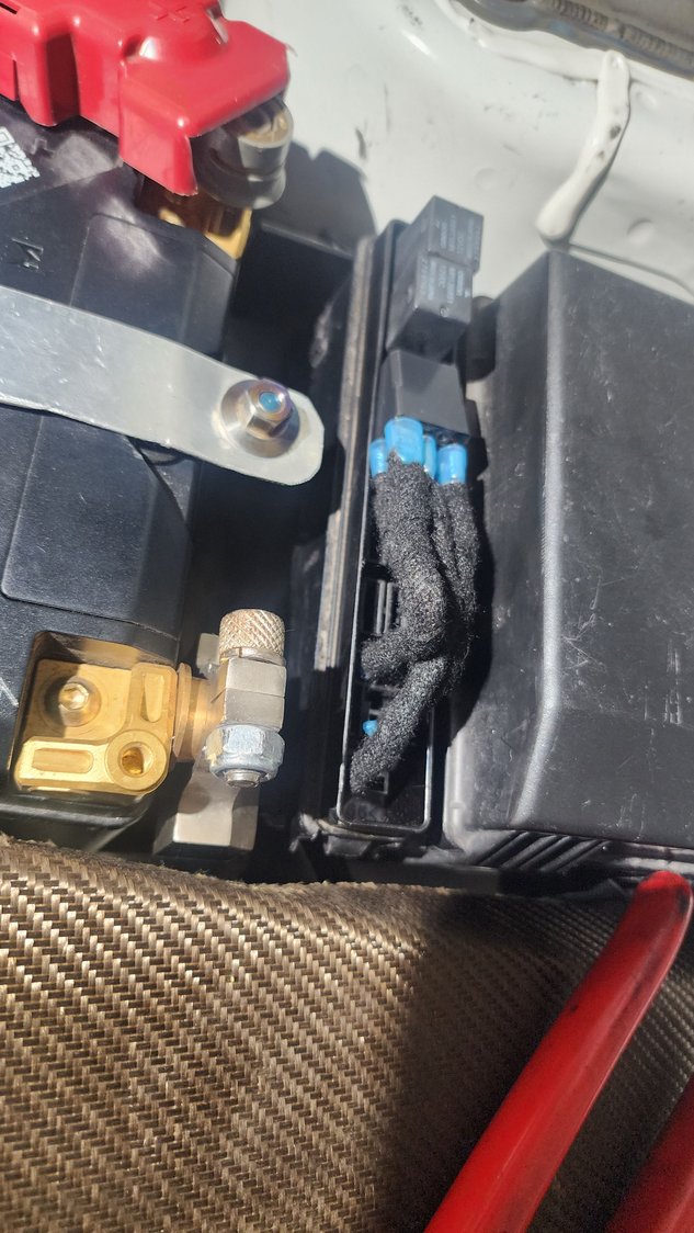

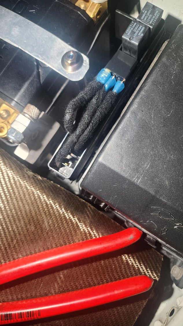

@Thoe99
your relay
(connect battery), dont depress the clutch (or remove clutch switch connector and jump the terminals in the plug) and turn the key to start the car, see if you have no-hesitation full cranking force. If its good then you just need to clean up the connections, make them short enough to be tucked inside the box
Works like a charm for me so far! I thought it was my starter switch and checked to see if it moved as well as replaced it. No help.
This no cut method works and is pretty simplistic.
Thanks!
