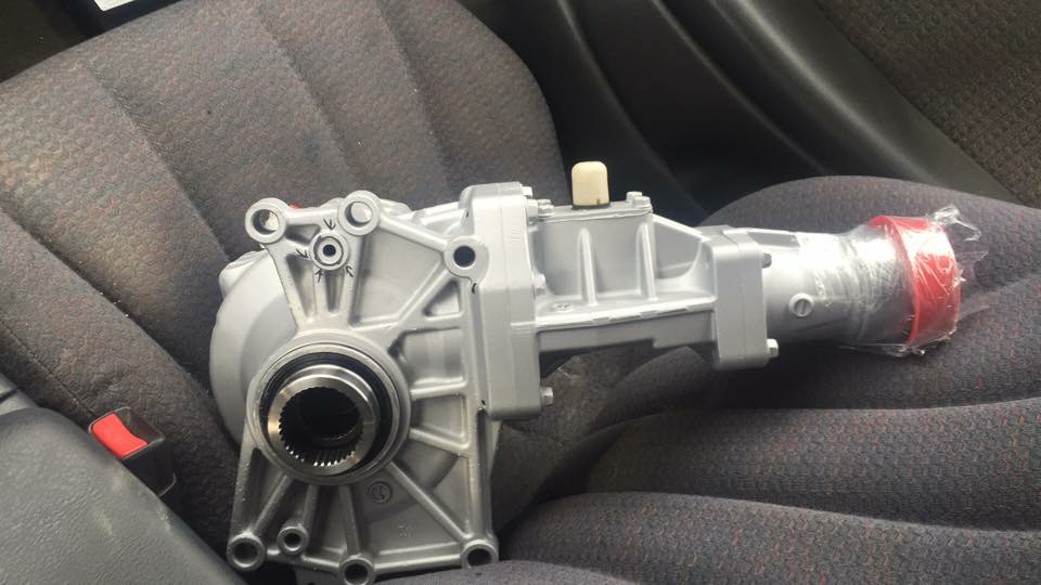

So I've been super lazy with the holidays, and such to do the update, but I finally have some time to post up some progress pics. Progress has been really slow due to big financial set-backs, but at least I'm slowly pushing along, and that's better than nothing.
I finally got around to installing the rods, and pistons. It took along time due to waiting on the wiseco piston ring compressor from Summit Racing because it was a special order item. Ring end gap was .021" top, and .024" bottom. After, I went onto stretching the rod bolts to spec. I definitely recommend ARP's Rod Bolt Stretch Gauge. It's a bit pricey, but well worth the money IMO. Anyways, torque varied anywhere from 54-58 lb-ft if I recall correctly on the rod bolts.
I ended up having to pay for the t-case because Allstate Motor Company refused (working on a lawsuit as we speak). I just opted for a Shep Stage 1. I don't plan on launching or dragging at all. Maybe a couple track days, and 1-2 times at the local strip.
Also, I ended up getting a good deal on Buschur's modded oil pan. I needed a new one because mine had so much shavings not to mention leaves, etc. because I accidentally forgot it outside. I ended up scoring the pan, and much needed valve seals for $100 cash. I didn't/don't want to get any oil related parts used.
Currently, I'm waiting on the oil pickup tube/strainer to come in from ExtremePsi (Scheduled 01/12 :[ ) and then I can install the front case (BSE), rear main seal, and button the short block all up. As far as the head goes, I am going to end up reusing the OEM valves. I should get a 3 angle valve job at the very least though. The P.O. had Kelford 272/272's along with their titanium spring & retainer kit. So I'm squared away in that regard. Can anyone verify if it's alright to run OEM exhaust valve seals on the intake side? Buschur tossed in two packs of 10 valve stem seals with the pan. I'm waiting for a buddy to be free so I can use his valve spring compressor to assemble the head.
So with all that said I should have a long block assembled soon )) and ready to drop it in the bay. I'll be working on adding some pics within the next few hours or tomorrow at the latest.

you should recheck thrust with the rods and pistons installed.
Looks good though!
Old Jan 9, 2015 | 03:24 PM
  #55
EvolutionIXMR06's Avatar
Veteran: Army
Joined: Mar 2013
Posts: 233
From: Cleveland, OH
Looks good though!
Thanks for the advice! I'll have to check it that way, but I appreciate it!
