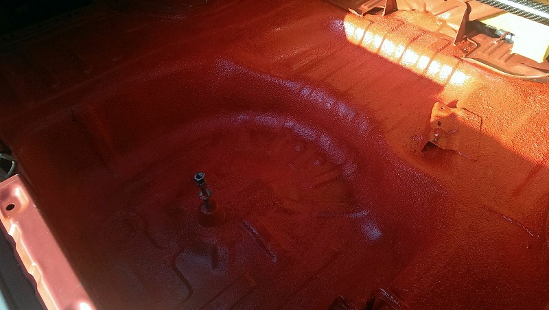

First coat still wet:

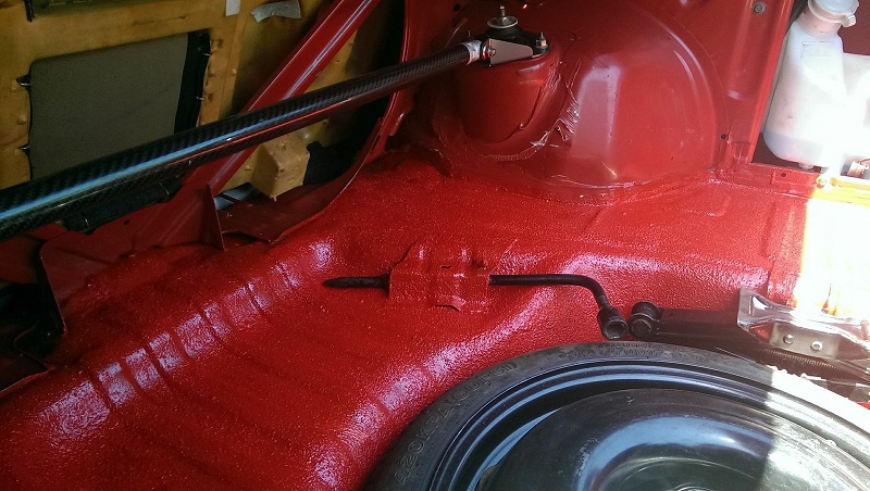

And second coat nearly dry... I ran low on material as the can could not be resealed and I lost a good bit to drying. Sucks. I will probably get more and do the strut towers too anyway though.

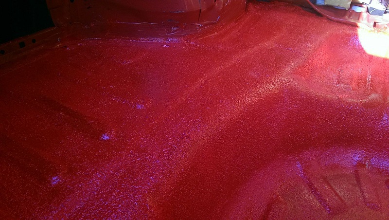

24 hours cured:
Over all I'm quite pleased. One of the big hang ups I had that kept me putting it off was the look of black linings in a red car. I was concerned about how crappy it would look. This lessened the effect quite a bit.
............in before "why didn't you just buy carpet" and "ZOMG you added 1.9 lbs to the vehicle you're going to be slooooooooow"

The last two pictures are the most accurate representation of how it looks now with minimal lighting issues like the pictures ahead of them.
