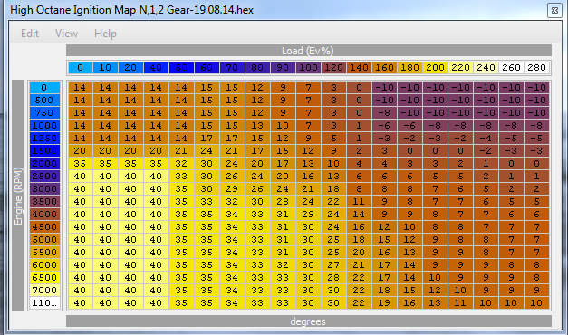

Once you have the cable. First thing you should do is do a log and see how much knock you have. To do that you need the cable + evoscan. I use evoscan v2.9. Works quite well. You want to log RPM, Throttle position, knocksum, injector duty cycle, 2byte load, and timing advance. If you drag all of those items to the top it will populate them together in excel which makes your job easier. Start datalogging in evoscan, find a nice flat road and do a 2k-7k rpm pull in 3rd gear. Then open up the log that you did in excel. When you get in there delete all the cells that aren't 100% throttle, and if you want you can round stuff to whole number to make it easier.
The first thing you want to do is eliminate knock before you start doing anything to make your engine safe. The general rule for knock elimination is you pull 1 degree of timing for every 3 counts of knock. SO if you have 9 counts of knock pull 3 degrees of timing for instance. You need to go into ecuflash to do this. You have to copy your stock ecu tune onto your laptop and save it as a base (safe) tune. I make mine read only so if anything goes wrong I can go back to it. In ecuflash you then need to scroll down until you find the timing maps, and select the high octane timing map. Then in there adjust your values depending on the load to remove the knock. The values are positive for degrees of timing advance and negative for degrees of timing retard. Once the values are adjusted based on the load, you need to smooth the values either side to create a smooth transition through the power band and rev range.
Its a bit of a guessing game when you first start. If you just adjust the high octane timing maps one or two degrees at a time, and do a couple of logs in between each tune, recording what is happening and further adjusting, you can't go wrong. The stock fuel maps are very rich and safe. My advice definitely is though, ONLY ADJUST THE HIGH OCTANE TIMING MAP, do not adjust the low octane. The low octane is your failsafe map, and will revert mainly to this if you get a bad batch of fuel. Any more questions feel free too ask. There is a sample of my high octane ignition map at the bottom so you can get an idea of what I mean about smoothing between cells on the map.
