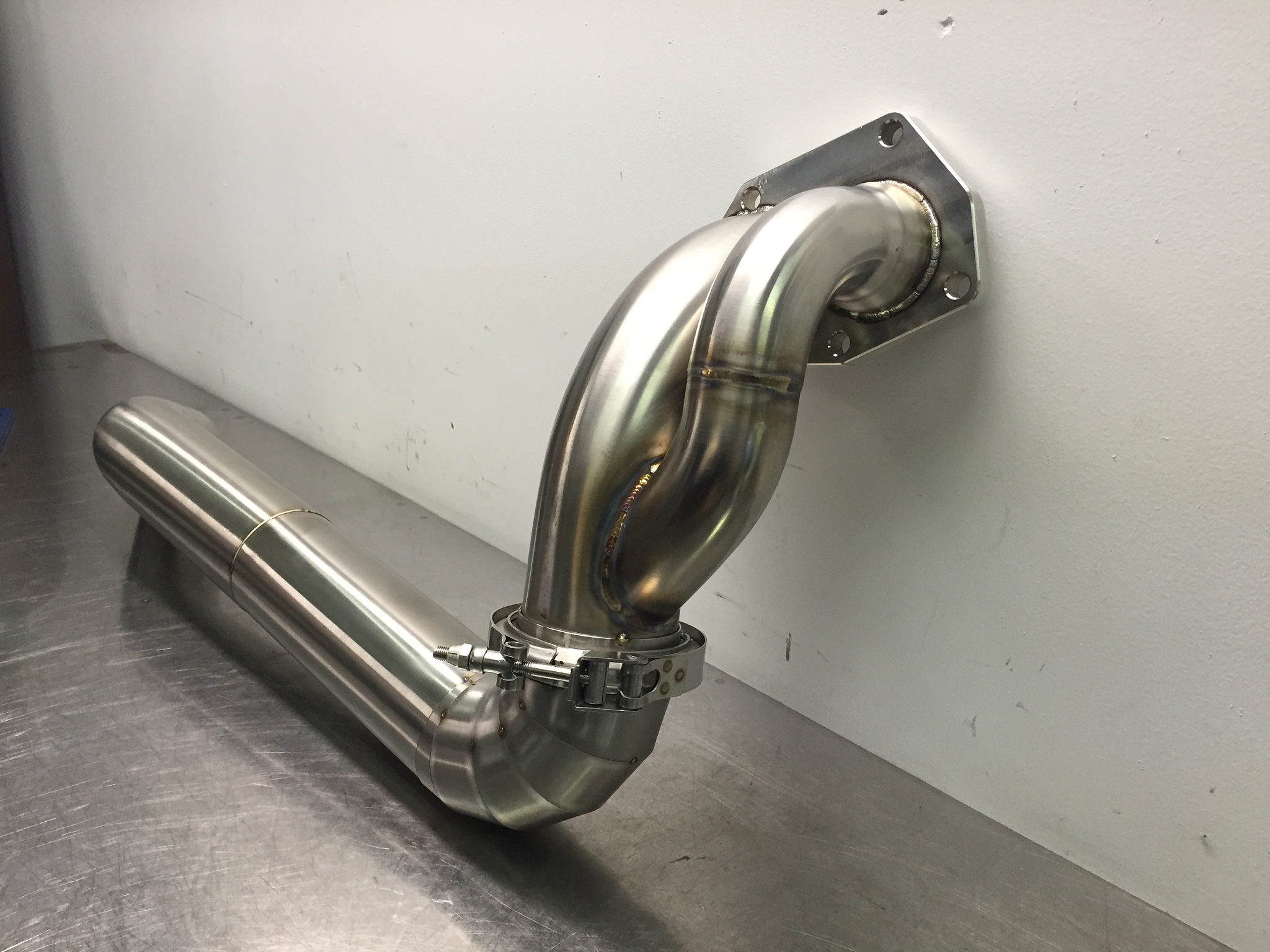

This is what the origin piece looks like. It replaces the o2 housing, downpipe and test pipe.

You are running a custom BR HTA35r kit, thus, only BR has the fabrication jig to make you another recirculating dumptube/O2/downpipe combination because the manifold position with respect to the turbo is unique.
The picture posted above will not work because it is made for a stock frame type of turbo with an internal wastegate.
Your best bet is to go to your local wedl/fabrication shop and ask them to quote recirculating the current dump tube into the down pipe. Otherwise, you can ask BR if they still have the jig for your manifold and could make you a new piece to fit your needs.
