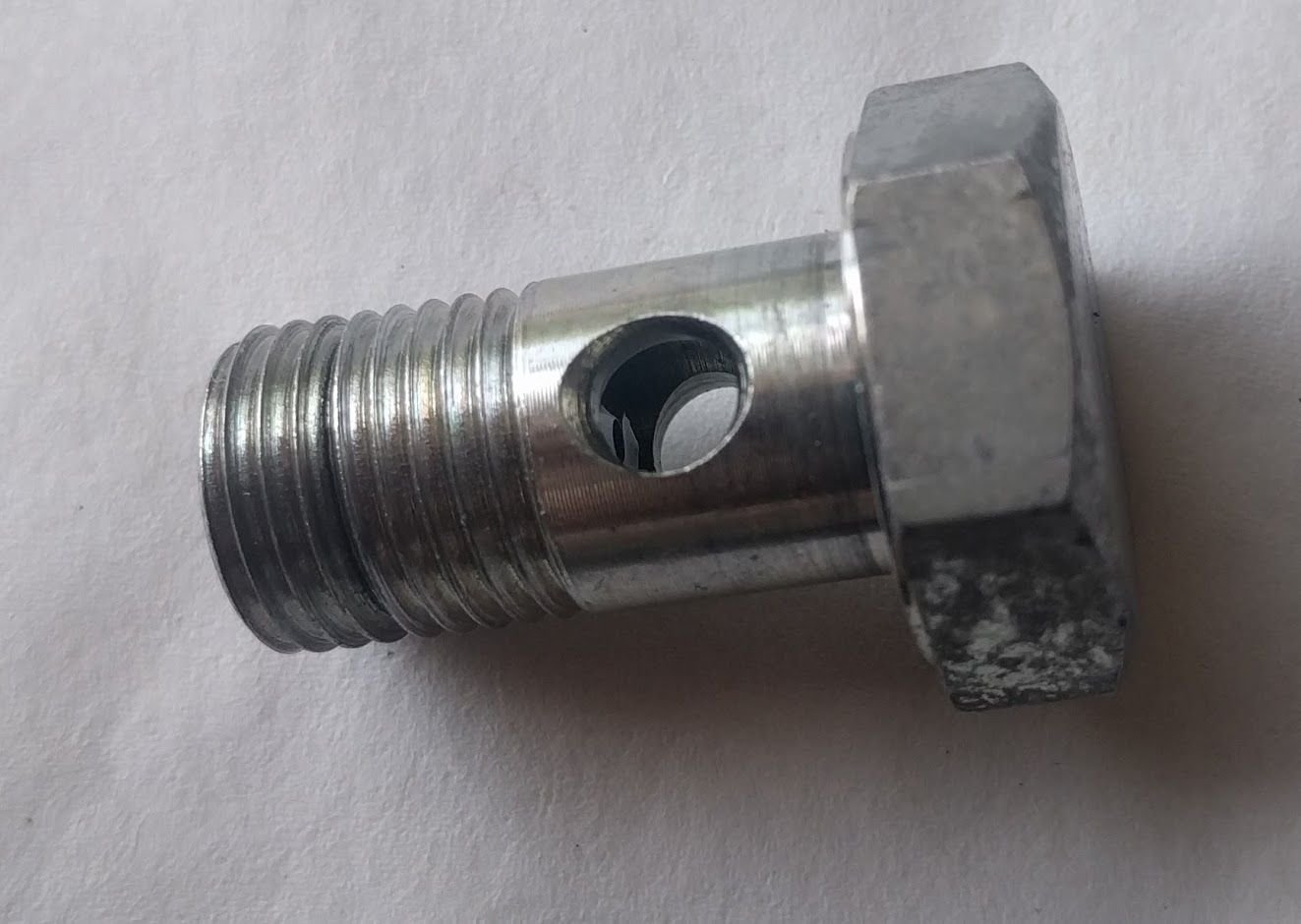

Evo 9 Mivec Banjo bolt cracked
I'm wondering if anyone else has had this happen to them. This is the second Mitsubishi Evo Mivec Banjo bolt that has cracked on me. They go on fine and when I remove them they are cracked. I can see the wall is super thin and I only tq them to 20 ft-in per. The manual says 22.
I don't think it will fail, but it's concerning.

Anyway, the design of banjo's are inherently weak since they are hollow by nature. Im not sure if this is "sound" advice but Im not a fan of using a torque wrench for things like that. Internal engine parts sure, lug nuts sure, but something like that with crush washers I just snug them until I feel the washer compress. 20 in/lb is nothing so I hope you've been using a 1/4" in/lb unit and even then I forget the rule but torque wrenches arent very accurate on the bottom 30% or something like that. And of course if you have a crappy wrench or it hasnt been calibrated recently then all bets are off.

I would use a tap on the threads you are trying to thread in to. It looks as if the female thread is a bit "aggressive." There may be 1 thread in there causing the damage. Especially if you have done this to more then one bolt. Just my 2 cents.
PS. If you do use a tap, make sure to go slow and take your time. You dont want any chips making its way into the line.

What are you seeing on those threads that I am missing? I see the crack but other than that nothing is really jumping out at me...its not a bad idea regardless to clean up threads but a tap is not the right tool for the job. Taps are for cutting new threads so if you are looking to "clean" them up a thread chaser aka a thread restorer is where it's at.

do not tap it. use a thread chaser. thread chasers are used to accurately clean up threads. keep using the torque wrench also.
