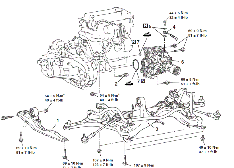

your talking about t-case
the front diff is tcase right?

^^^You are correct!
I see you joined in May & are now posting up Glad to have you join us here on EVOM
Let us know if you have further questions
Heres what it looks like FYI (item 6) (EVO 9 version w/ACD)

The front differential is inside the tcase. If you launch car wrong, it can cause quite a bit of damage if it explodes. If you're lucky it'll just break and not take out anything else. There is also the factor that a bad launch can hurt the ring and pinion gears of the tcase.
