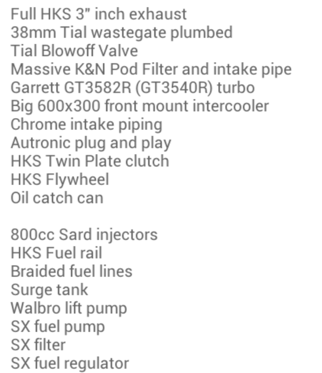

below are a quick snippet of the mods, car is also tuned to just under 400hp
