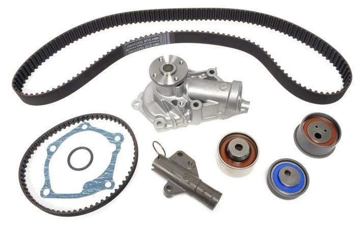

so. here i am. almost time for a timing belt service and im wondering if i should pull the head and inspect it at the same time also a head-gasket job ? is there a such thing like full block refresh ? ( its rather common with rotary's )
planning on sending the stock injectors out to have it test/clean and install a new fuel pump with new lines/rings/grommets
i am going to order these from STM
also this for the timing service
what are the other " while im in there i should probably take a look at " thing to do thats not going to keep driving up the already costly parts list?

Don't touch the head unless you have to. Do a compression and leak-down test. If it all passes, don't touch the head.
Do the timing belt. Make sure you use someone that TRULY knows 4G63's as it's easy to mess up if you don't know what you are doing.

so the reason i wanted to pull the head and refresh it is because i DID do a compression test and the results were more or less, "meh" 10 psi difference in cylinder 2 compare to the rest, so i went ahead and did a leak-down test to see why.
cylinder 2 does have a 40% leak while the rest 3 remained within spec per service manual. i can hear the leak slightly coming out of the exhaust.

right up top ^ and yes of course i will do my due diligent on research for the right shop if i think i wont be able to handle it.
