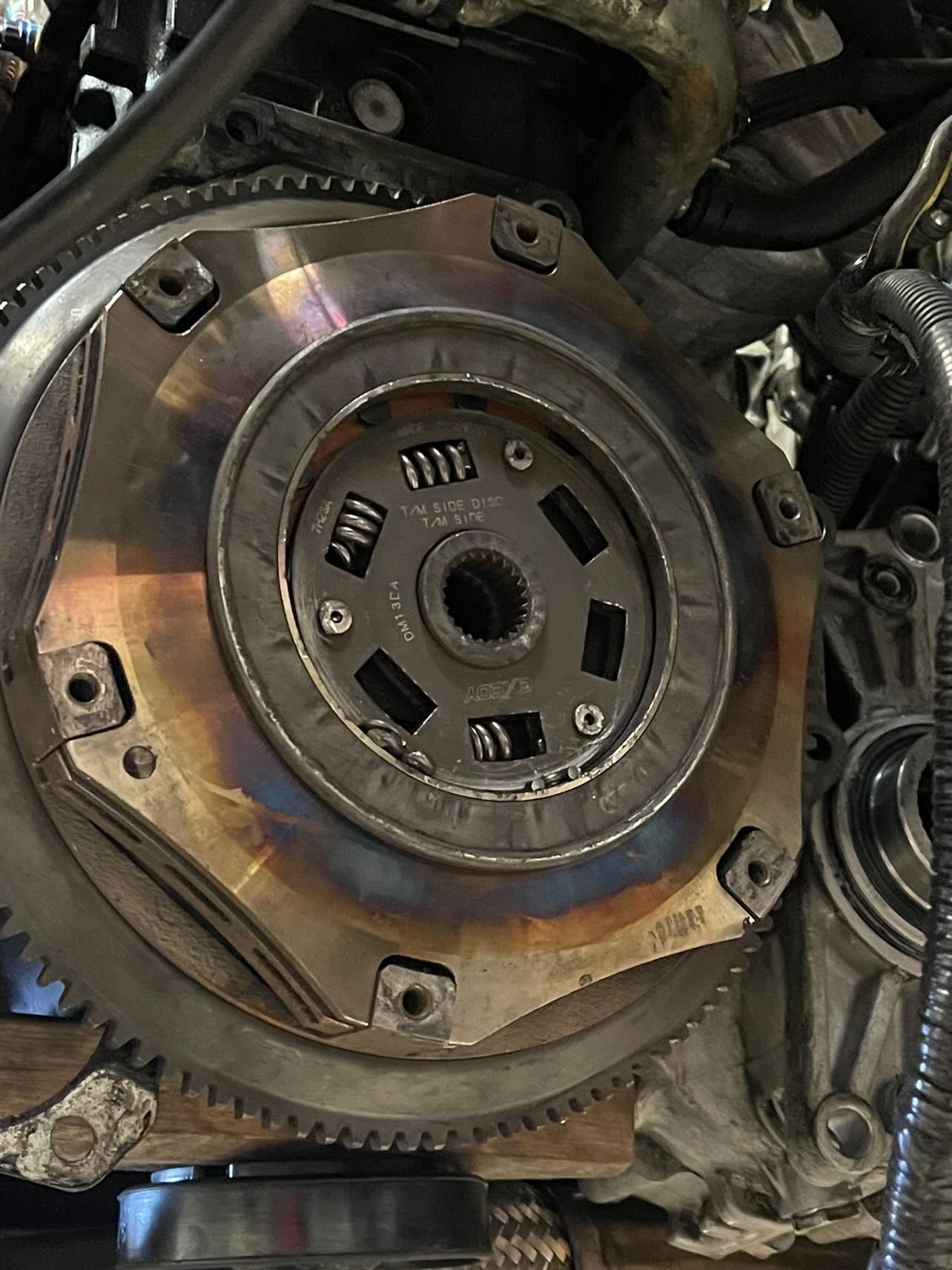

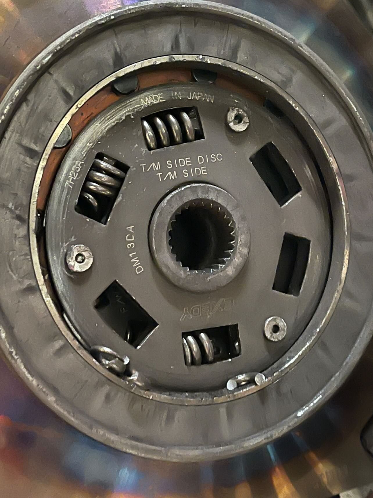

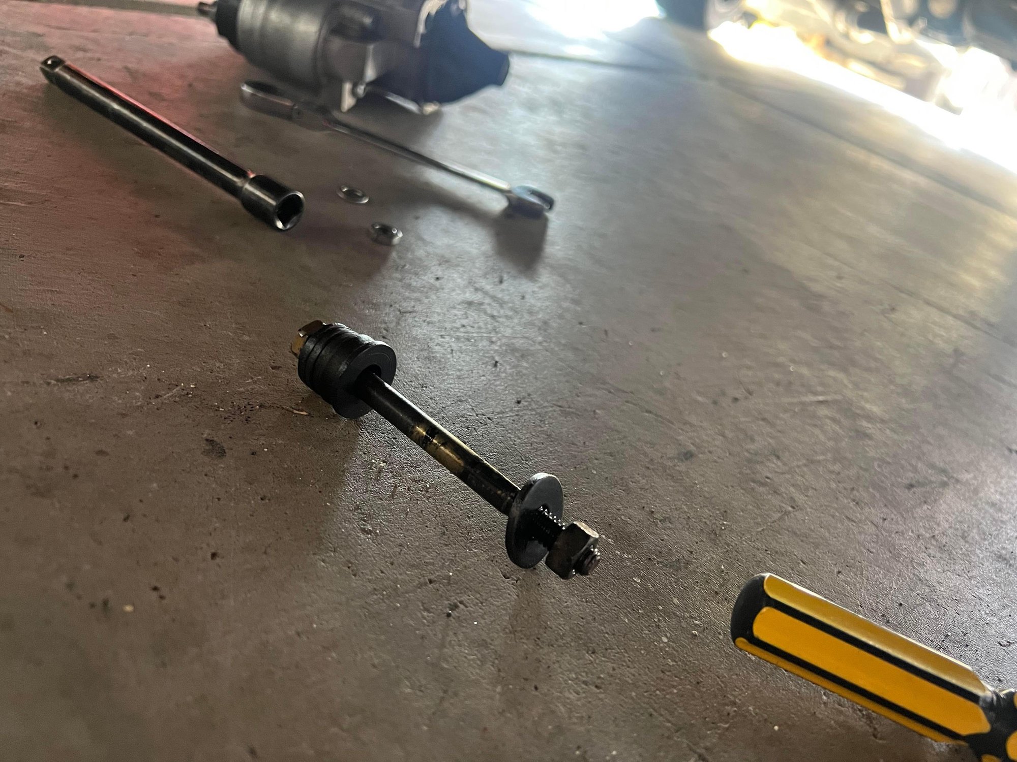

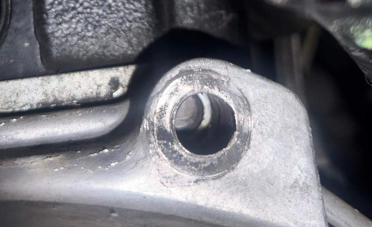

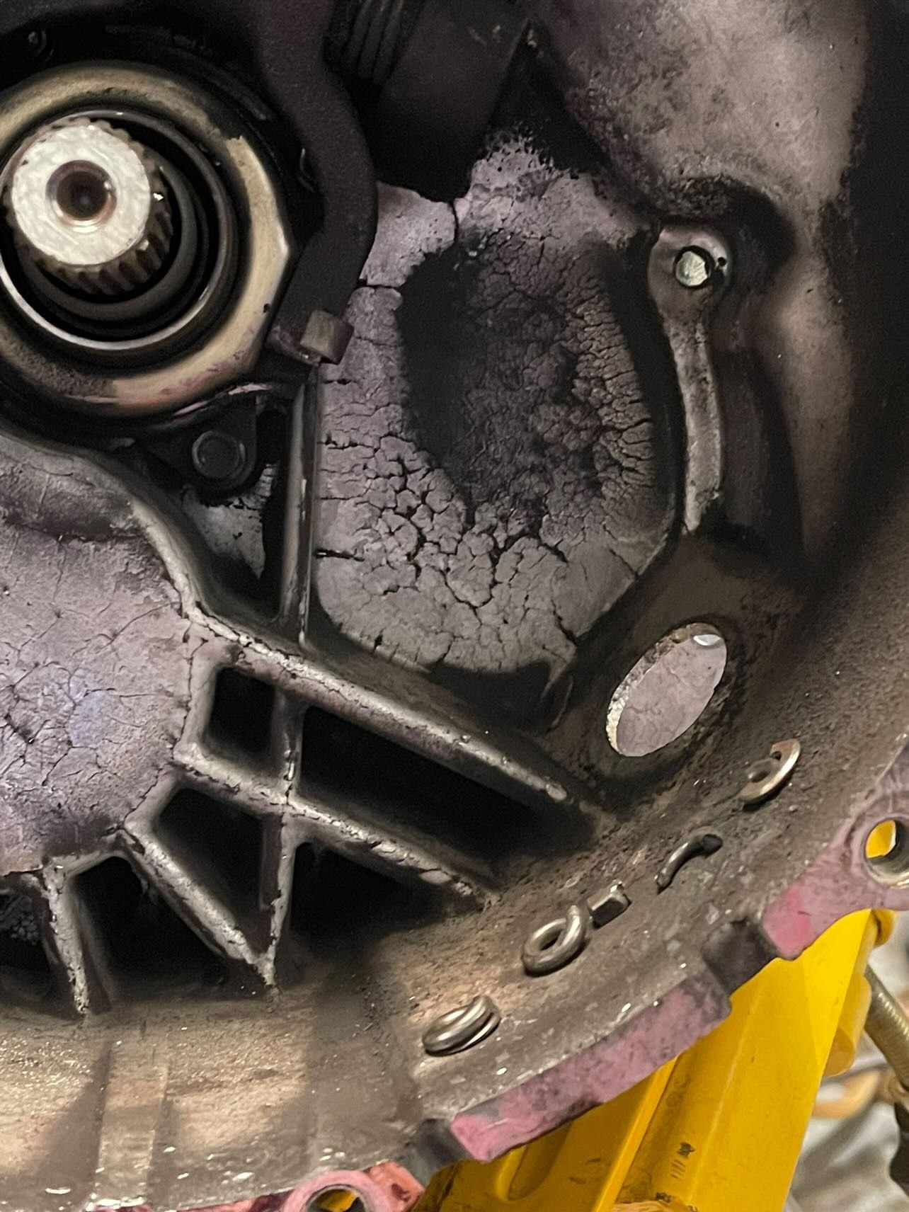

Hello guys ,

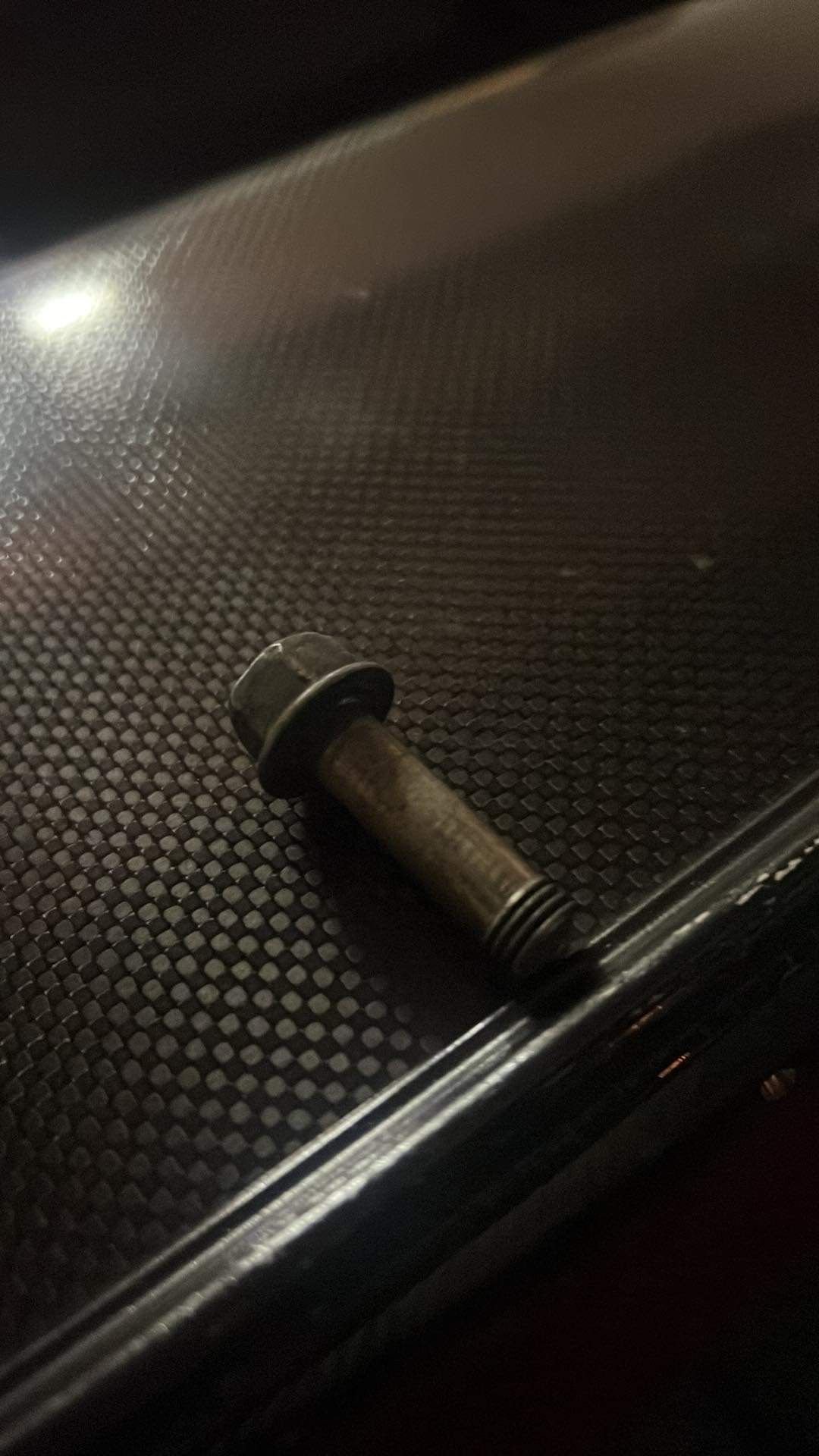

just wanted to share my experience with this vibrating clutch pedal that i was having. Symptoms i was having was the engine tilting downwards towards the trans, wont go into gear, vibrating pedal all the time while the engine is running, and loss of clutch pedal pressure (spongy feeling as well). Found out that i only had two bolts holding the trans to the engine and a sketchy improvised bolt with a couple washers to hold it on. I also found one of the trans to engine bolt (broken) sitting on top of the trans. This was the one that was sitting right beneath thermostat housing. Here’s a few pics of what the loose trans did to exedy twin hd clutch.

Thanks for sharing this info! By the way I found that those bolts tends to rust a lot faster so its worth to check them from time to time. I already lost two of them.

Yes thats what i heard too. Im glad i dont live on the rust belt. This is the bolt that i found

hmm nasty. my exedy (stage2?) look worse than that what it exploded though. IIRC it was some rivets gave out. no broken springs, just fallen off lol
lol that sucks , doesnt help having to drop another 1800 on a twin disc lol
