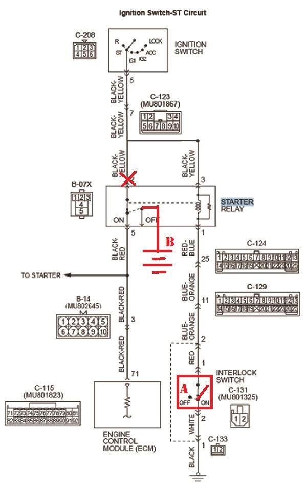

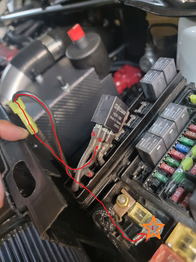

try supplying batt voltage to the starter wire, basically bypassing the ignition and fuses/relay. what does your starter relay look like? on my evo9, pin 5 of this relay is to the starter (just as an example since yours might be very different)
or just use a new wire to the starter
if it cranks fast(faster than normal) then you could have switching issues

right, so its similar. on my car that 12v supply to the relay is weak after passing thru all the old connections, ignition switch etc. thats why I rewired my relay in that pic

on ours the relay is really not a relay its just to require you to step on the clutch to start
so screw that
