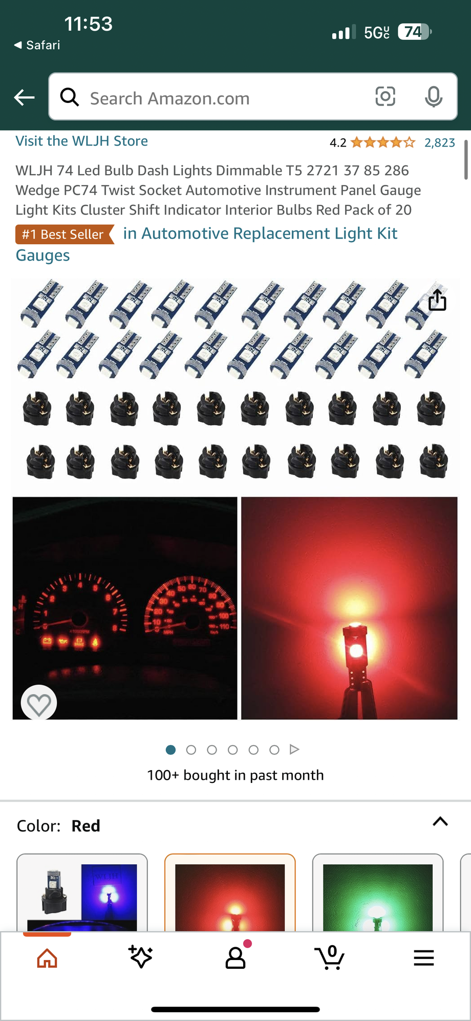

I bought these for anything that is red, and the three back lit sockets. :
Amazon Amazon

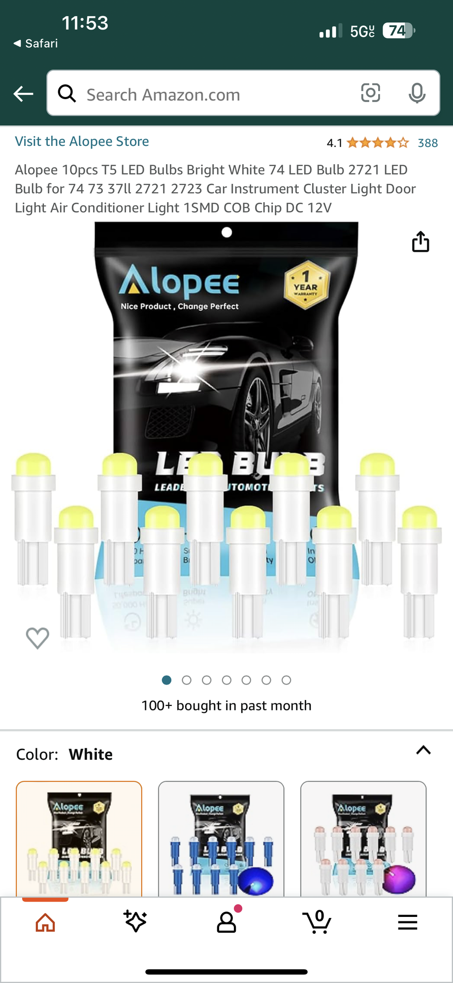

and then I bought these :
http://www.amazon.com/dp/B016FKOGQW?...ob_ap_share%0A
and used the extra sockets from the pack above for turn signals, headlight/fog light and such.

when I click them, they take me to the item. My fault but here’s a screen shot. Mind you, as of right now they do not dim. But they aren’t overly bright where I need to lower it at night.

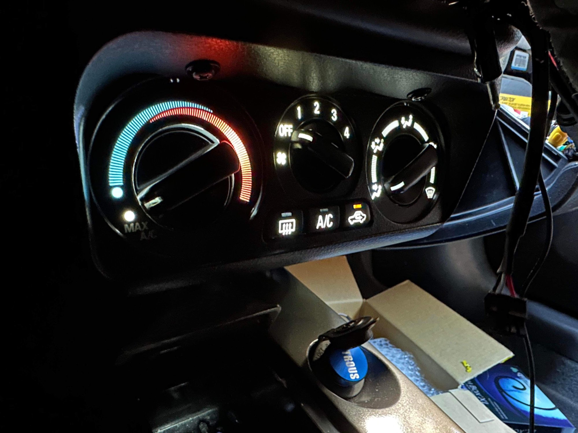

Update, my climate lights I changed to the white bulbs but they are not lighting up along with the ash tray light. The dimmer switch may not be the problem. I will check for fuses for those. Cluster is still very bright and looks great.

updated that Dimmer does work. I had a short at the hvac which was blowing the fuse at the engine fuse box. Have to replace hvac now but they do work for each light.

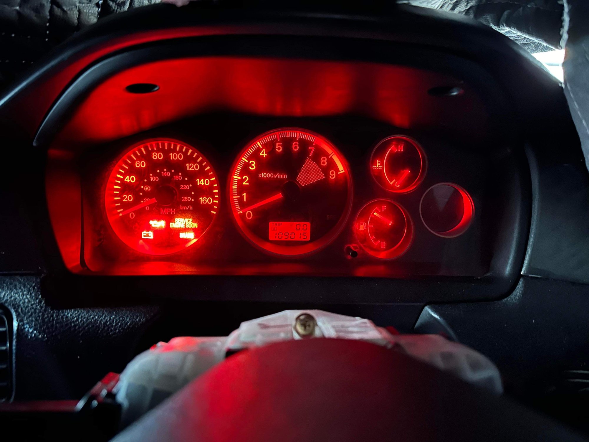

So everything is dimmable, these are at the highest setting. My camera might be making them seem brighter then they are but I can see the cluster in the day time for reference.
