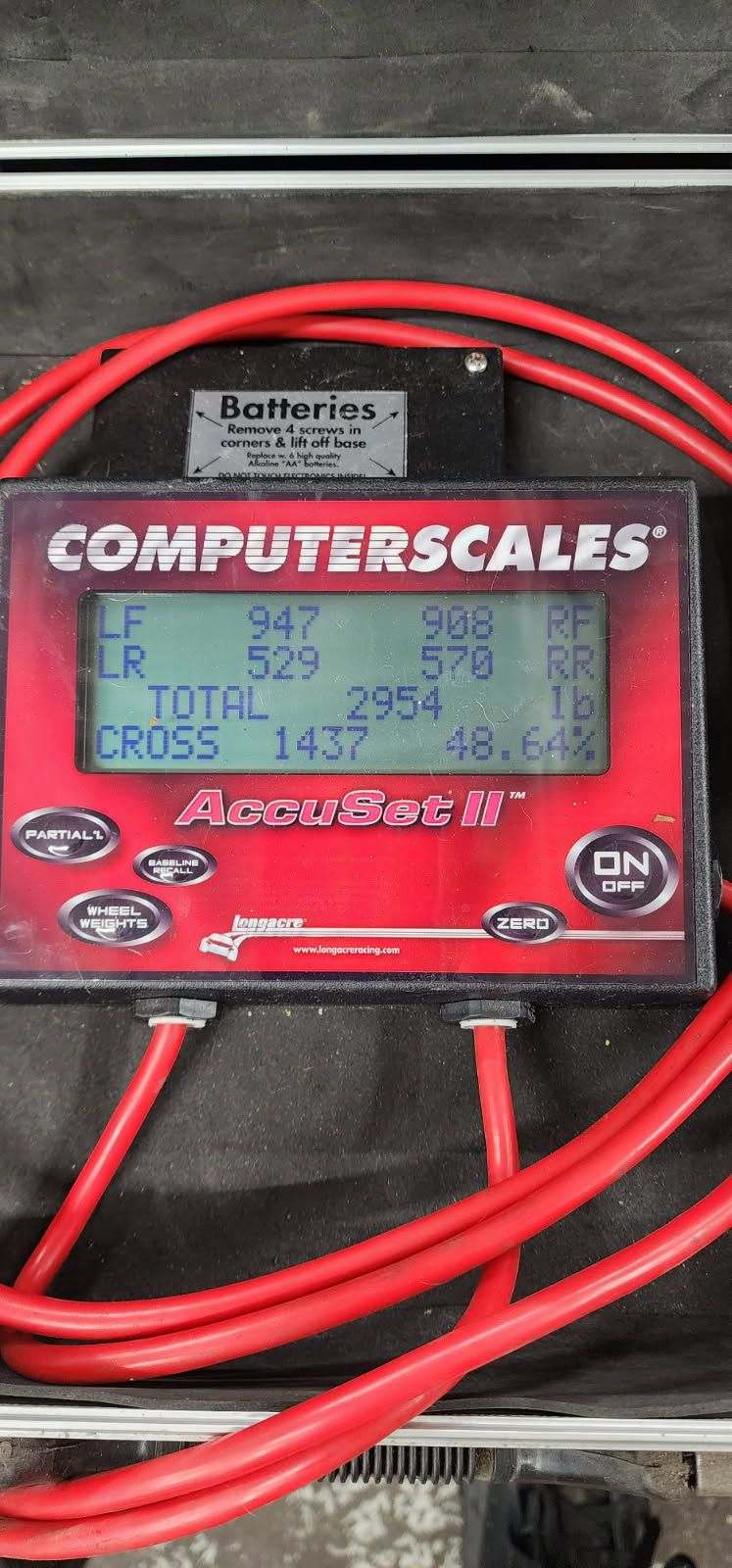

Well getting ready to go to the alignment and we had it on the scales.
5 gallons of fuel in the tank, with a full tank car will be 3050 with all fluids and full tank of pump gas.
So officially my car weighs with all fluids but no gas 2922 lbs, with full tank of 93 3017 lbs, with e85 3010 oh and i still need to put on my front center member which loses another 8.7 lbs so in total with 93 3008, and with e85 3001 lbs and this is with full interior still. I never thought id get it that light for a street car.

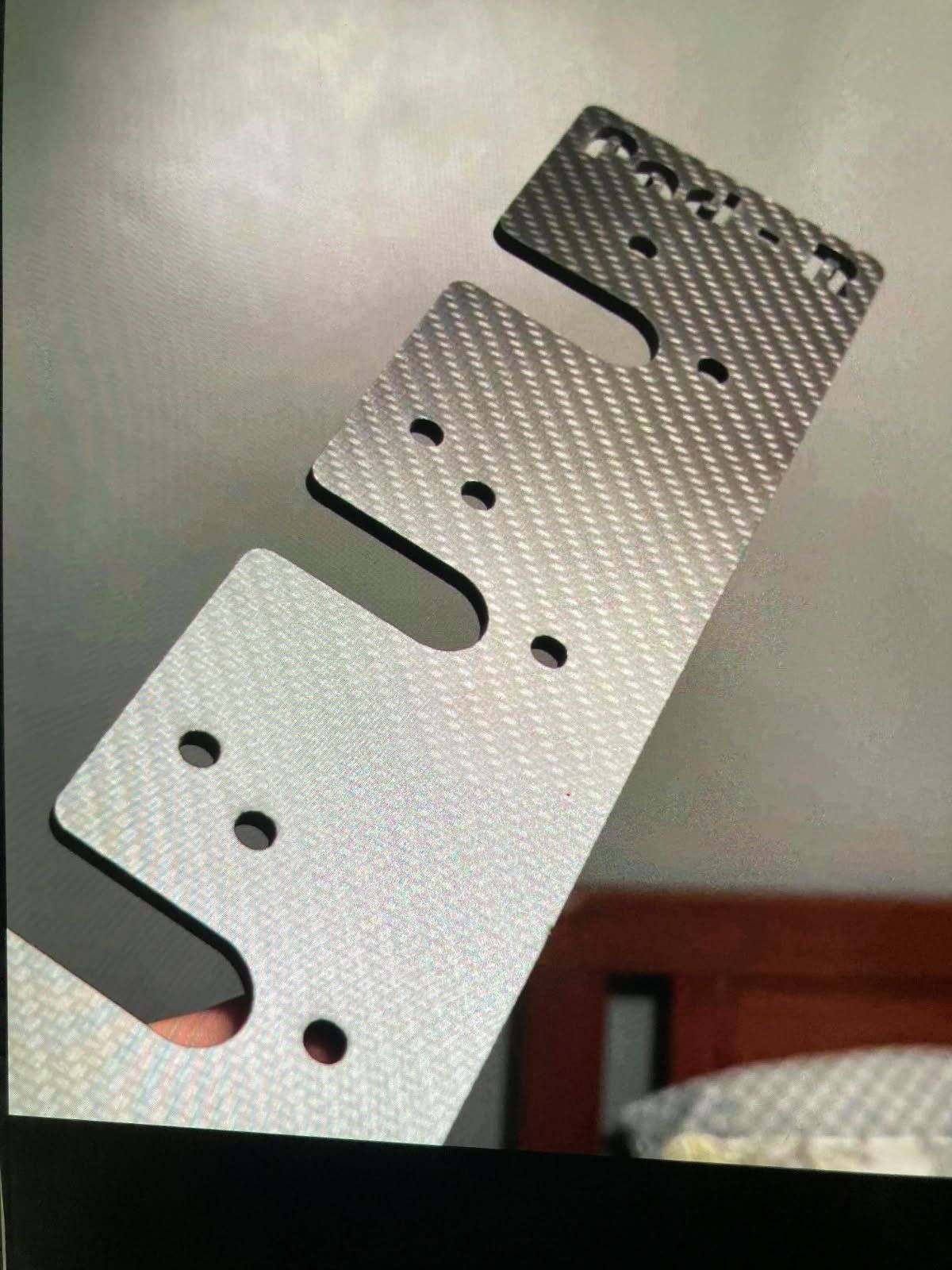

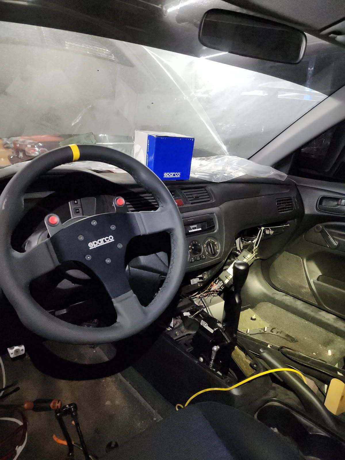

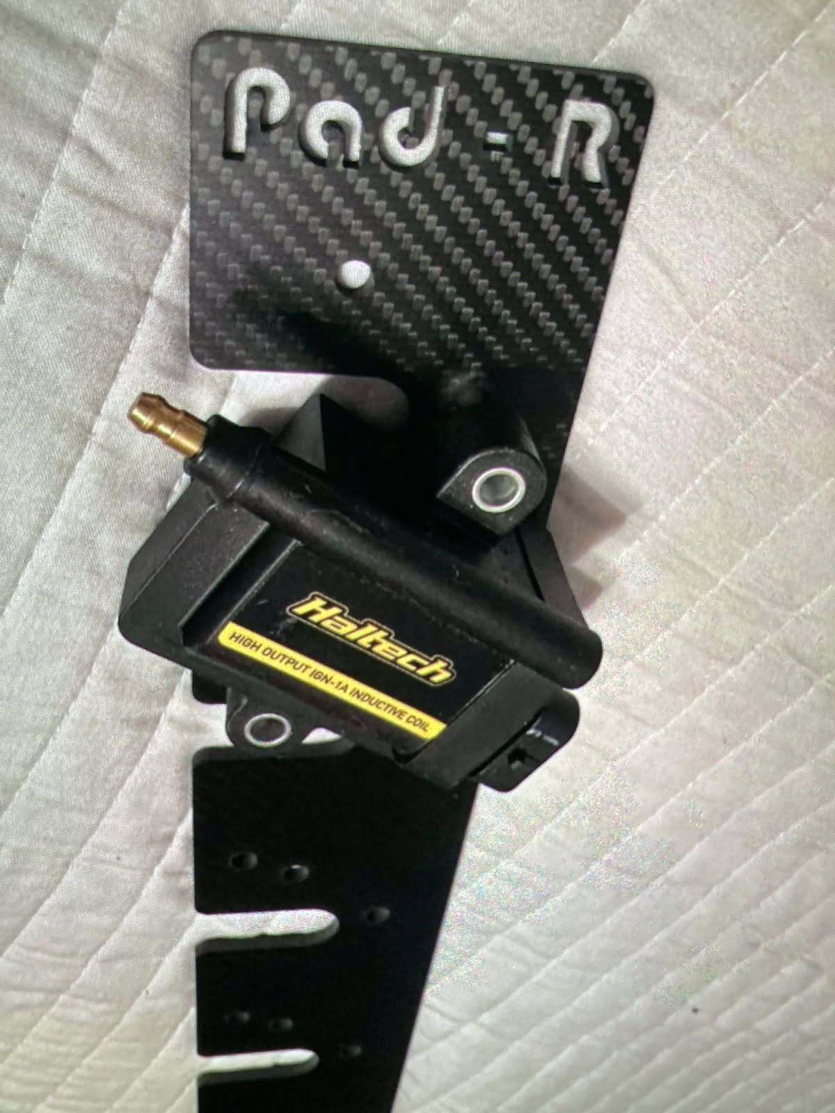

Well it is almost done. Pic from today, we installed my shifter and get the coolant all blead and made sure there wasn't any leaks. Shifter is up higher and I am thinking about lowering brackets for the seats but we will see. I am going to order a cable assy for my steering wheel from motion race works that will work great with my steering wheel.. I should have that in a few days. I also ordered a billet valve cover. I went with the Hypertune , and with the ign-1a coils I had to get a new bracket so I got this one from Brandon at Buschurs (shout out for ya dude) for hooking me up with a guy who makes brackets for the Hypertune valve covers.
Pics of the new bracket.

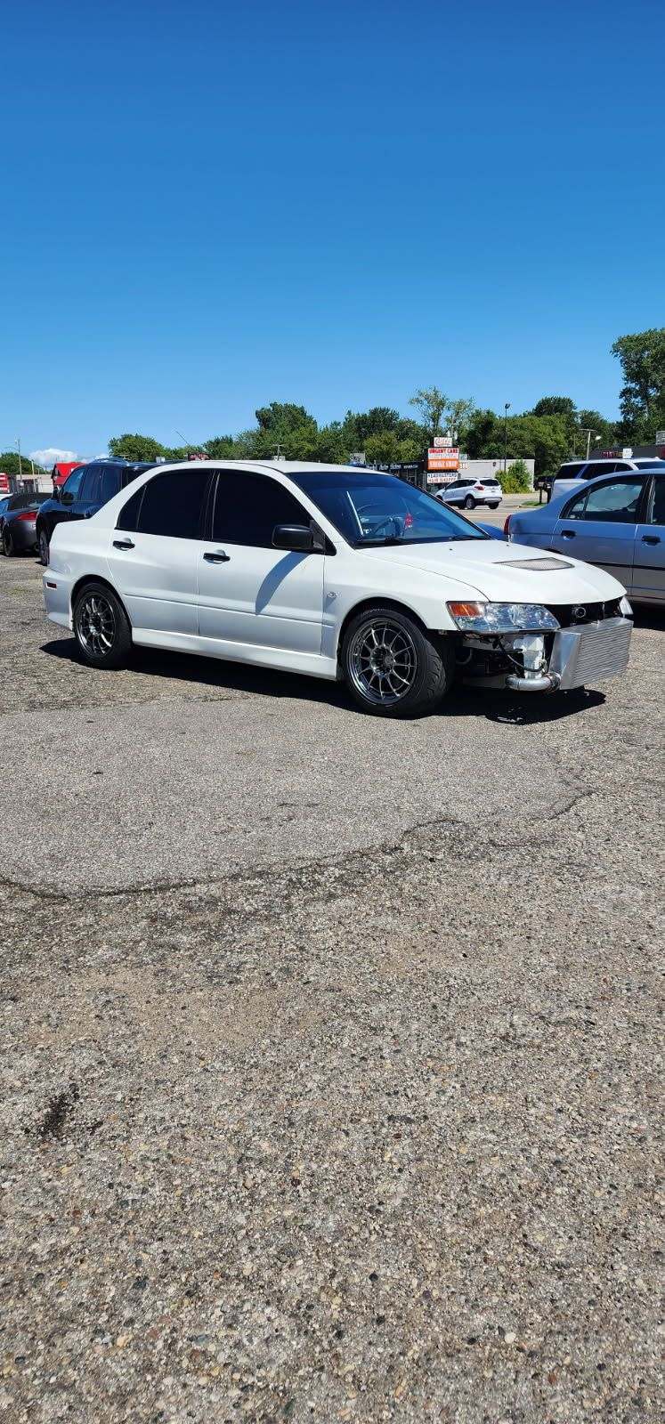

So I have some updates. I have been awake now for about 30 hrs straight and my tuner got a bunch of work done on my evo last nite. He got my suspension all locked up and strung, set preloads, reset ride height, restrung it after he did the 4 corner and noticed one side was 3mm off in the rear. So he fixed that put it back on the scales and re cornered it and all set to go to the alignment this am.
Well that didn't go as planned. He started the car it ran for about 30 seconds and died. Tried to restart and no start. He noticed on the IC-7 no fuel pressure. Great fuel pump dead in the water. He went in the Haltech and swapped over my secondary pump to primary and car fired right up. He let it idle for a few seconds and started to pull it off the rack and bam car died again.
Ok now starting to get pissed. Find out oil pressure was at 0 and the safety kicked in and killed the engine. Well long story short easy fix right? I have my oil pressure on my oil filter housing cause it was a late addition years ago and now it bites me. Find out he broke the sensor somehow due to vibration being on oil filter housing. Ok quick fix we had a spare sensor.
He takes the car for a short test drive to test the alignment out before it goes it to get fully aligned and gets back to the shop after driving it a mile or so up the road and car died yet again with 0 oil pressure. Sure as **** same thing happened. Ok got this we rigged up some spare parts and made a line that goes to the fire wall to fix that problem.
Ok so we are golden right? Wrong! on the way to the alignment he notices a weird noise but cannot pinpoint where its coming from. Great just what I need more broken stuff. Yep sure enough I have a wheel bearing going bad. Then when things cant get any worse they get it off the alignment rack and find out theres more then one. So now 4 new wheel bearings on the way.

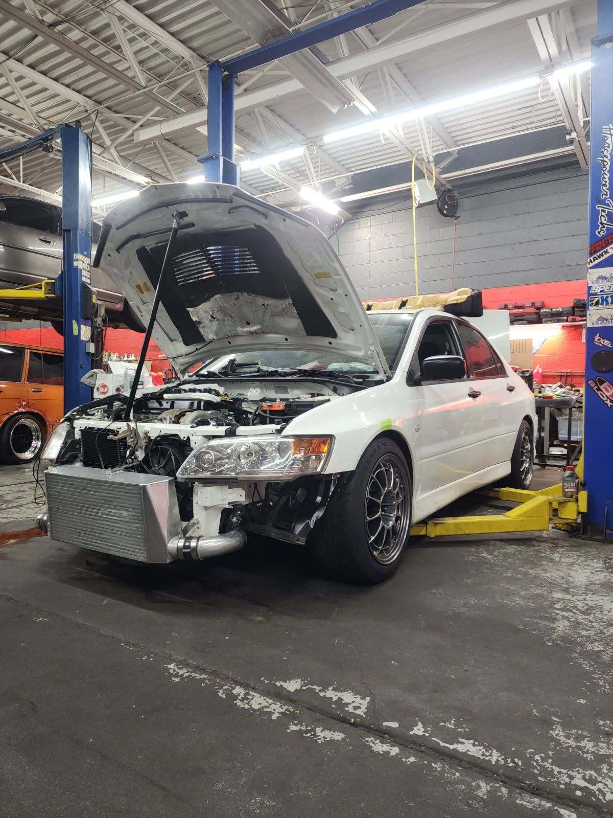

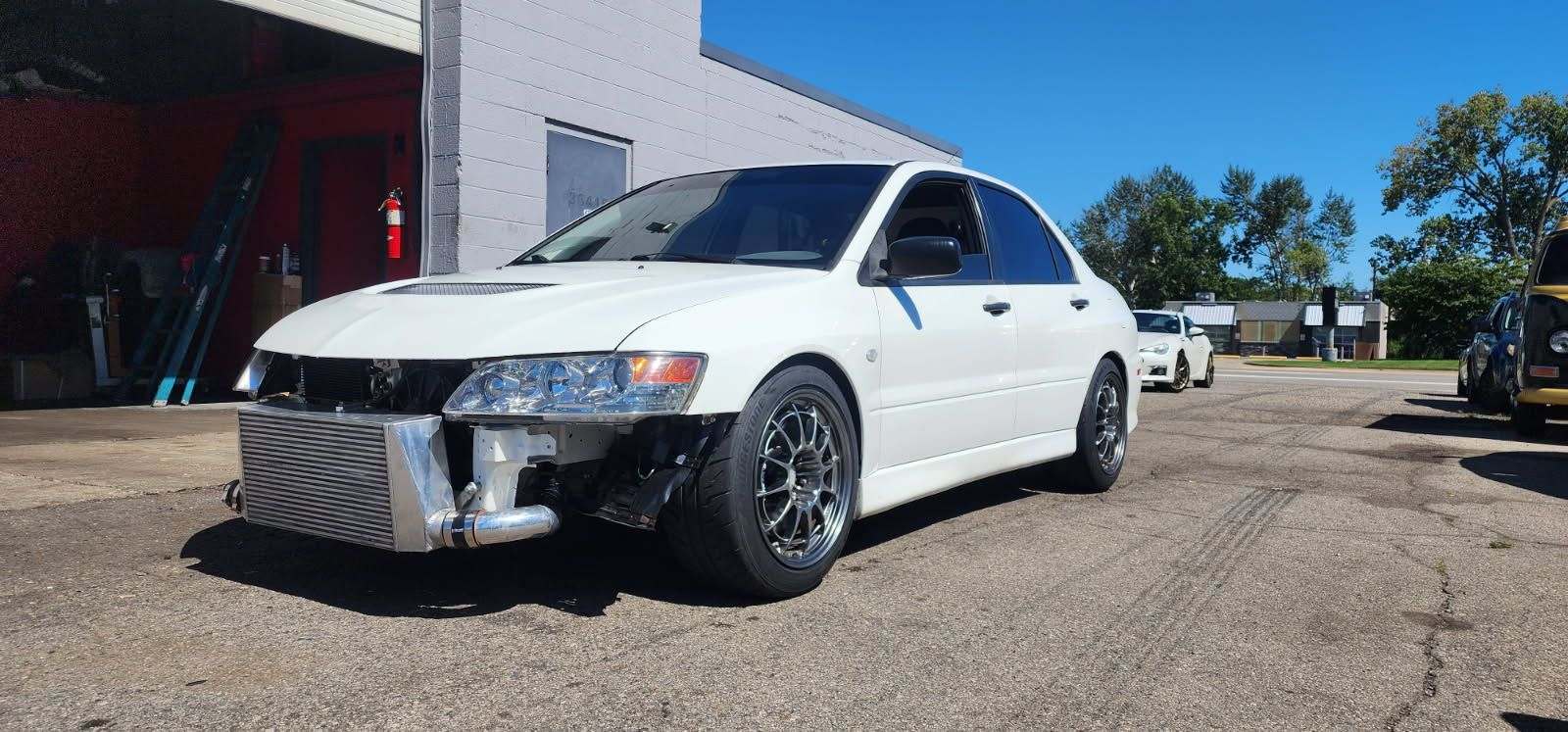

All of this just so happens in the last 30 hrs or so. Ok so now for the good news right? Well there isn't any but I got pics for all of you to enjoy, so without further ado, thank you for reading my misfortune of the last 30 hrs or so.
Here is a pic of the car last nite or this am, nope this am 2:35am. Done with the alignment and setting rake
This pic is just after it was done at the alignment shop
This one is all cleaned up at the shop 20 mins after I hung up the phone with my tuner in the 30th hr.

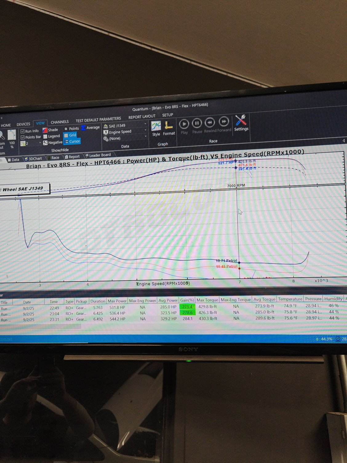

Well I wanted to let everyone know that the car is on the dyno and making jam. We have had a long few days now and we finally got the car running good. We had to fix my wg pressure we went down from 25 lb springs to 17 and the car is much happier now. We also killed an ign-1a coil and thankfully I have 2 extras.
So starting out at roughly 23 lbs with single digit timing moving up to a normal timing map or what it should look like car made 531/429 on pump gas. So after a few pulls and trying to lean the map out he took a lb of boost away got the afrs in the high 10s to 11.0 up top and at 22 lbs it's making 544/430. Needless to say we may go up another few lbs of boost or he said something about 32 max but this cars a monster so far.
Sorry so small hea working on the map still and hasn't made the graph larger yet. Idk if I'll make e85 tonite or not but shootout is in 2 days for me and I'm suppose to pick up the car later today being it's after midnite already.
