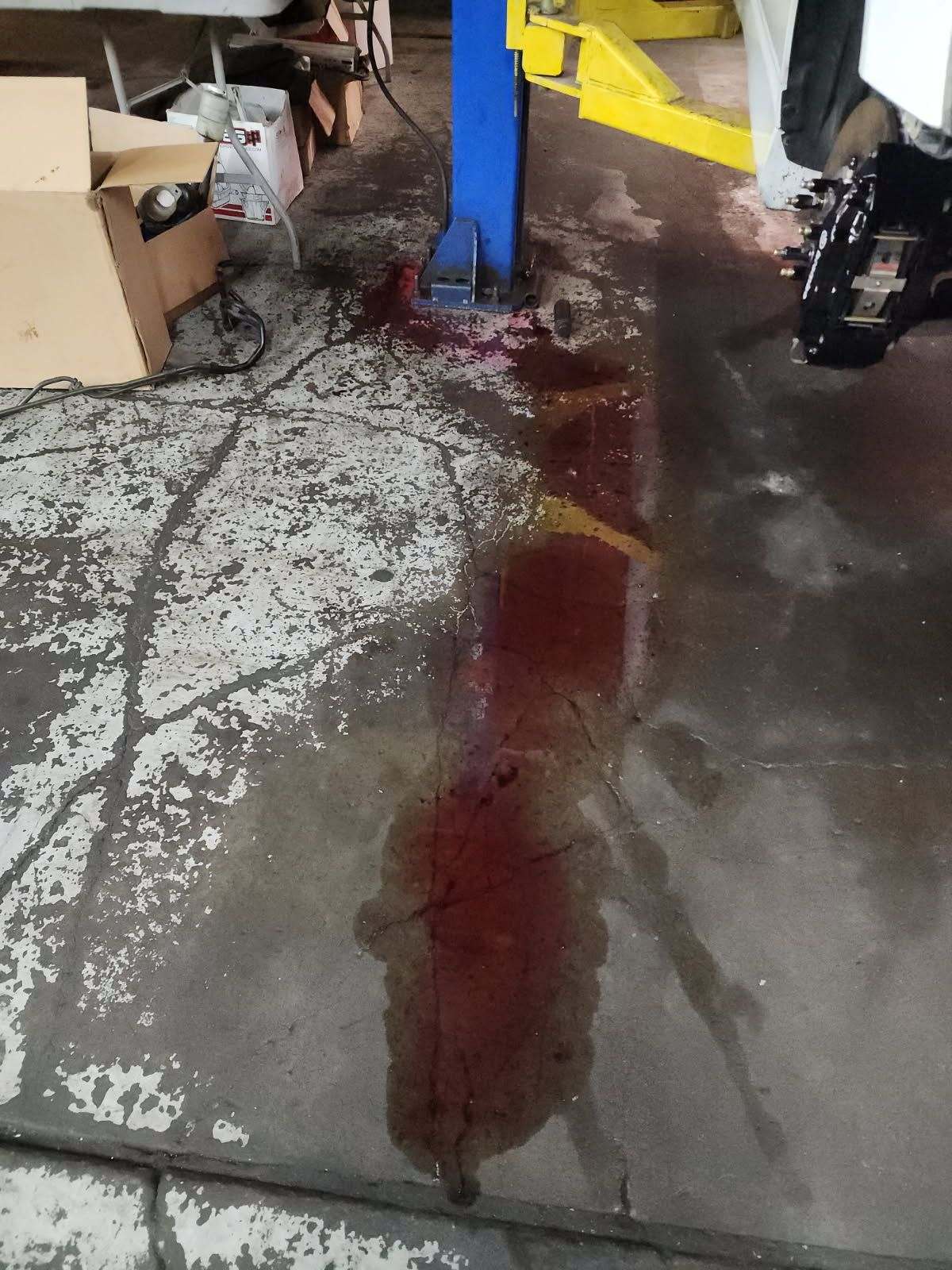

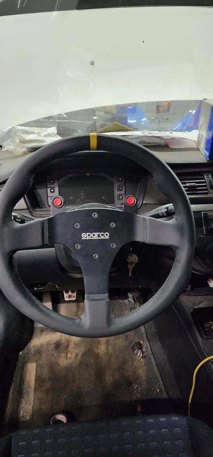

Well I haven't had much to post about here in a while but I have something to post. My new steering wheel is in and maybe today the shifter and fluids will be put in and the car should start. I am looing for a option to put my buttons on a deutsch connector so it would be easy on and easy off and all in one. Motion raceworks makes a nice kit but I would have to modify it to possibly get it to work. Problem is its 175 bucks for a connector, bracket and some pins so idk. One button will be my anti lag and the other idk what I will use it for. I don't run no2 on the car so I can't use it for that. And with no gf anymore no eject-o seat needed lol. I ordered the 2 button being it was cheaper for whatever reason then the single button. Idk I am sure I will think of something.

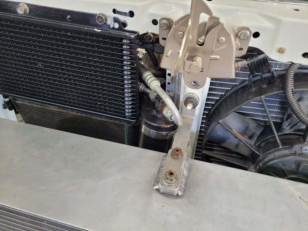

As for the car it just needs fluid for the rear end, I am swapping out my trans fluid going back to Schaeffers 75w90 from 140, and new t case fluid which will be Motol 75w140 just like the rear end. All my new power steering cooler and oil cooler was moved to the front of the car and plumbed up, found my injector pigtails for my 2600s those will be wired in today I have 5 gallons of fresh 93 to work out all the kinks and get a 93 tune in and hopfully this thing will actually get tuned.
Funny pic
You know your cars been on the lift to long when it starts puking oil.
Using the unused space for oil and power steering coolers. Oh yeah can we say ac is back yay.
