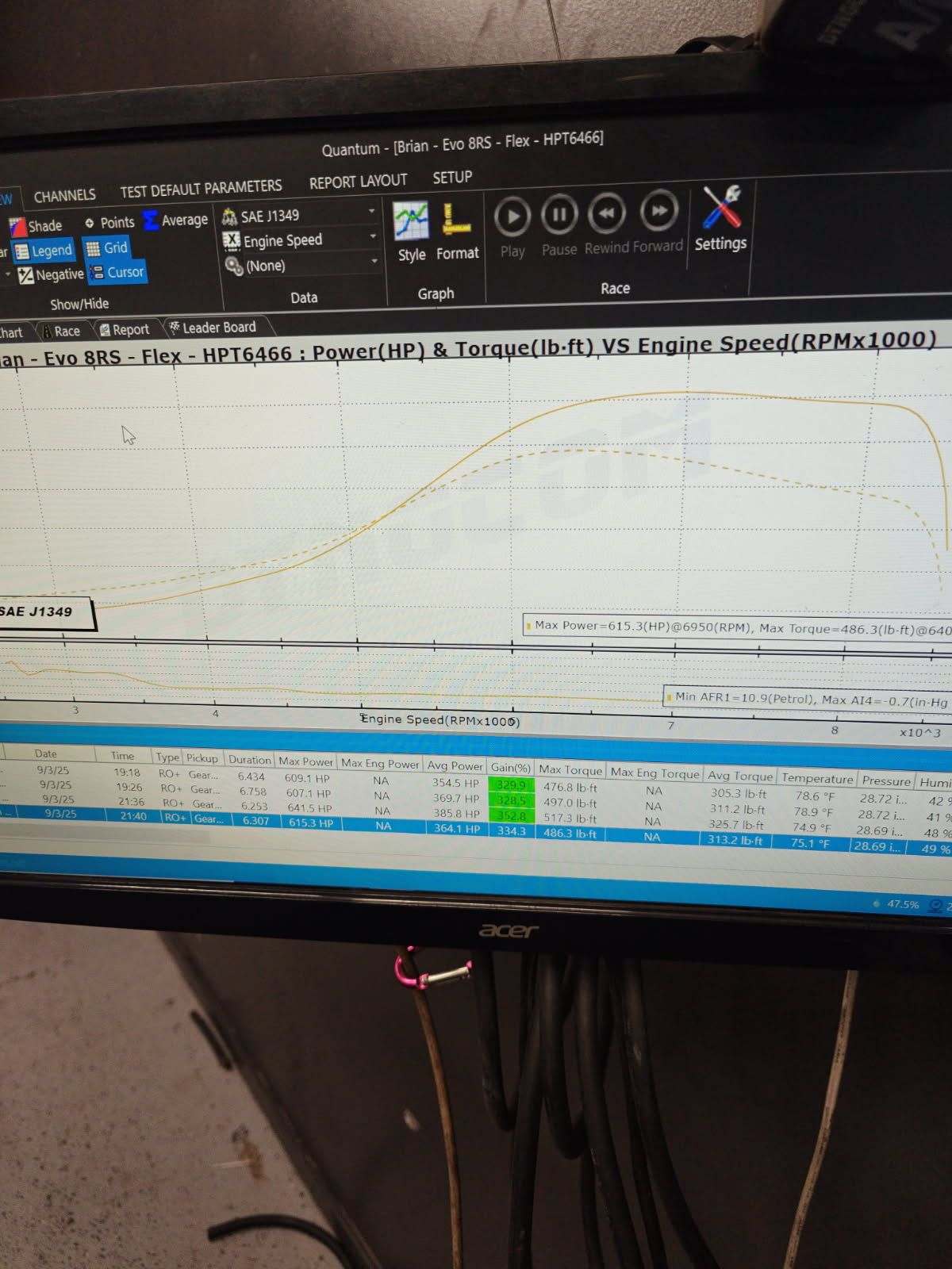

So drive out to the shop and look at the car on the dyno as my tuner wants to turn it up past 22 lbs on just pump gas. Ok great sure yeah lets roll excited. So car goes up to 25 psi and makes 609, cleans up the afr's a little 617, awsome adds more boost gets it running 28 psi car makes 615 very nice, he notices something he didn't like and oops over boosts goes to 32 lbs car makes 641 but he couldn't pin everything to make it safe and good to go, the octaine just wasn't there. Ok fine so we drop back down to 28 psi car sits at 615/486. I am happy with this. So here is how the graph looks
So were all happy and honestly we were trying to make 700 on that dyno and he said if i wasn't in a hurry to get the car home we could have prob made it close. But with all said I am pretty happy with these results.

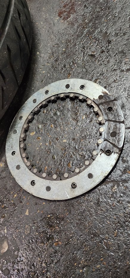

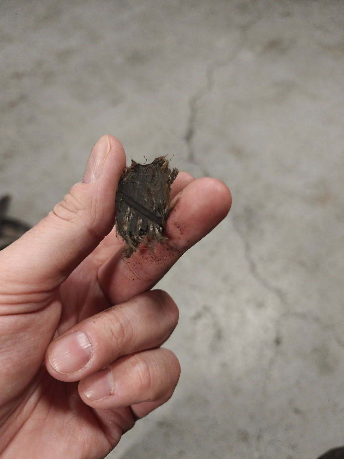

Now its time to take the car off the dyno and just test drive it for afrs during cruise and maybe make a rip to check things out on the street and then something happens trying to back the car off the dyno. Car for whatever reason wont go in gear then it happens. Tuner comes out and says dude we got a problem.. He was like tried to put it in gear and the pedal went to the floor and is acting funny. Ok no problem lets re bleed the clutch just in case. Sure enough a little air in the system and then he feels a funny vibration as he tries to compress the clutch. Ok Huston we have a problem. Yep sure ****ing do.
Day before the ****ing shootout and this happens. Was kinda odd to see being he saw this under the car, then he found another peice and then some more coming out of the inspection hole. Yep sure as **** disc ate itself somehow.. Now these discs are rated 845 crank I am no where near that well I am close but yeah not happy. So after spending my life savings and basically selling my ***** to pay for the ungodly bill to get the car out this happens. Shop is going to try to find a disc in the am and if they can get it I may wait a little bit to head down to Norwalk just to go pick the car up. But getting a ceramic disc same day out there is next to nill . Tuner said if they get it done by friday he will drive it out there for me and i would just have to bring my trailer for the way home. Ikd I can honestly say i am defeted, I am still injured and I am broke.

Yep ACT clutch, organic discs that suppose to hold 845 tq at flywheel. And no i just wanted to have the car to drive since its been over a year. ****ty thing is I had to buy a new clutch being I cannot get discs anywhere in time but i could get a whole new clutch by noon tomorrow so i had to do what i had to do.

Well stm came through. Over nited a new clutch since no one can get me what I need today or over nite. So had to buy a new clutch. I mean what's 2 more grand right. Car will be here at the shootout hopefully tomorrow

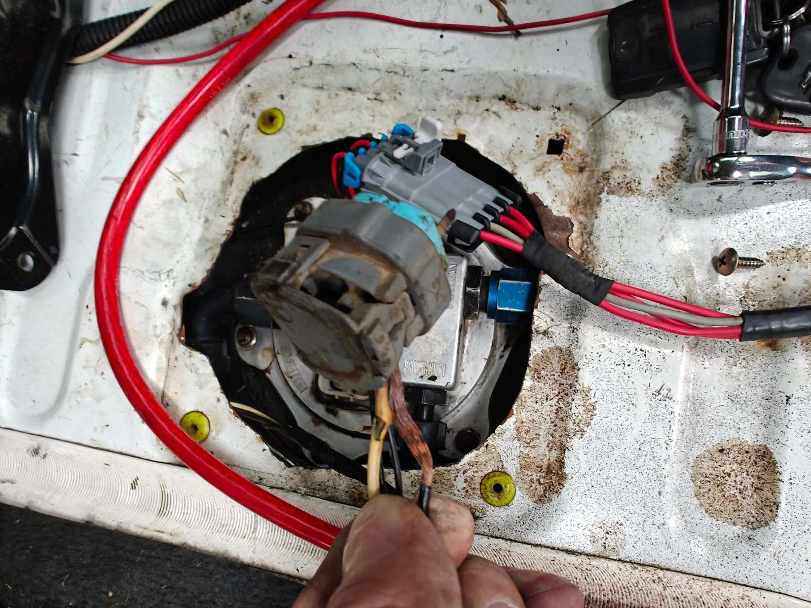

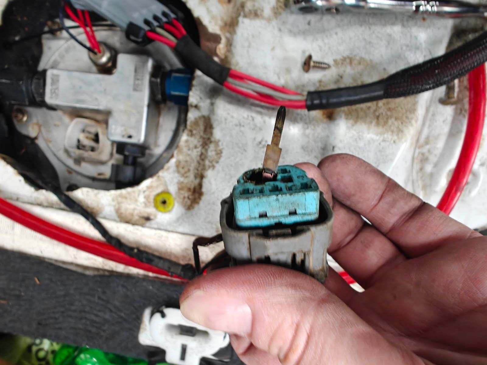

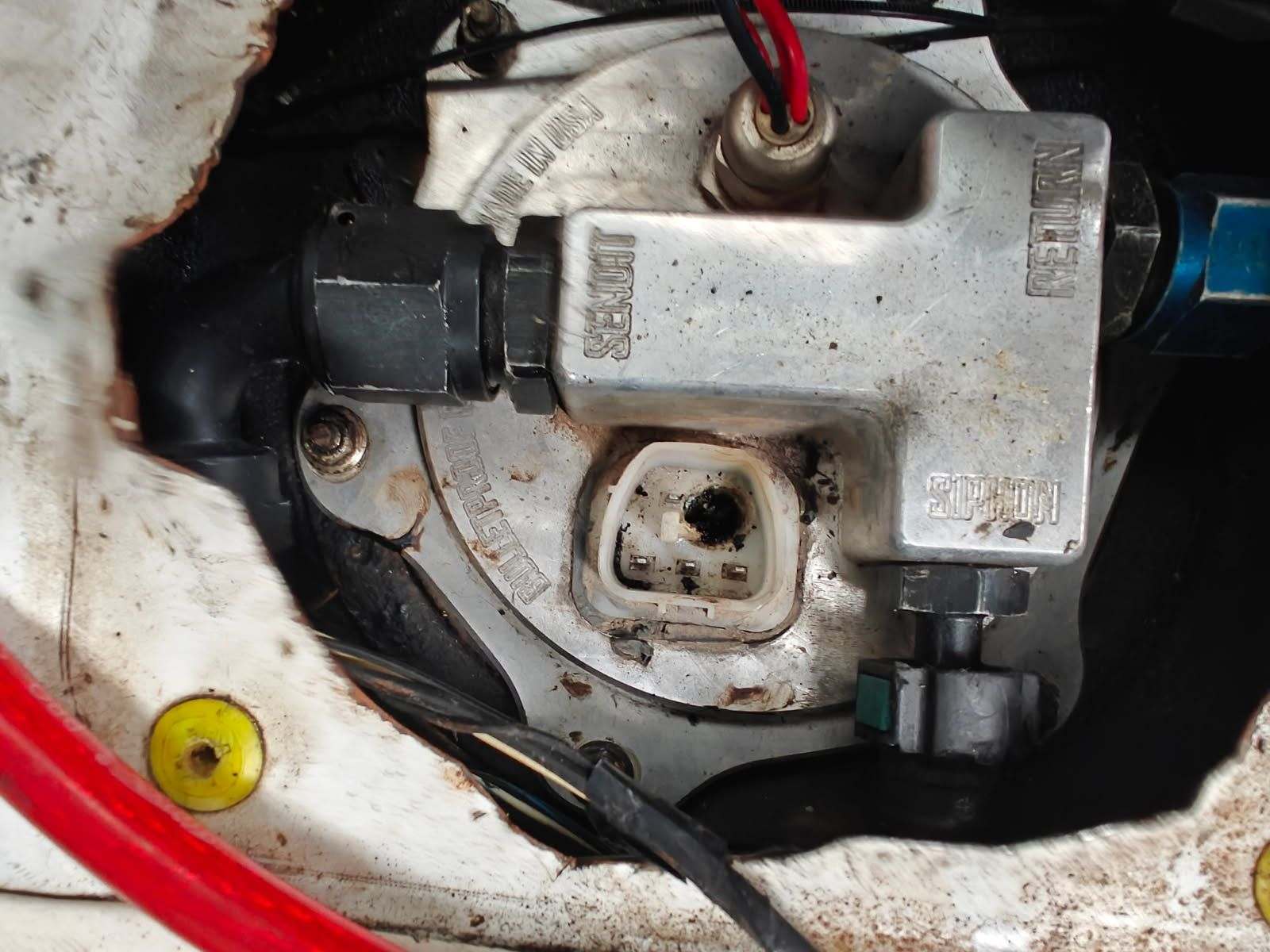

Well I got more good news today check this out. So Apparently this isn't the shops fault, but they were the last ones inside my fuel tank. So if there was something wrong with the wires and or sending unit and no one said anything about this and i look at this today and find this how is this my fault again? Shop denied that there was anything wrong so this means now I have to buy another sending unit and a plug.

Yeah kinda pisses me off. Thankfully my tuner is a good dude and he is doing everything he can to help me. He wants to fix what is wrong here and call it a day, but the plug in end of the sending unit no one sells and bpr will not sell it to me. So in that case Alex (owner of bullproof racing) said he would help me with a new sending unit and add extra grounding to the sending unit being he thinks that was the problem. The thing is and what I am afraid of is the idiot who installed the new pumps cut the plugs out of them and wired them with connectors instead of using the stock stuff. If I find that when I take it apart I am going to come unglued on the guy. I told him not to touch the wiring and he did.
