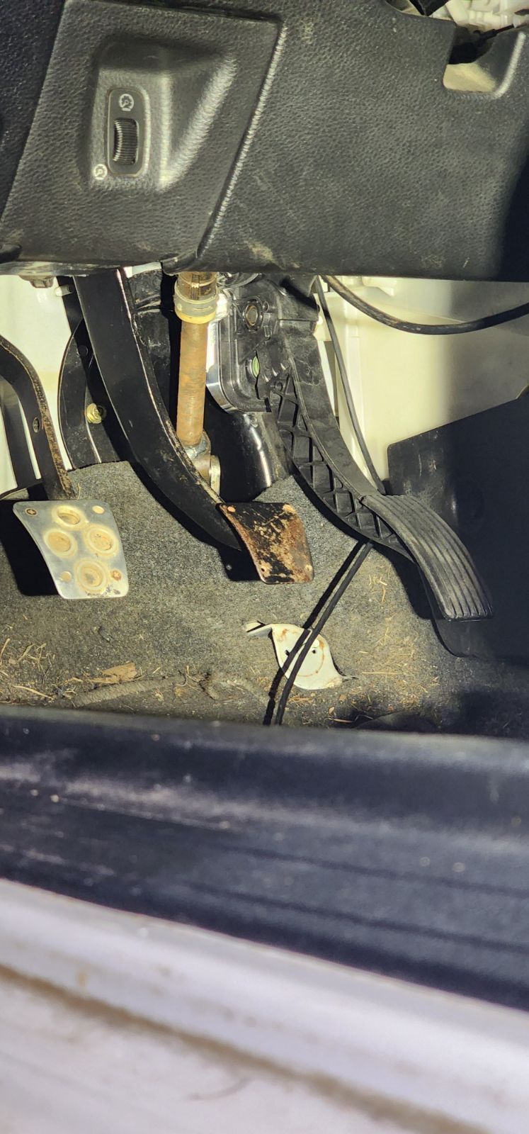

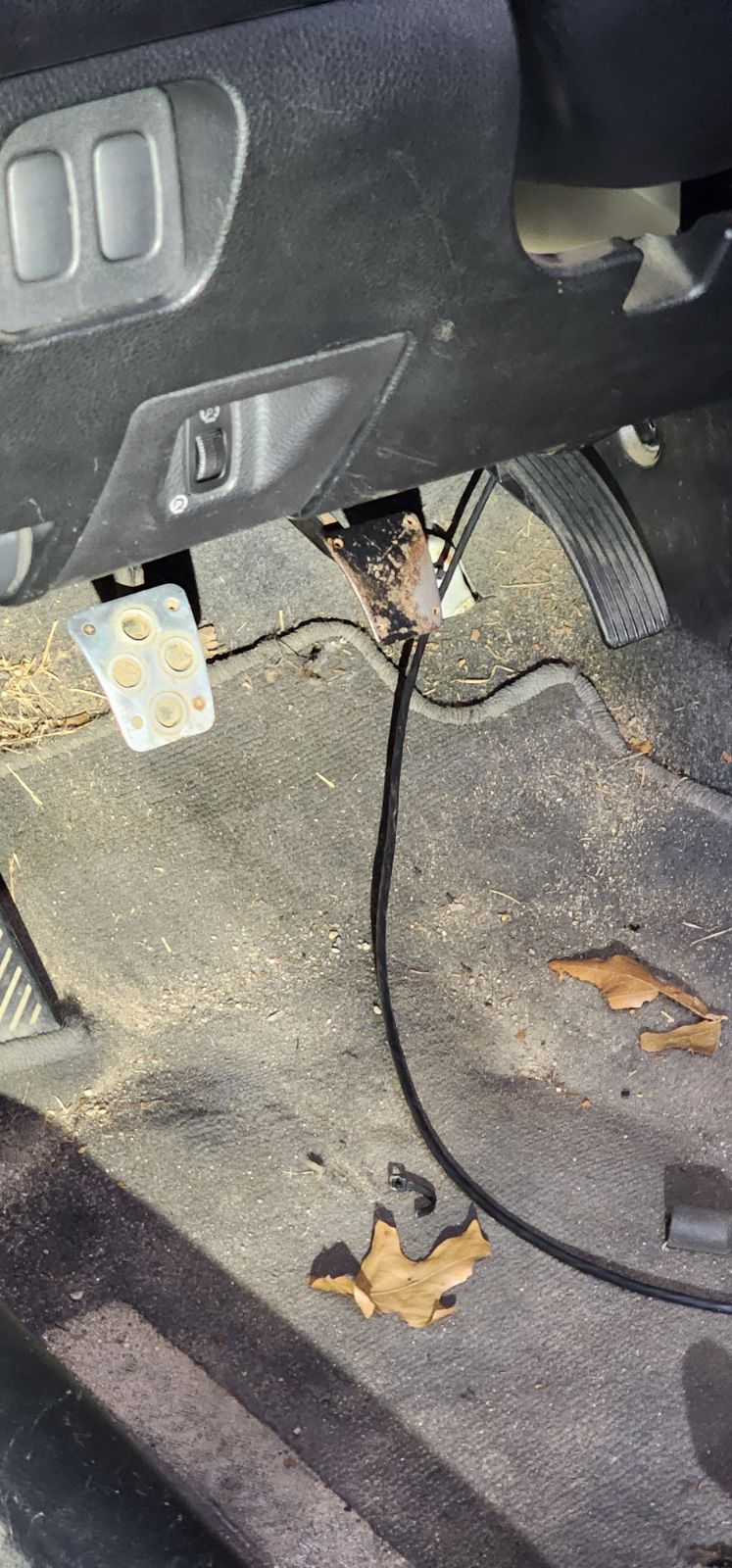

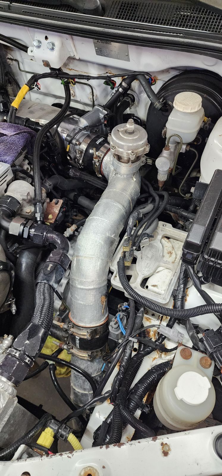

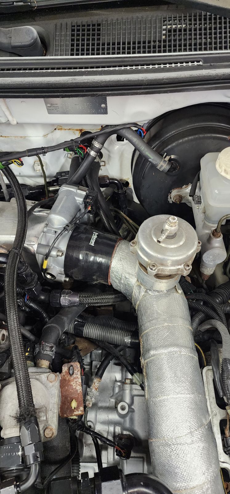

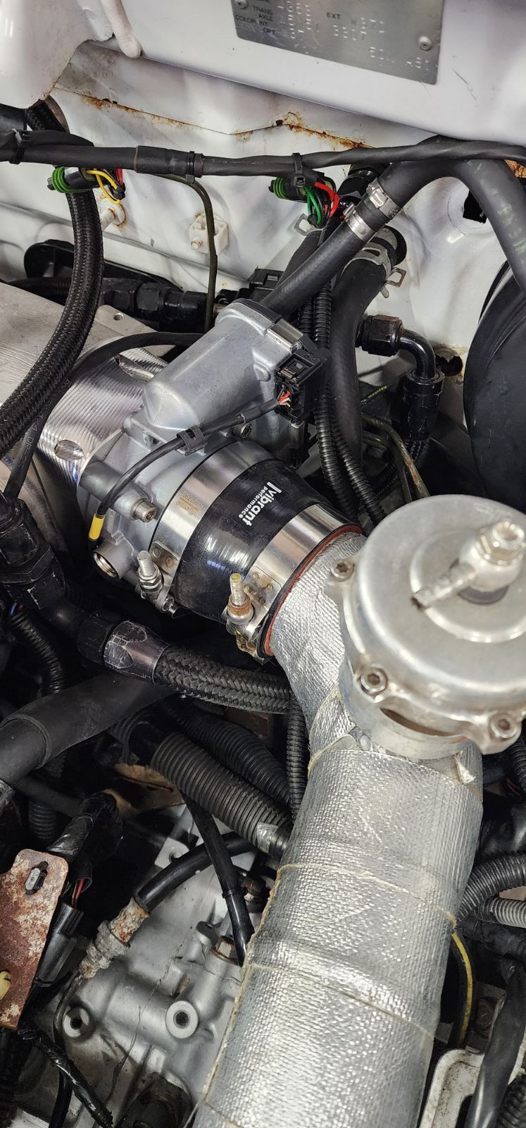

uicp all buttoned up. I kinda wish I would have redone my wrap job on the pipe though while it was off.
Not a fan of having RS pedals and now having to put a stupid looking plastic one in but hey its in and I now have drive by wire.

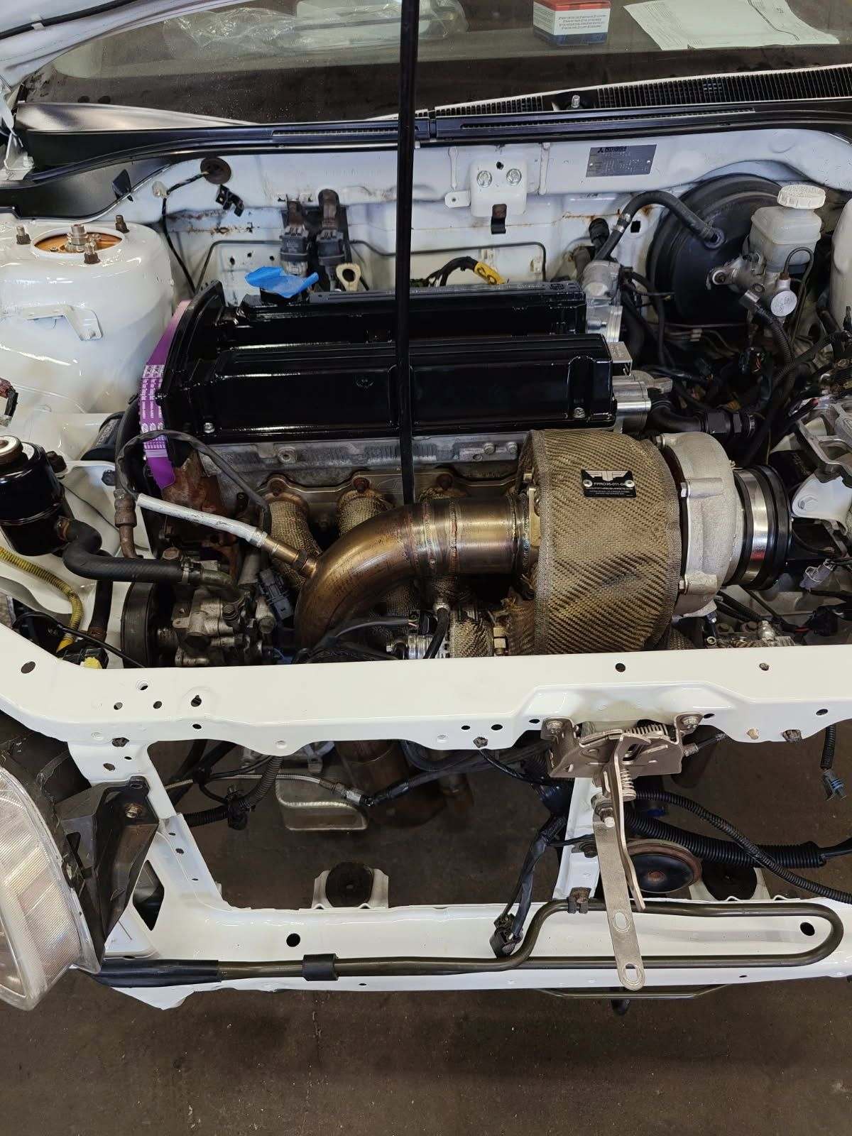

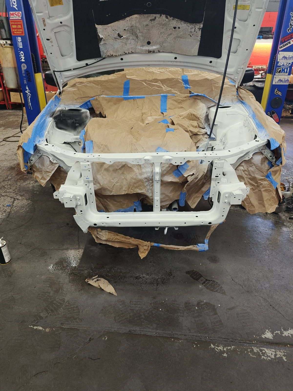

Well a little bit of an update. Yesterday they got my Torque Solutions rear dif mounts on the car and the mustache bar off ready for the Buschur bar. They took car of a lot of rust in some spots and coated it to keep it from spreading or whatever that stuff does. My drive by wire is all in and works. Haltech is all pinned up ready for them to start the car. I am missing something in the front end like my valve cover that I had painted black still. Paint is drying and I am going to go over it one more time to make it look good. I am waiting on some ice blasting to take care of some rust on my core support and around my strut towers. They will be installing my lower control arm bushings in the rear today along with putting my main cross member in the rear back in place and installing the mustache bar. Other little odds and ins I replaced my head light bulbs with GTR lighting low and high beams and boy are they stupid. All the other bulbs were replaced with Diode Dynamic led bulbs as well. So now I wont have to worry about replacing bulbs anymore. I am going to hope that they are going to install my shifter this week as well and get that back together since my center council is currently out of the car. I have been debating on putting in seat lowering things but idk if I would like them or not. Idk how it will put my arm angle with the way my arm was tire up if it will be to high and steep of an angle where it will hurt my arm to shift or not. I need to find a car with a set of them in to see. Other then that still thinking about what kinda tires to put on the rpf 1's. I was going to put a set of slicks on there but idk. I know my calipers still need to be put back together and back on the car so we can do the balancing and 4 corner stuff and set the ride height as well. I have been debating on doing a 3.5 inch down pipe as well, but I wanna see what the back pressure is with this new turbo. I still need to take off the hot parts and coat them but I have to wait till i get the car back to do so. Other then that that is about it for me. Oh one more thing I need to address is my acd. I am looking to try to figure out what I need to rebuild it. Idk if the pump is just bad of if its locked up or maybe the senor is bad idk. I am going to guess pump is bad being the flange between it and the rest of the unit is cracked.

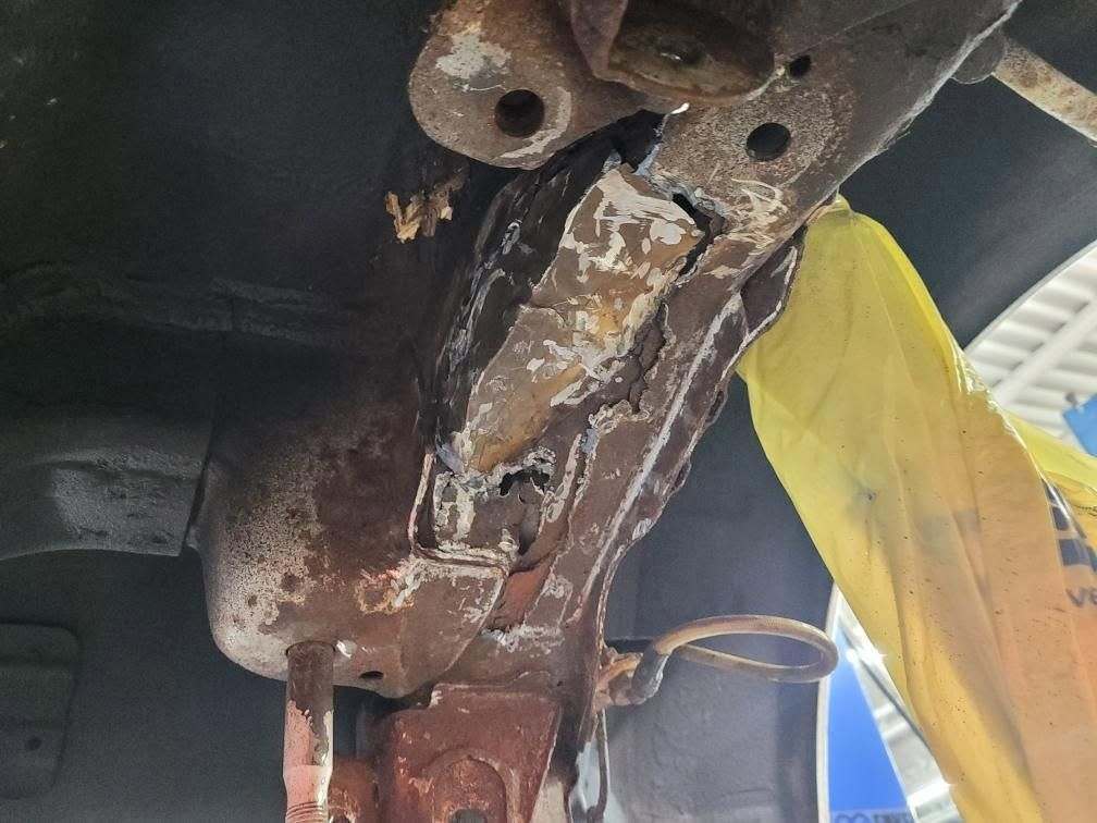

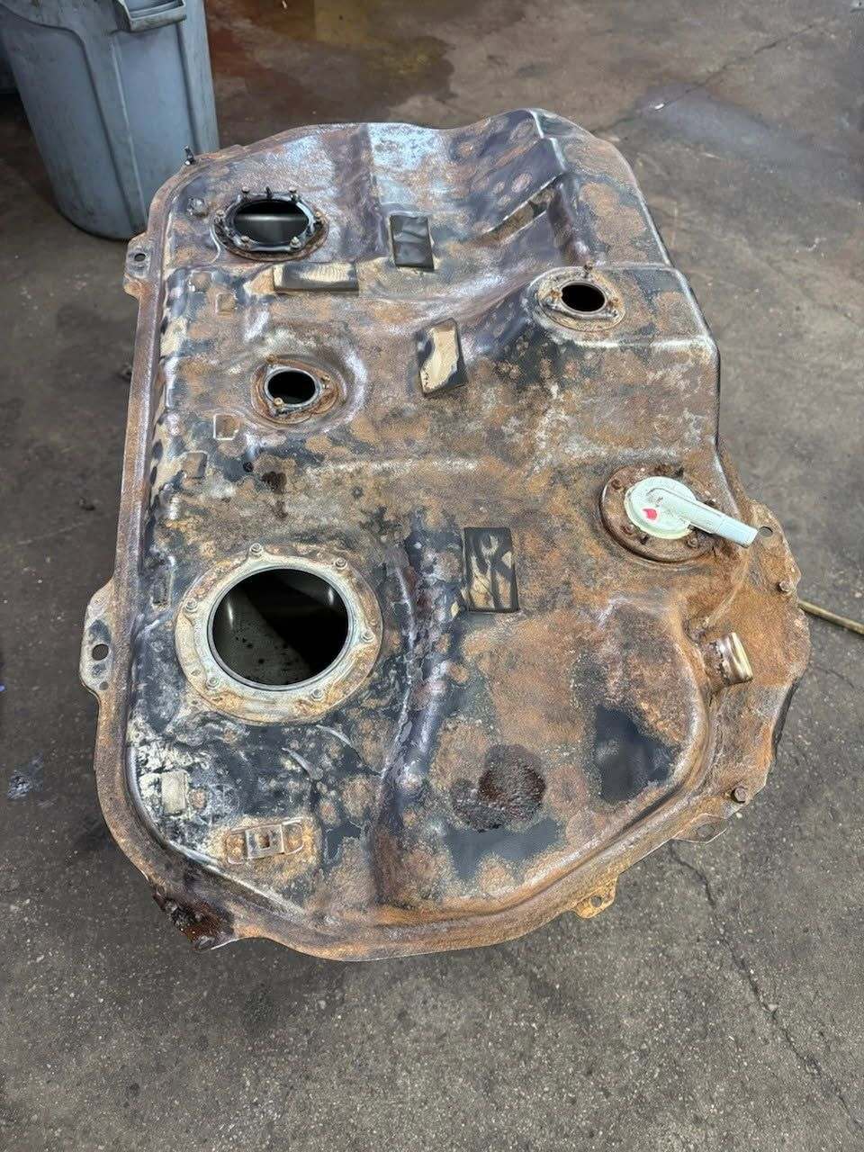

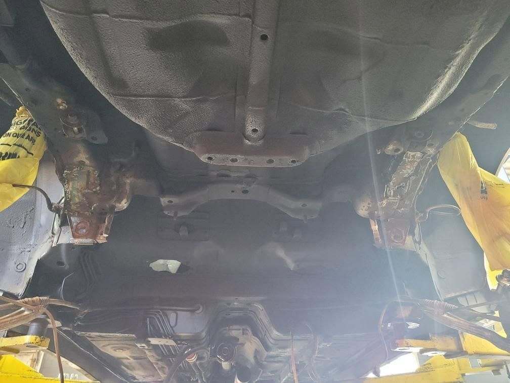

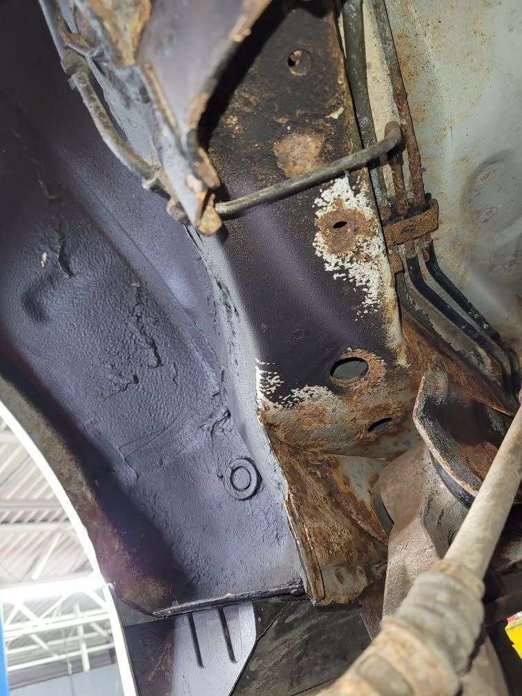

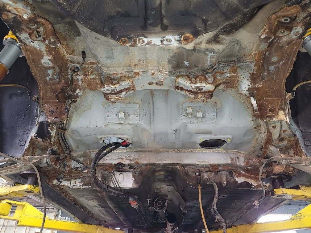

Well it has been a bit since i had any updates. I have some new updates and I will say I am ashamed of what we found. Thankfully it wasn't as bad as it looks and it all had been taken care of.
Thankfully all most of the metal was saveable and just surface rust starting to get nasty. The stuff we couldn't save as you could see in some of the pics were cut and rewelded into place and the whole underside of the car was sprayed with rust inhibitor and then second coating of seal. I will say this added a bunch to my bill but if I didn't do this car wouldn't have made it much longer. car is 100% rust free now and everything will be color matched and corrected. I currently am debating on upgrading my dp to a full 3.5 " but tuner and I have some plans before we do that. My 3" may be enough for this turbo. I know I was way undersized with my 72mm on it. We are going to do a ram air style intake to the turbo which should be interesting. We are also deleting my acd and putting it in the trunk after that gets rebuilt. This will allow me to put a filter in that area and put it towards the turbo as well. Should be fun. Shop owner says hopefully by mid to late April car should be 100% done and tuned, we shall see.
