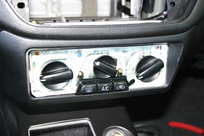

heres a cut i had to make in the metal frame
Old Mar 16, 2004 | 11:57 AM
EVOXTC's Avatar
Joined: Jan 2003
Posts: 125
From: AZ
This is what it looks like (without the front plate).
I had to cut the lip off of the lower piece from the cd changer kit. I also had to grind off the like rivets inside that holds the radio brackets and such.

Ok guys:
Wiring was no problem at all...I temporarily placed in in my glove box while doing work on my dash (not long enough to sit straight in the glove box i don't think).
THe actuators for the mechanical knobs are a little tricky getting plugged back in from their new location but the factory ones works just fine (ill get a pic if you guys want to see that). To hold the unit in there are screws that do it (will get a pic for you).
Just a little background: I moved this down because i have a 7 inch touchscreen in place where my radio and a/c control used to be. I will be doing a post on my finished project in a little bit (Computer install for gps, mp3, radio, phone, and dvd stuff)
