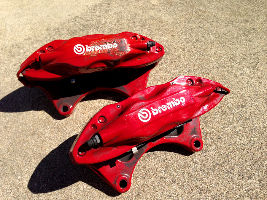

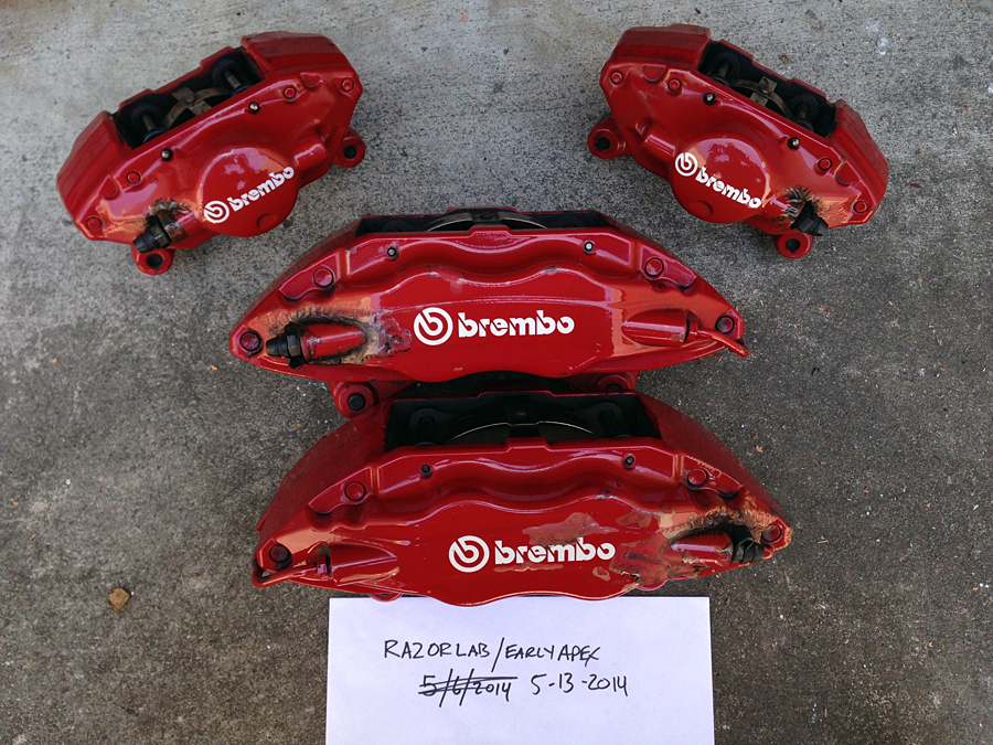

The calipers are actually exactly the same save for the mounting points (larger diameter bolts and spaced for larger rotors). I used to think the actual caliper design was better until my friend who's a powdercoater literally showed me the pistons and seals are interchangeable. Thats not to say you can't benefit from a larger rotor with mechanical braking advantage and thermal dissipation advantages.
The fronts you drill out the hub's mounting points to M14 if I remember correctly and get rid of the stock dust shield. The rears I don't think anyone has bothered because of the e-brake differences.
Like the rotors, the calipers are physically larger on the 10. I had an extra set of each that I ended up selling. I've had both in my hands and side by side and they are physically larger than the 8 and 9. If I still had the two sets I would measure them. However like I said, the pads are the same size (and part number). I never actually compared the pistons but I'd believe you if you told me they where the same size, given the pad size sharing.
Would be interesting to see if the the physically larger Evo 10 caliper was stiffer than the Evo 8/9 because of the size. I'm not a brake engineer so I wouldn't even begin to venture how you would test that.
We are saying the same thing about the caliper mount sizes and reboring. You just added more detail.
Evo 8/9 brembos:
Evo 10 brembos:

You are correct sir the caliper casting is slightly larger and appears to be larger because of the thicker 'ears' where the caliper mounts to the hub. The piston size is the same with the same spacing and pad.
The advantage for me was 1" larger rotor size that puts you at something like 345 or 350mm that's pretty decent for an OEM package and that's used to stopping a heavier car overall. The rears are a little too hard to convert the spacing is different on the mounting area and the parking brake setup is different as well.
I had figured this was a "cheap" way to see if I could improve braking and not be forced into very aggressive pads that are hard on $$$ and the rotors (not that they don't work don't get me wrong) but my autozone pads are doing quite well with the larger braking leverage and I honestly cant complain to have a 350mm braking package for basically 200.00 lol.
Then I noticed a thread on here with the SCCA TT2 cars being able to use them so I was like well golly I will too....
Evo 8/9 brembos:
Evo 10 brembos:
