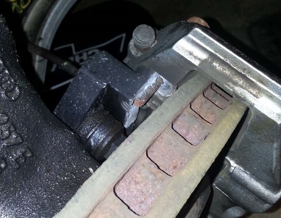

Believe what you want to. Proof is in the pictures. Aluminum caliper brackets are much more prone to failure (lower tensile stress than steel, easy to overtighten) and anodizing goes from black to purple when stuff gets hot over and over and over again.

Thanks for sharing is that a stasis caliper? Or the mono6 series?

Stasis never made a caliper, they bought them from Alcon. That cracked aluminum bracket is either STaSIS or SPM... Alcon and AlconKits make them from steel...
