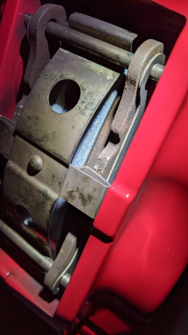

Pads zorched.
You can run them and deal with it, or replace. Depends if you can heel-toe with however deep the brake pedal goes.

got new ones waiting in the wings. what caused that? i thought these can take anything throw at them, and i'm really not that hard on them..

After actually driving on the road with the street pads, I can definitely feel the brakes biting earlier, but they still feel like mush for the top portion.
Drove the car to work this morning, and after I parked, I took a video of what I mean:
Is this normal, or abnormal?
May just go ahead and rebuild the calipers here I guess
