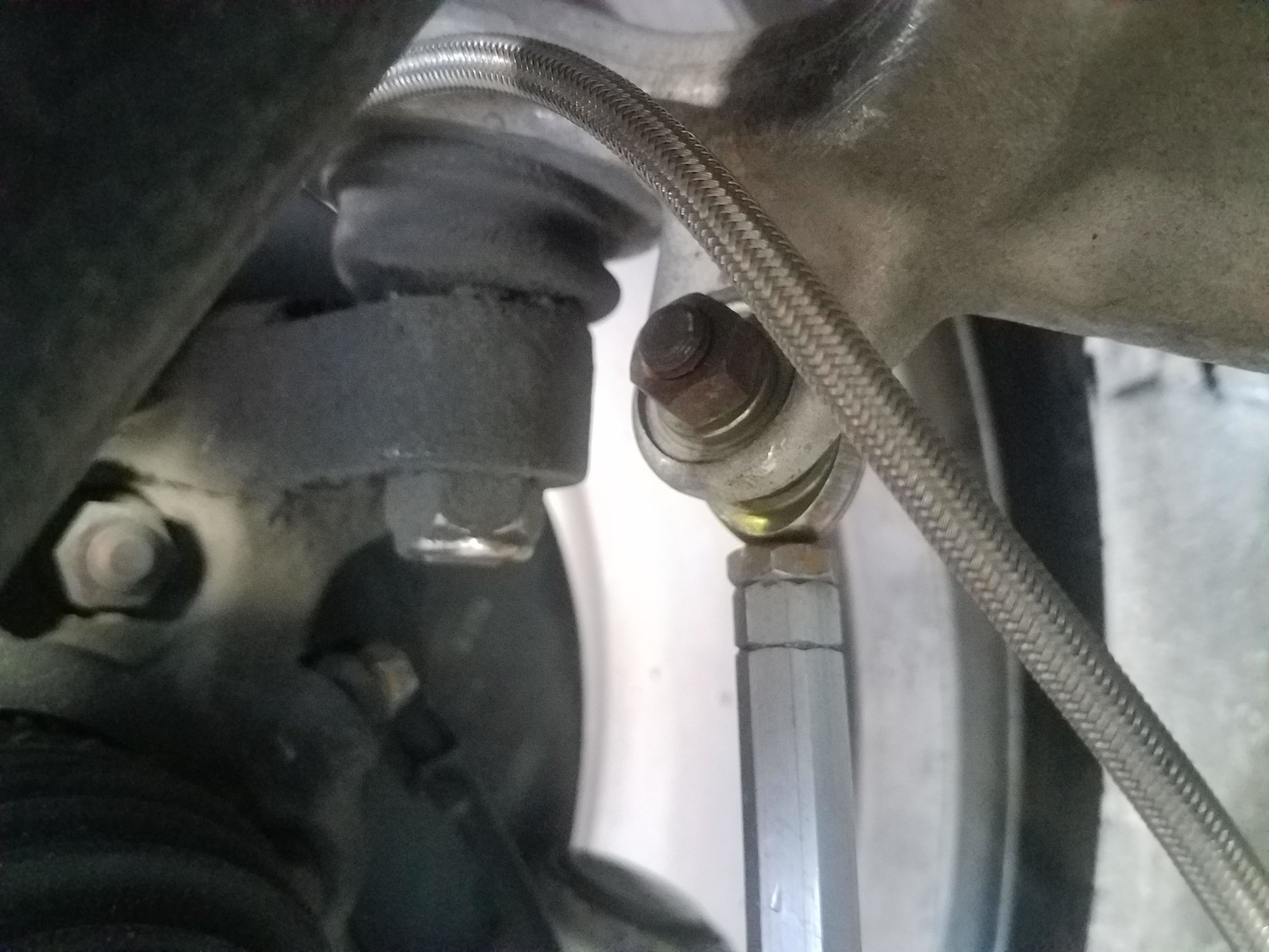

I did use lock washers. Also, my bolts seem to fit. Not sure if I measured my own or used the how-to to pick sizes.

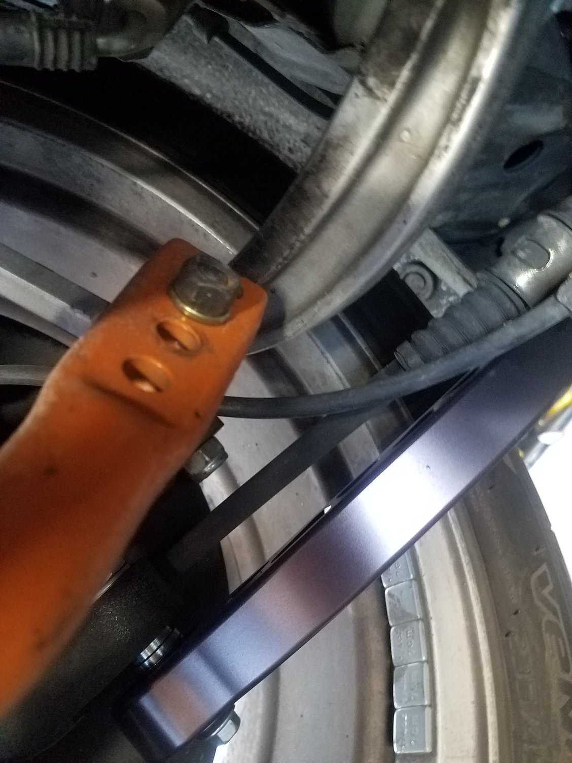

did you do the fronts too? I've been working on it but it seems like the ball joint barely has the articulation that the WL one did..

I did the fronts, yep. They lined up no problem. I haven't noticed any problems with operation, though. I'm on a stock sway bar, if that makes a difference.

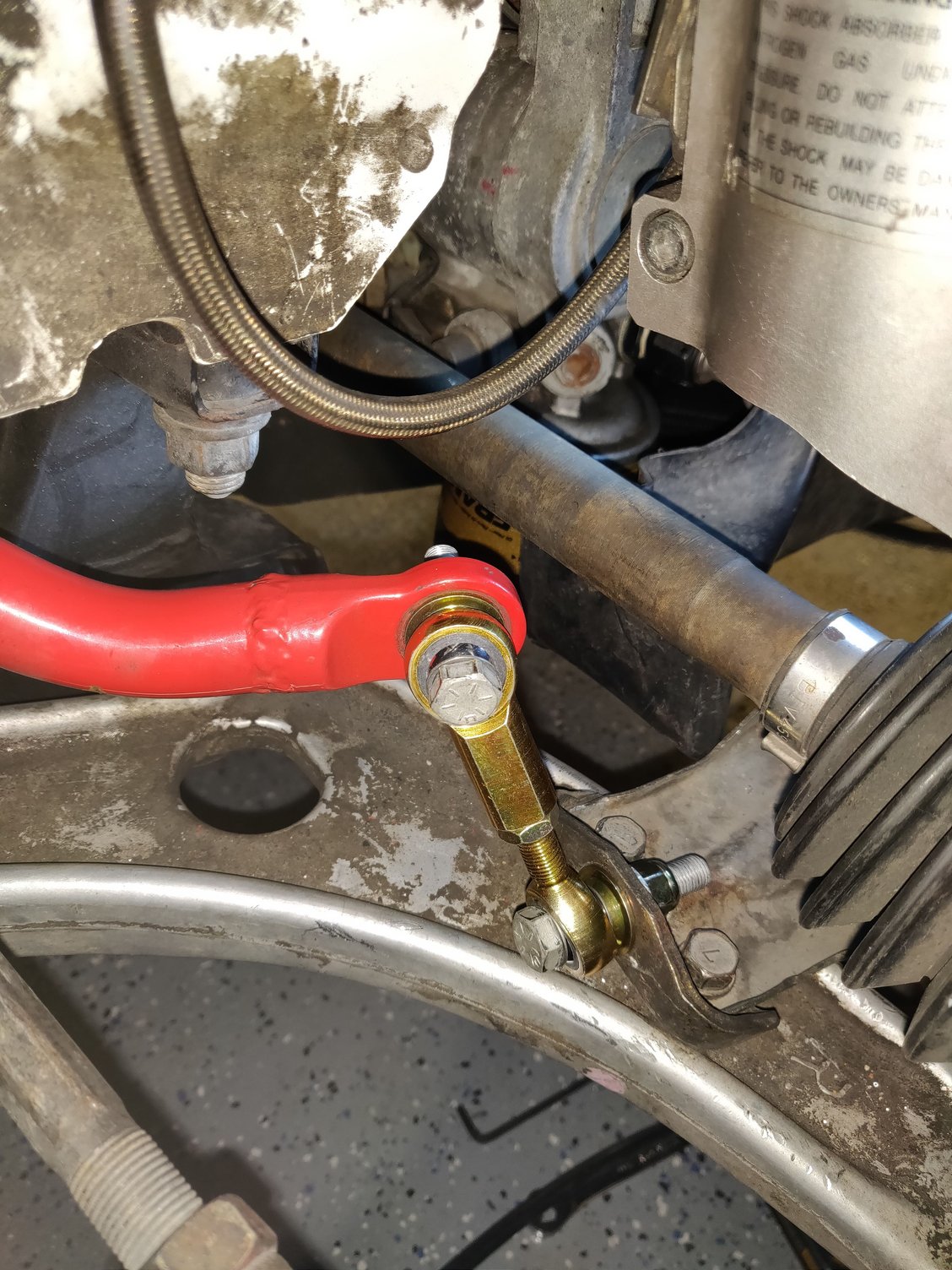

almost feel like the part number/part changed.. just seems off in the front

Yours is threaded out more than mine for some reason. Mine is all they way down. Luckily it didn't need to go in any more. Are you thinking the angle coming off the bolt is too steep?

yeah and the angle isn't quite right it's like i need the top of the end link to be further back. double checked the part number should be right
